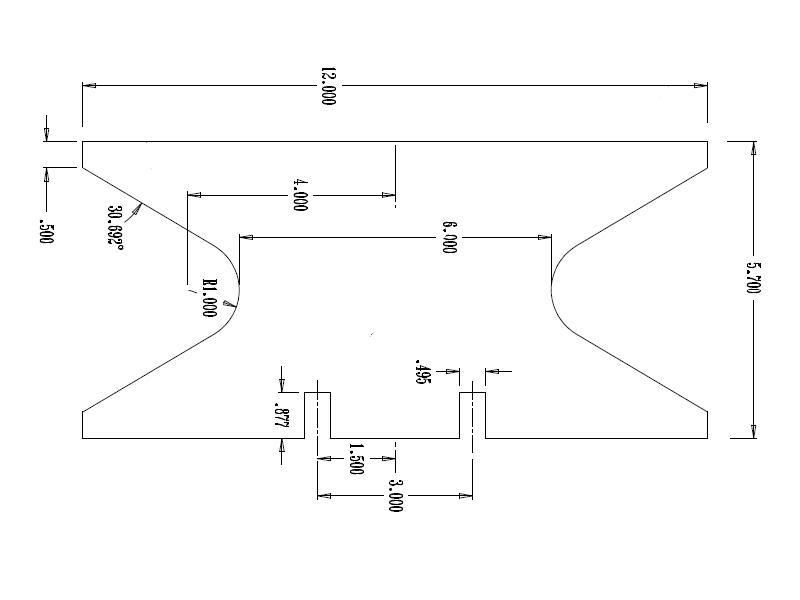

After using the grapple to move some rocks around, I thought of a way to protect a short section of the exposed hydraulic cylinder rod. My idea for a small protective plate under the cylinder is sort of like this:
Yesterday I asked Rob to take a look at it. That afternoon he drew this up and sent me the CAD file:
I'll take Rob's CAD file to the plasma cutter and have it made. Thank you Rob !
One last thing I would have done a little different, that would be to make the 1/4" plate between the front jaw tips out of diamond plate, instead of smooth flat plate.
Diamond plate here would be more appealing:
Not structurally necessary, It would add more style to an already perfect grapple (IMHO).
Larry

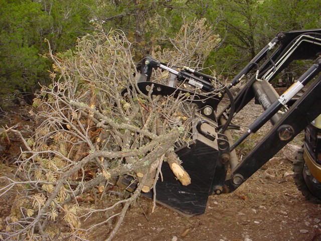

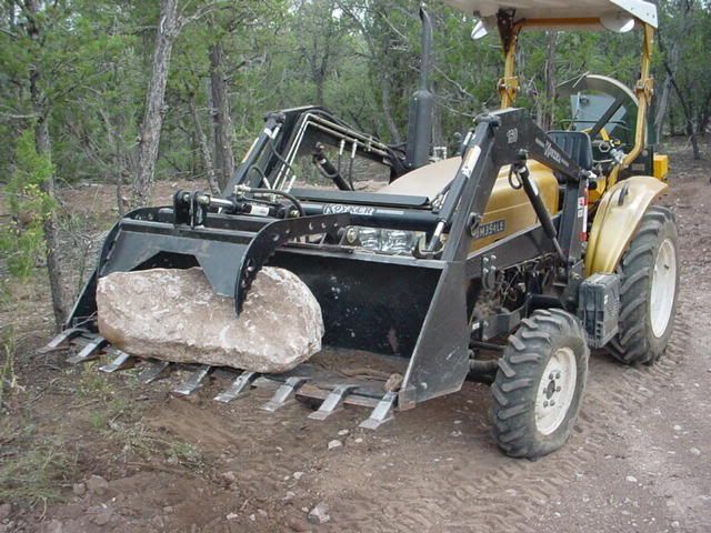

Finally, here are some action shots of the grapple in use. I took these pictures today between 6:57 pm & 7:24 pm Mountain Time, so they are as close to Real Time as possible ;)
This last one is of a tree Rob pushed over with my Dozer. He got carried away and pushed it deep into the woods, he just kept going & going :rolleyes: . So I retrieved it to be cut up for firewood.
Larry
