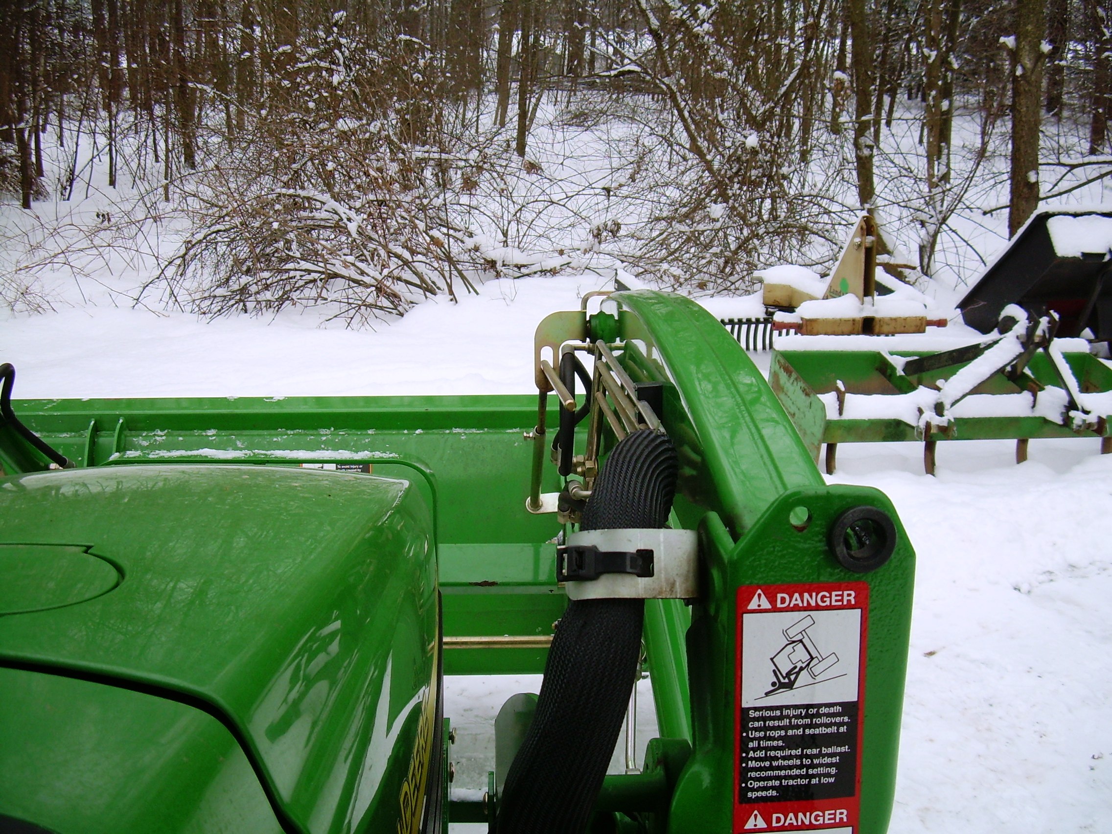

Wax man that is what I am going to do to my loader, great job and When I work in the brush I think your design will hold up. Imitation is the greatest form of flattery.
Thanks Guys,
Well if I was going to make one again I would do two things different.
1) And most important Use a stainless steel rod so it matches the piston of the cylinder (shinny) and won't rust.
2) instead of cutting the marks where the white paint is , I would leave that high so that too would be polished stainless steel as the mark instead of white paint. I would just cut down the black area.
The reason I cut it down is so the paint won't wear off. I repainted the orange a while ago and wiped some of the black indicator off cleaning up the (not stainless steel) rod at that time and never got around to fixing it until today.
So if your going to make one , Don't make the same mistakes as I did.
I still would like 3 pilot lights in the cab instead. But I don't think I would want to drill three of those sensors in a row on the fel arm.

The bent rod may drop in but you still have to fumble forward or back to make sure it's all the way at the bend, same amount of work with the painted line. I think the line is easer to see when you're on the mark then the bent rod. Plus it's seems that it would be harder to tip the bucket up or down a little off level, once out of the bend. Do you eyeball gauge 1/2 inch in/ out of the bend? I also think the straight tube has less of a stick and brush grabber without that long skinny unprotected rod flapping around. That is why I made the straight rod instead of the bent rod set up.
But this is all just my opinion and not fact. JD engineering must agree only because it's the cheapest way they found to do it, which is far better then Kubota's cheapest way, the bent piece of metal on the bucket.
Whether you have a red light, straight rod , bent rod or just using the top of the bucket, at the time of "hitting the mark" there is the same amount of finesse to hit the mark, pro non pro etc. Some people get great at hitting the bend, some at hitting the painted line, some at eyeballing the bucket.
Lets think of the guy that doesn't have a tractor and uses a shovel.
Either way we have it pretty dam easy.

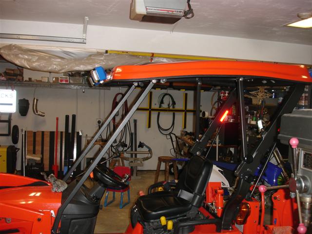

/ FEL level indicator
#28
Wax, If I had done the rod method I would have done it exactly like yours with a stainless indicator (I have pounds of stainless on the BX from all my mods - every single bolt) - you have the most sano ("qualitay" as my teen son would say) set up I've seen yet.
In order for my light set up to register correctly, I have to dump the bucket past parallel (as in dumping a load) and then bring it up; the second the light comes on the bucket will be exactly parallel with the front and back wheels when the arms are dropped.
As others have pointed out, more quality seat time might eliminate the need for the indicator but tonight when I go out to get rid of the 10" we've gotten today so far (still dumpin) and my bucket top is covered in snow making it hard to visually register it, most of my gravel drive and lawn will still be intact when I'm done.
Dave

/ FEL level indicator #29
Dave
Dave

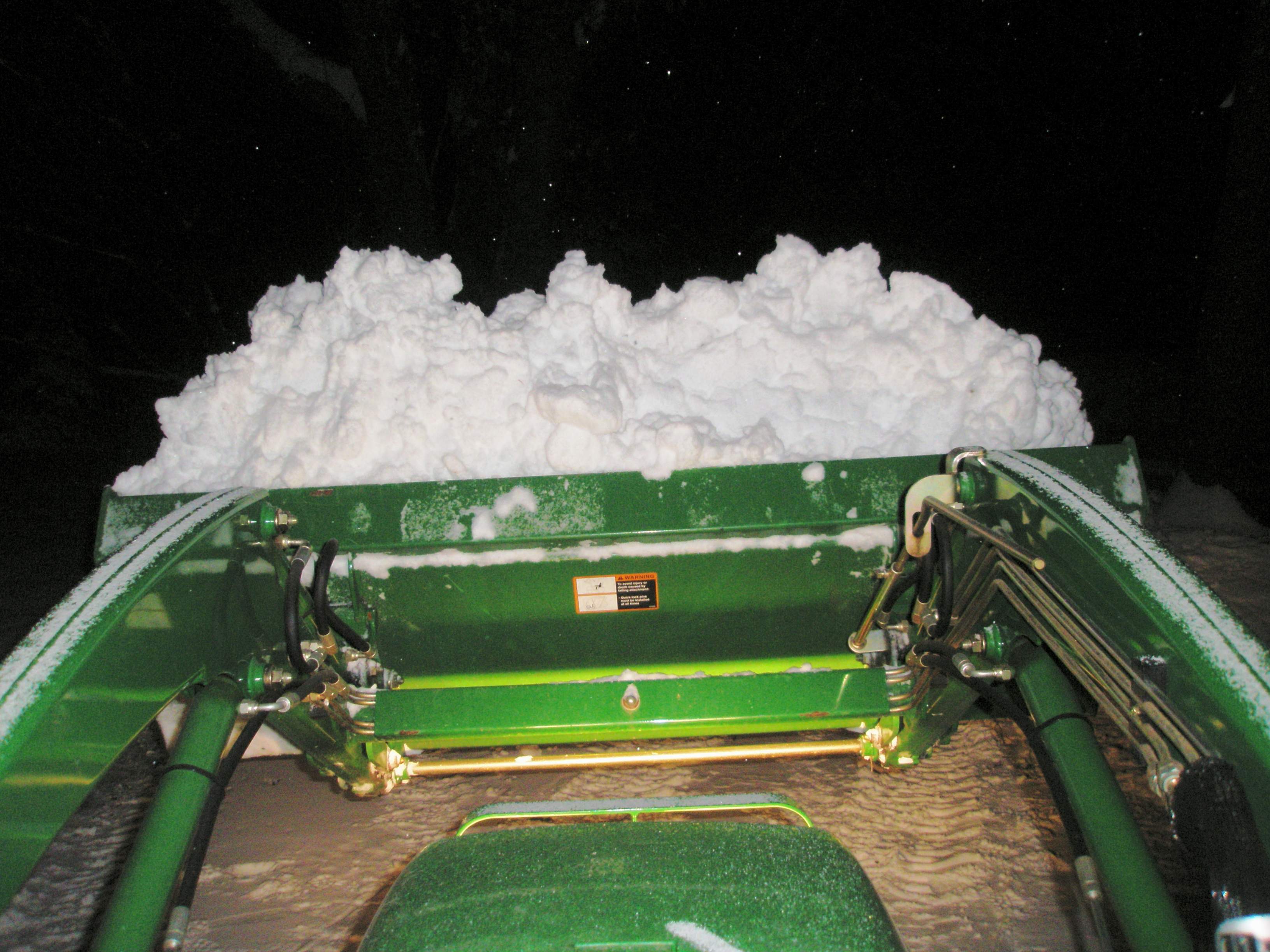

I wonder if that is you in the picture? So that's how you come up with these crazy new ideas, :D
Good point with the bucket top full of snow.

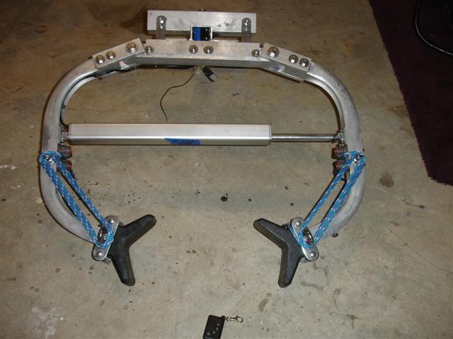

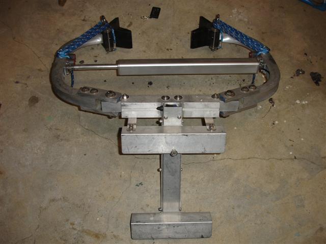

A little off subject but here is another one of my projects.
My outrigger legs would drop after a few days on my woods backhoe. I didn't want to use a chain or bungee cord to keep them up.
So I center drilled and tapped the lower piston pin and drilled and tapped the outrigger leg. I used 1/2 inch stainless steel bolts which I machined the heads to minimize it from sticking out.
It's spring loaded to stay in place either in use or not. They work very well.

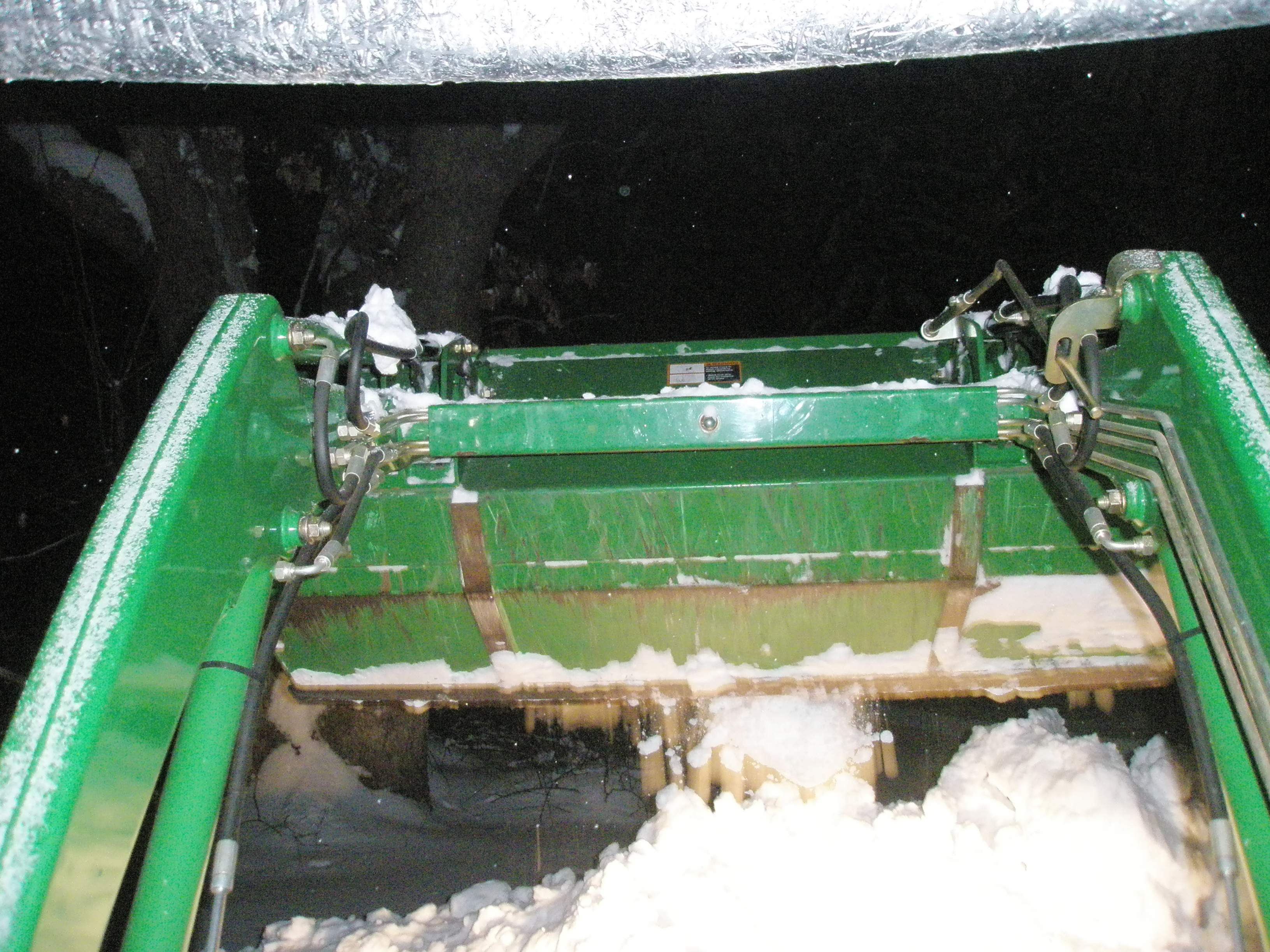

/ FEL level indicator #30
WaxMan,
You forced me to observe my indicator closely today while out moving snow, I will not argue which is better, I think yours looks excellent, I didn't realize you did yours from scratch, thought you just painted lines on original equipment, not familiar with kubota but assumed all manufacturers had some type of straight rod and tube like my older JD loader.
It's interesting, I never thought much about how/why mine's so easy. Reason being its more like it's an intuitive interaction, don't know how to describe it better, what happens is the rod actually moves in a different direction as it passes that crook in the rod, not 90 degrees different but enough to make it difficult not to notice when the bucket reaches level. Yes you can go past level and have to go back a bit like you mentioned.
BTW, I like the stabilizer locks, I"ve got a rope holding mine together while it sits stored.
The more I think about this I do believe an led indicator is probably going to be the way of the future for bucket level indicators.
Don't know that I agree with the idea that an indicator is not necessary for experienced operators, I wouldn't want to be with out one.
Dave, I hope that ski jump picture is a photoshop job!!!
jimmer, a couple of pics you asked for.
Keep up the good work all,
JB.

Waxman,
No problem on the off topic - you've obviously earned the right as those clips are "Clean!" (trust the springs are 316 also . . .) I'll see your hijack and raise the following;
Center bored and tapped two 1/2" and two 5/8" stainless bolt stubs to accept the four stock ROP 8mm locking knobs in order to replace the stock 5/8 ROP pins and for two 1/2" pins for the braces on my canopy. Even the cobalt bits had a hard time & had to resharpen a couple times. Would give a left nut for some of the nice milling equip. I've seen on this site.

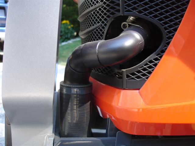

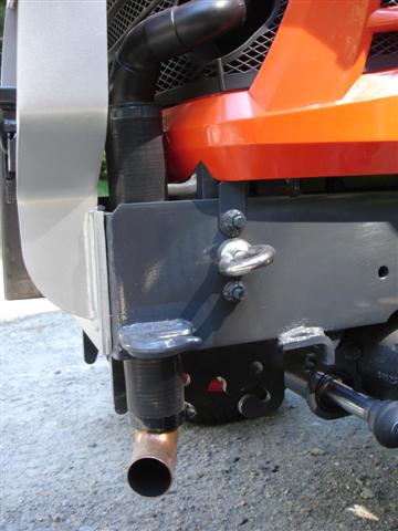

Well nice pins you made there.
I'll see your pins and raise you my stack.
I didn't like the black soot and the exhaust smell in front of my tractor so my very first project was a stack pipe. I wanted it to look factory and follow the cab and blend in with it. It's attached with rubber two isolators at the cab one of the fel bolts and the original clamp at the muffler on and off in one piece in 2 mins works great and sounds great too.
I have since updated the end to blow off to the side instead of up.

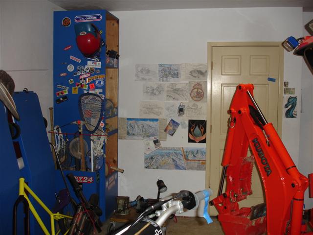

In my dreams Wax,
This is a simple 2 bay garage with a couple hand tools (should have done the three bay when we built, but we were young and foolish (and poor) back then. Pics tonight . . .
