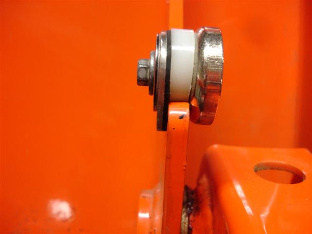

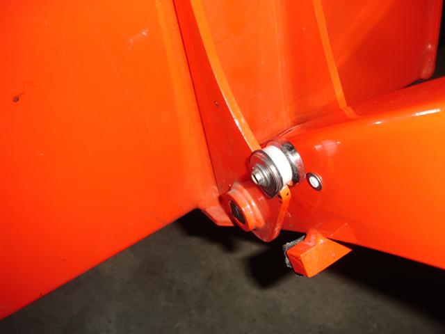

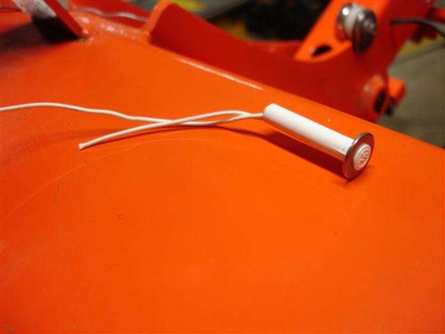

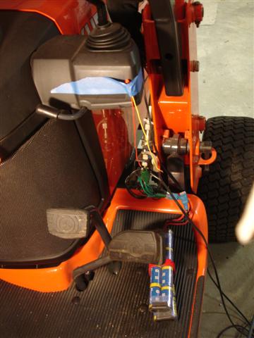

Wanted a lever indicator for the bucket, but not a bolt on rod type. After a bit of head scratching, a couple coors lights, and digging through some old parts boxes, this is what I've come up with:
The sensor in the arm is a magnetic reed switch. The magnet is bolted to a carved up stainless washer. Both will be painted orange when I get a chance. The set up is very accurate and adjustable via the magnet/washer clamp, and is not affected by snow or dirt. The magnet is neodymium and scary powerful. The switch operates a high power red LED mounted on the plastic shroud at the base of the FEL stick (TBD- mocked up in the picture) and can be seen out of the corner of your eye even when not looking directly at it. Switch wire was routed inside the FEL arm, out, and then bundled with the hydraulic hoses. LED goes red the second the bucket is level - you can set level with the arms on the way down, or without hanging off the side of the tractor or in the dark during a complete white out in a blizzard with your eyes almost frozen shut.

Unfortunately, it will only give bucket level at one arm height. Raise the arms and the bucket will read level, but will be tipped back significantly.

John you are correct. I worded the post title incorrectly. It is technically a wheel plane indicator for the bucket bottom, and of course is calibrated to indicate only that when the bucket is down for snow removal (we have a gravel drive). It is possible to indicate "level" with a different system but that would be beyond my needs and is a more involved project. Mercury switches and pendulums bounce around and would give erratic result, though would give an indication if the tractor was motionless. A linkage anchored at the FEL arm mount articulating the magnet would allow the bucket to be raised and the "wheel plane" could be determined at any height. Not true level of course. 2 more green LEDs on either side of the red existing and 2 more reed switches would also indicate if you were off - tilted up, or down.
This was a fun, simple (and cheap) project that anyone can do. Veteran operators would find it useless I suppose, but last year during a couple of bad storms at night I wacked the driveway and the lawn in a bunch of spots pretty good. Will no doubt do it again this year too, but maybe less times.
