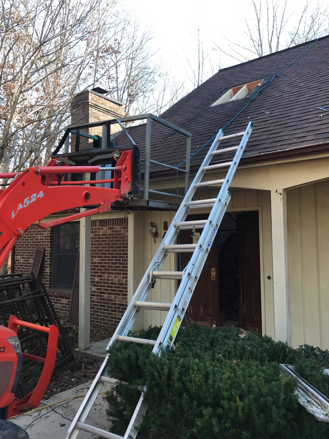

Safety vs. using a ladder to work off of: Not even close.
Pics tell the story:
$25, IBC container with container removed and 1 minute with a sawzall:
You still have to use a ladder, but at least you have something to grab onto while going up and down. Note the 2x4 vertical support. Usually I use a 4x4 but it didn't fit in this situation. Being able to either support the platform or lock the cylinders is important and this is where most of the safety ****'s go nuts on.
Note the tool box; that way you can bring all of your supplies and tools and it's very handily available and totally safe. No dragging crap up and down ladders. Also note the anti-skid rubber mat; reduces the chance of slipping or tripping. Even if you do, the cage protects you falling off the platform.
The only real downside to using a work platform off a tractor is if you can't get a tractor where you need to work (inside a building, a roof over a patio etc.)
I hope this helps!

FTG - that is really cool. Is that one of those liquid container cages?

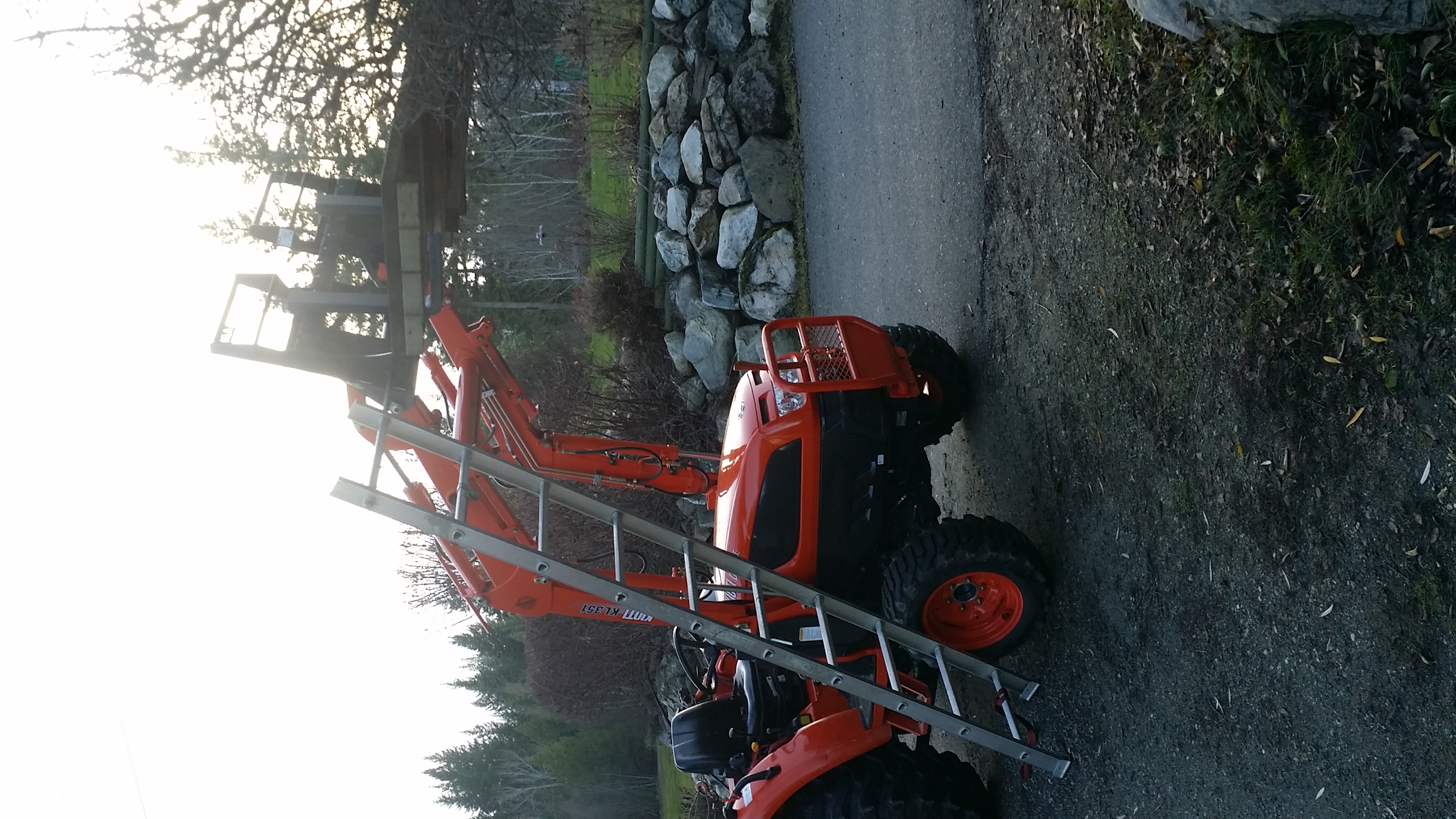

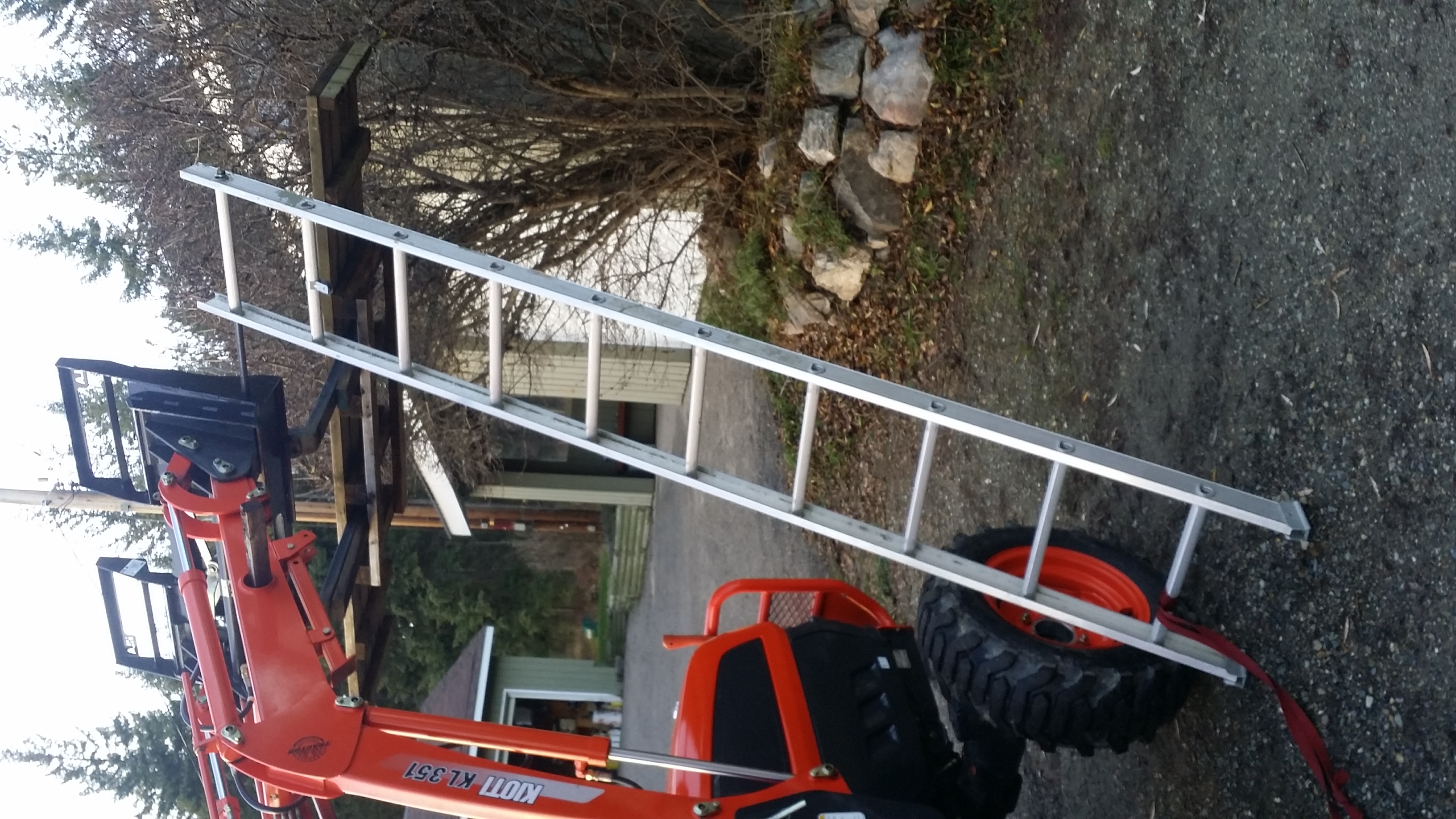

I drilled holes through the forks webbing to run a round bar to support the ladder through the top rung. I lift the end of the ladder with a sling when changing positions. The bar extends through either side of the forks and I keep in in the forks when not in use.
