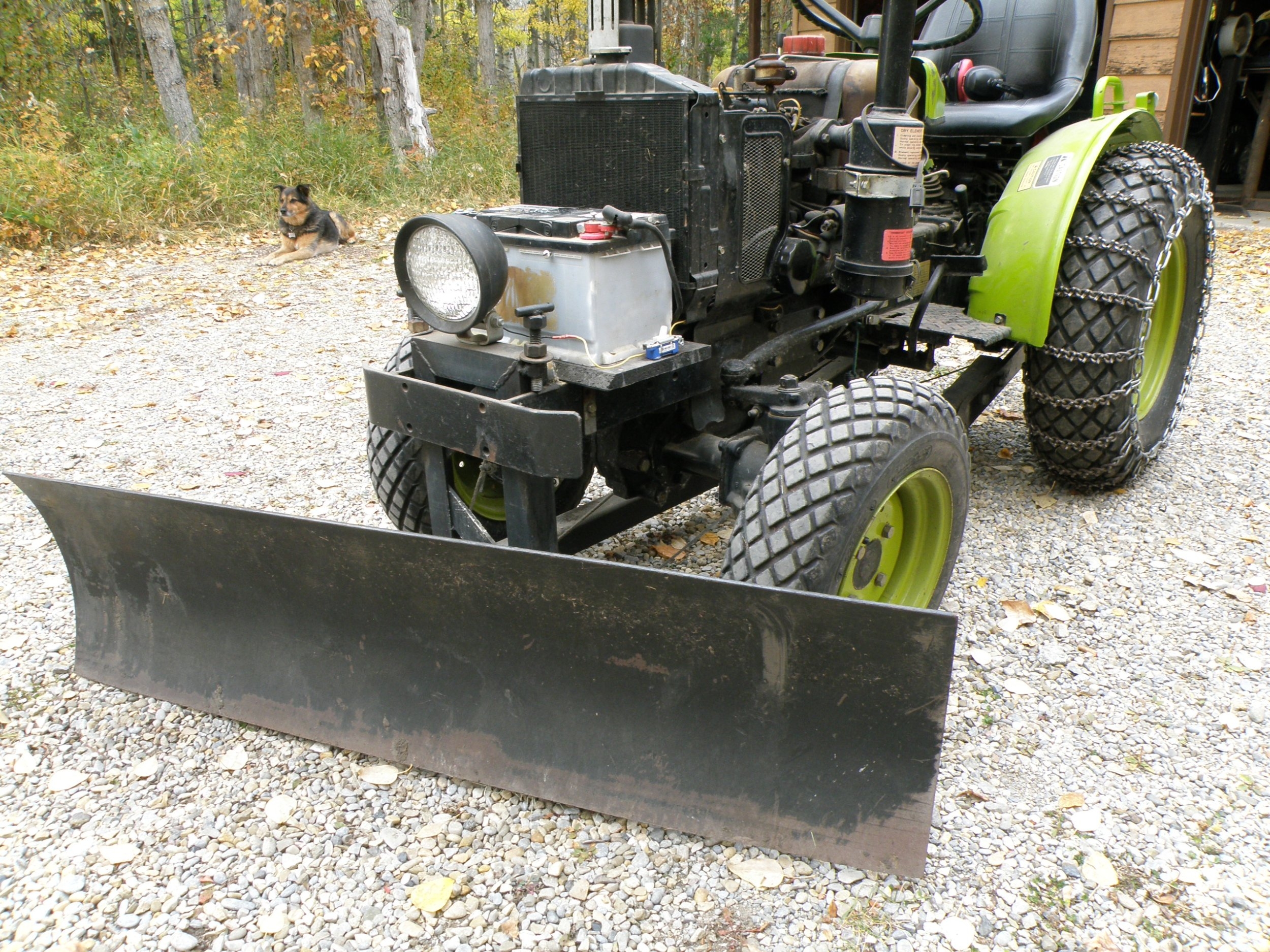

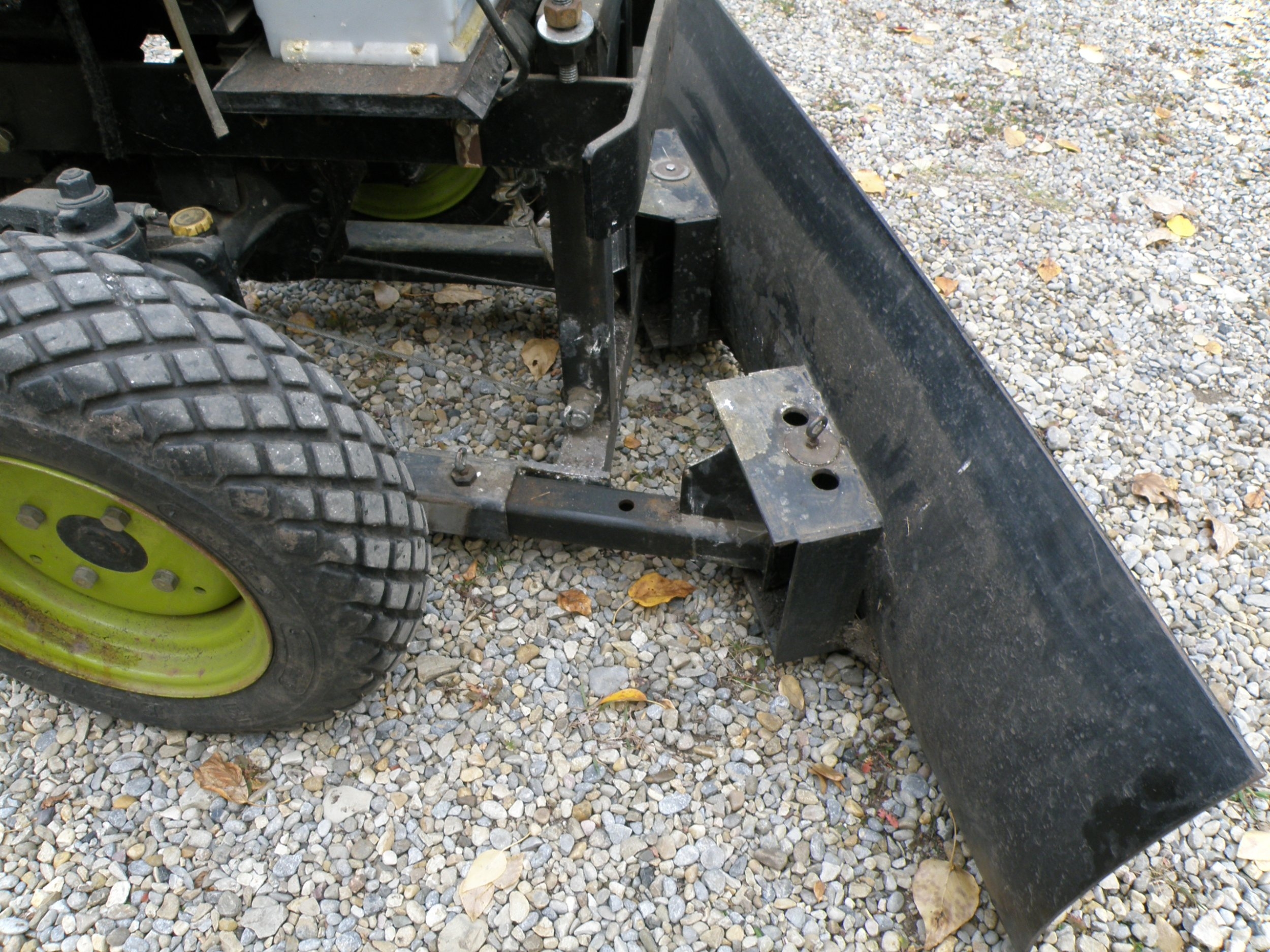

That is the setup I fabbed for my Yanmar 155D after getting tired of dragging around a rear blade on my gravel driveway. I found the front mount blade to be far superior, at least for my small tractor. I added an adjustable downstop to keep the blade a small set distance above the surface to avoid plowing the gravel.

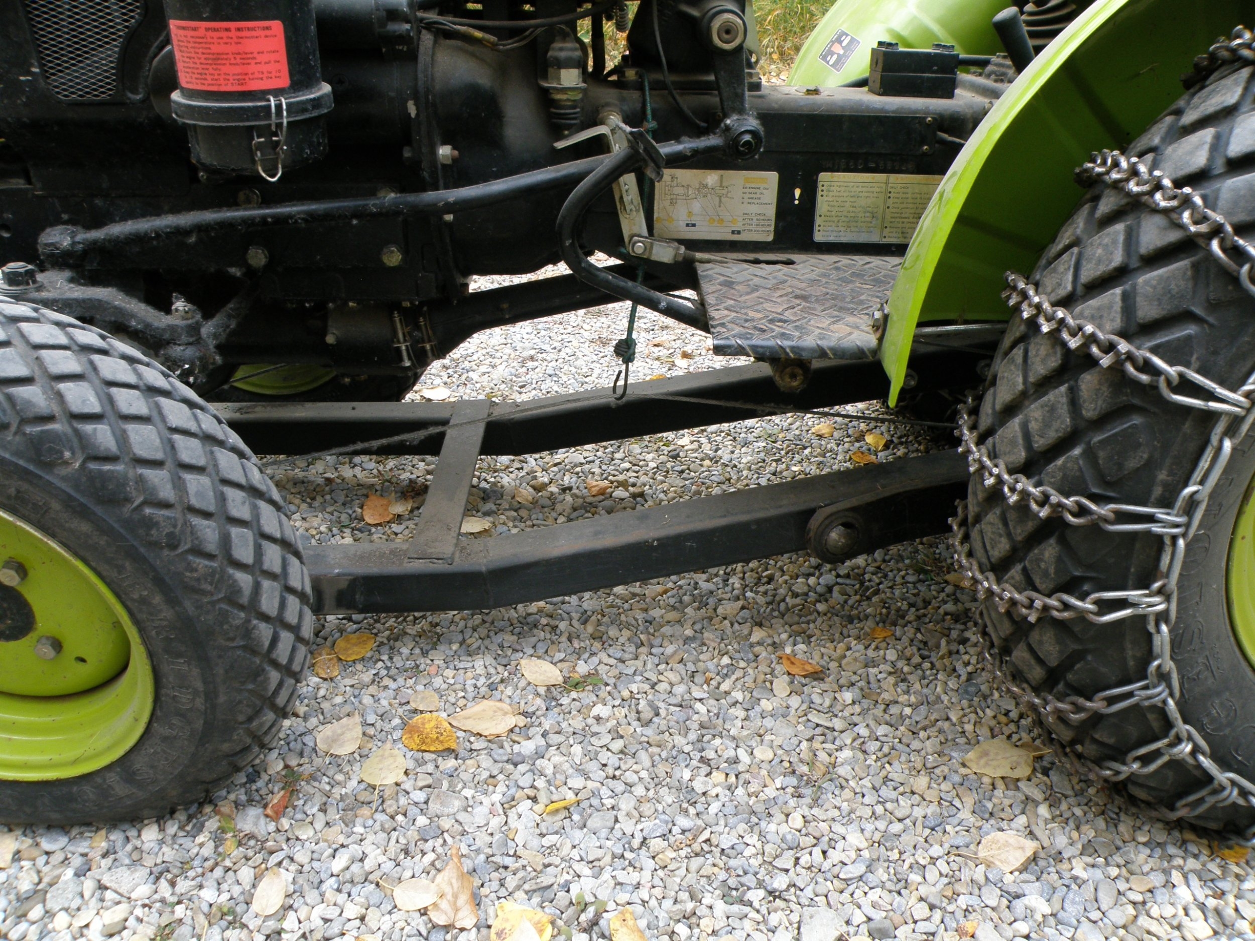

My setup may vary a little from yours in that I have the mount bolted to the lower 3pt hitch links (with the links pointing to the front instead of rear). The lift/lower cables run through two pulleys per side, front and back, and are connected to the 3pt lift arms.
Cost was about $100 for a four ft blade pressed from 1/4" sheet steel plus a little for some square tubing for the mount etc. I can manually adjust it for a zero or 30 degree angle. I kept the blade as close to the front wheels as possible to minimize side-push rotation and to minimize variation in blade distance from the surface.
If I were doing it again, I would probably eliminate the angle adjustment, and leave it at 30 degrees, as that's about all I require for snow removal.
Post a couple pics.

My small tractor is a 15 hp Yanmar with a loader. I made my 6 foot front plow and tied it back to the loader frame. I used the loader and a chain to lift the blade. Manual angle that stayed at 30 degrees as well. Worked well. Only had problems with more than 6” of wet snow. Chains an all wheels. If the snow was really deep, I would have to turn off to the right to unload my blade, back up and start again. The 36 hp tractor with an 8 foot blade just works. One pass down and a finish pass back and I am just left with the parking areas
   / FEL plow vs. rear blade for 1 mile of infrequent chipseal road snow removal #104
Do you think now that a 6 ft blade was maybe a bit wide for that tractor size? I can handle considerable more than 6" w/o front chains although I have some pretty heavy weights on the rear wheels (I encased scrap 8" iron pipe flanges in concrete and bolted them to the inside of the wheels - they weight about 120 lbs apiece).
Is your Yanmar a hard cold weather starter? I am trying 5-40 synthetic now (used 10-30 standard oil before) which makes a considerable difference in crank speed. I also have an oversize battery which is visible in the images I posted. I also built a removable styrofoam box to surround the engine with a hole in top to insert a heat gun - leaving it on high for 20 or 30 minutes works a lot better than the old strap on block heater.
