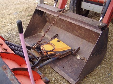

I've mounted many Meyers Jeep size plows in Kubota buckets and on SSQA plates They work great as long as you let the plow float with a chain top link! 3rd function for power angle and remove two pins to use the bucket to finish of f==f the piles at the end!

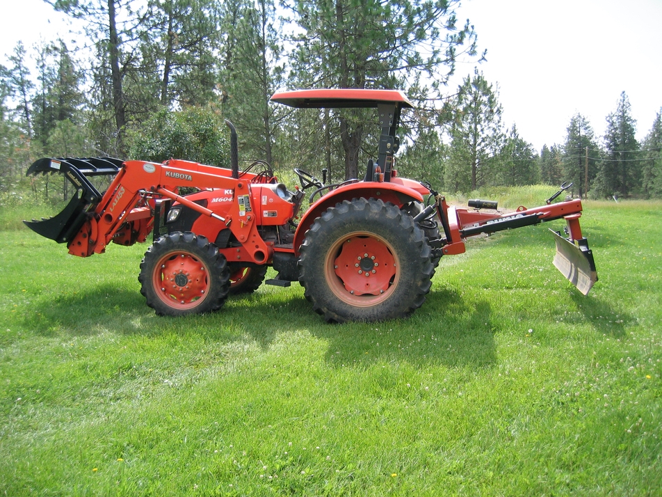

I have a mile long gravel driveway. For the first 27 years I had a Ford 1700 with a rear blade. On rare occasions I'd wait too long - the snow would get too deep - the rear blade would tend to push the rear of the tractor around.
At least four hours to clear the driveway and mailbox area. Another hour or so to clear the yard.
My neck and shoulders would take two or three days to "heal" after using the blower.
This is my snow machine..........
No wonder it takes you so long. Im guessing by using that grapple for moving snow, it’s probably as useful as it would be to move sand or liquid water. Ha!
That’s a heck of a blade though. What length is that one? And do you mind if I ask what that one cost when you bought it?

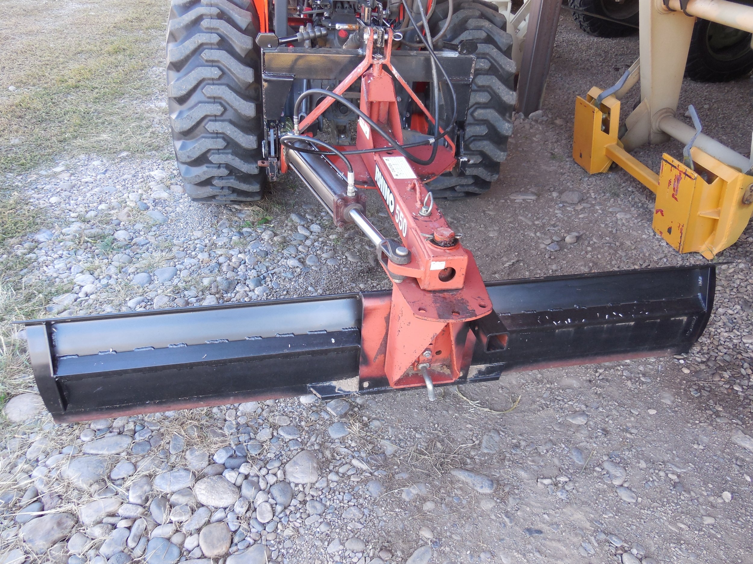

Speaking of snow...

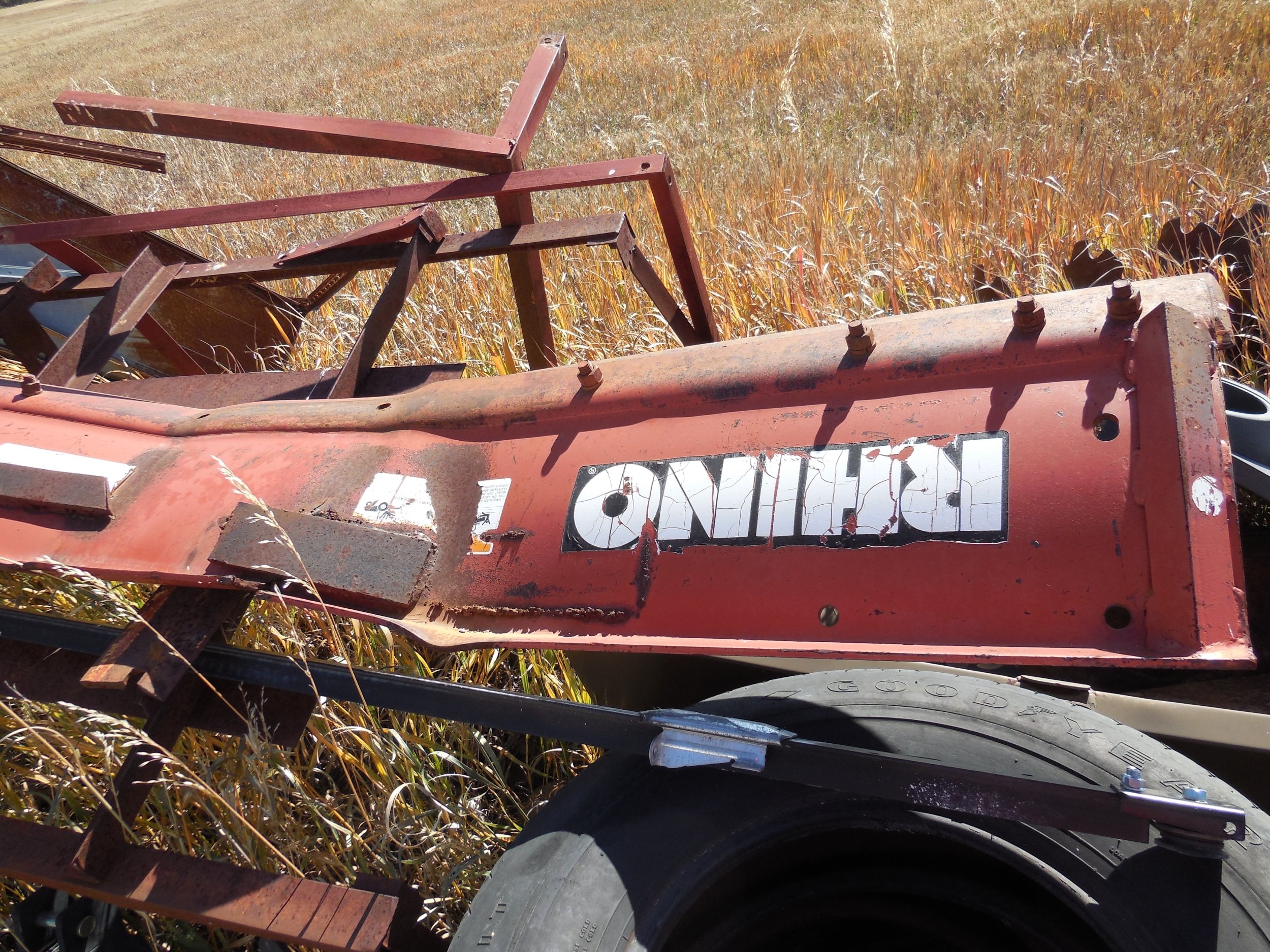

Removed the little mower and installed the salvaged Rhino blade for winter duty. As you can see, the blade itself isn't exactly as delivered. That's because somebody had bent the original blade, repaired (badly), and bent again a few times. But at $50, the price was right.
Don't ask me how they managed to mangle it so badly. To the point that it had a bit over a 90 degree bend in it. After a futile attempt at straightening it I started looking for a new blade, and quickly found that they're very proud of them.
Ended up having one bent up at the local metal place, then added reinforcements as necessary and welded it to the original mount, then welded a cutting edge to the bottom. Also had to replace a corroded quick connect on one hose.
All said and done I have under $300 invested in this setup, and it works quite a bit better than the (free) basic Kubota blade I've been using for the past 12 years. More weight, less slop, and the ability to offset is great.
