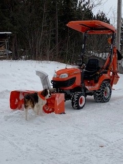

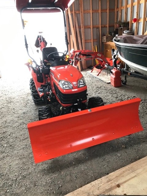

I purchased both a front plow and a snow blower for the front of my BX25D a few years ago. I too clear about a half mile of gravel road in the winter as well as areas around my out buildings. I pack the first few snow falls to create a snow base so I do not have to deal with stones and rocks.
The first year I started with the plow and switched to the blower once the windrows were as high as the plow. This was not the most comfortable thing to do in December in Northern Ontario. Last year I just used the blower from the beginning and it worked great. No cold weather switch over from the plow to the blower and I could move the snow where ever I wanted.
