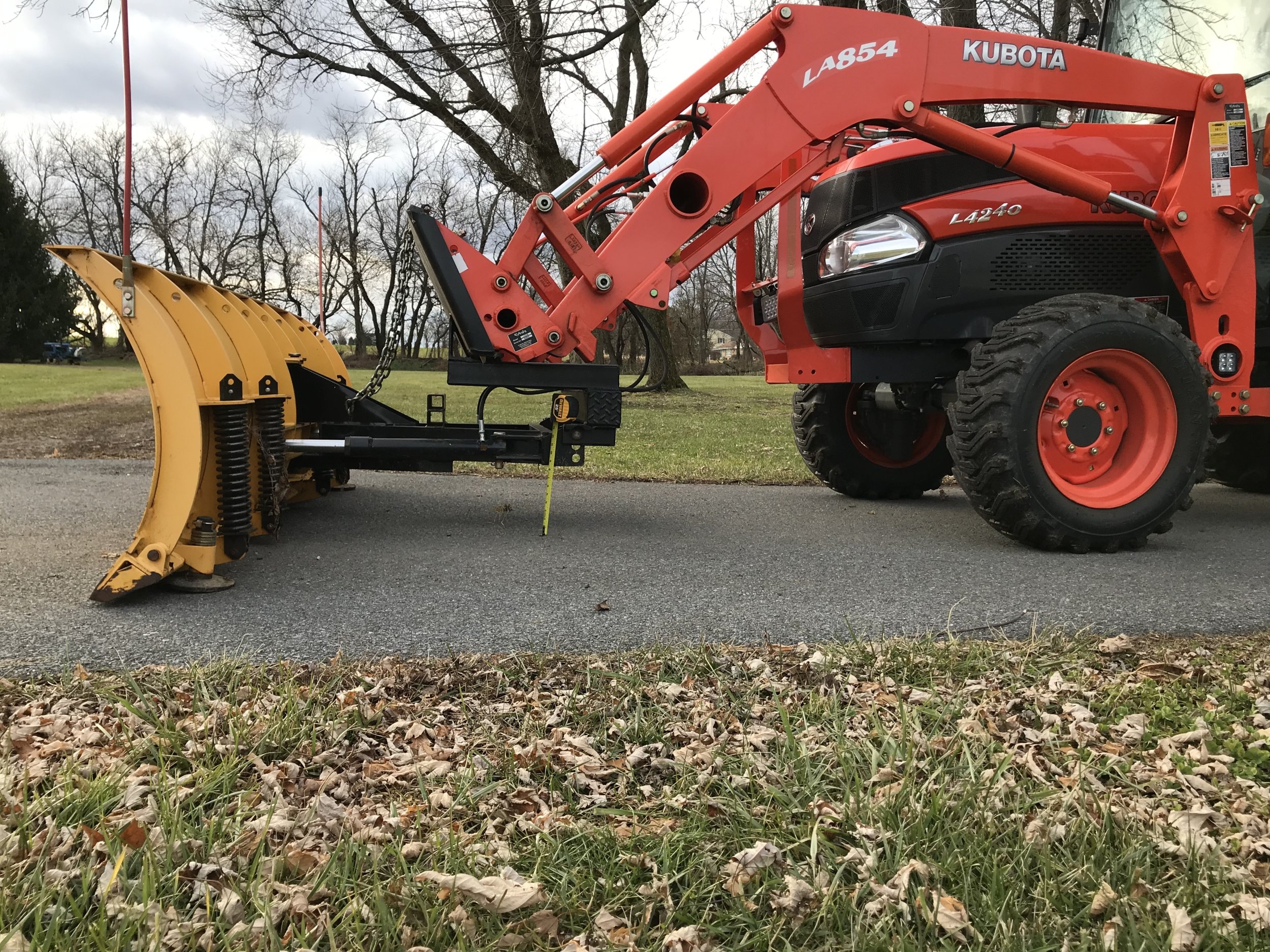

Hands down a power angle front snow plow.

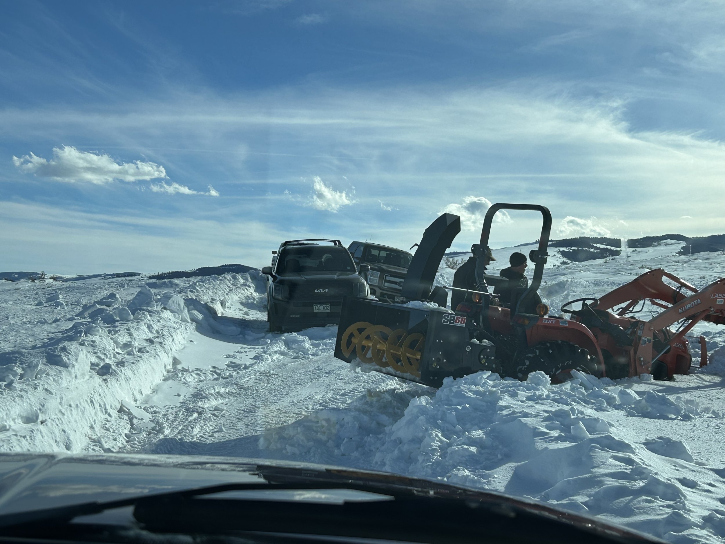

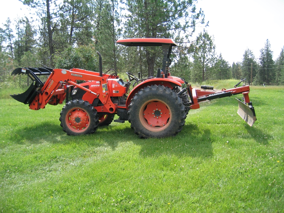

I have a mile long gravel driveway. For the first 27 years I had a Ford 1700 with a rear blade. On rare occasions I'd wait too long - the snow would get too deep - the rear blade would tend to push the rear of the tractor around.
Now I have a Kubota M6040. FEL with grapple - Rimguard in the rear tires - 1000# Rhino rear blade. In this configuration the tractor weighs - 10,000 pounds. I offset - angle the rear blade and go down the driveway like smoke and oakum. It takes two passes to clear the driveway. Sore neck and shoulders - NEVER. Once the blade is set - it's just - - go like the wind.
Now - you want to talk about a REAL PITA. I had a 3-point blower for the Ford. Used it when the snow got really deep. At least four hours to clear the driveway and mailbox area. Another hour or so to clear the yard.
My neck and shoulders would take two or three days to "heal" after using the blower. That's one of the major reasons I went to the Kubota. Bigger, heavier tractor with a HD rear blade could handle the deepest snows.
This is my snow machine..........
8 foot ? How much snow before it bogs down?
