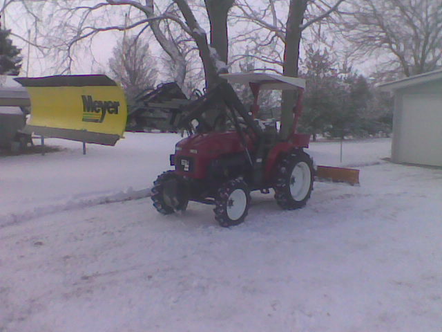

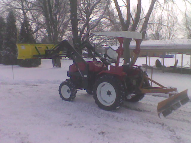

/ FEL Plow #6

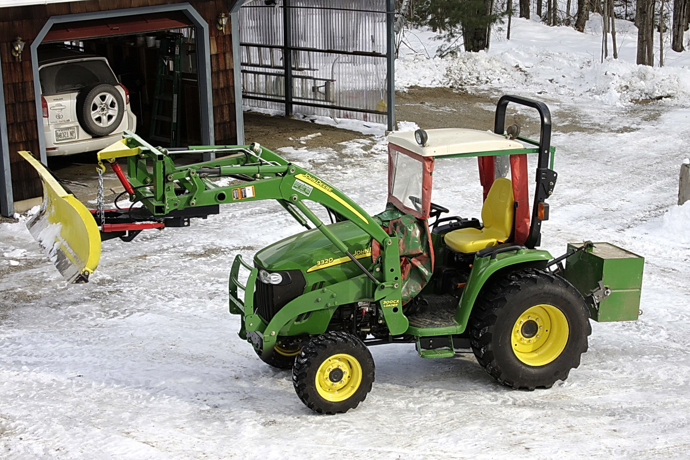

Lots of us have done it, heres mine. As others have already mentioned. Do search here, there should be lots of threads with lots of plows.

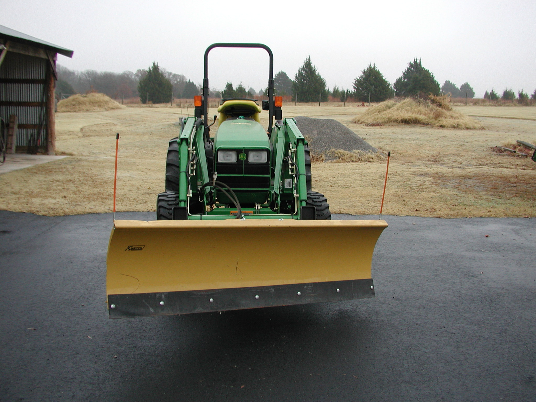

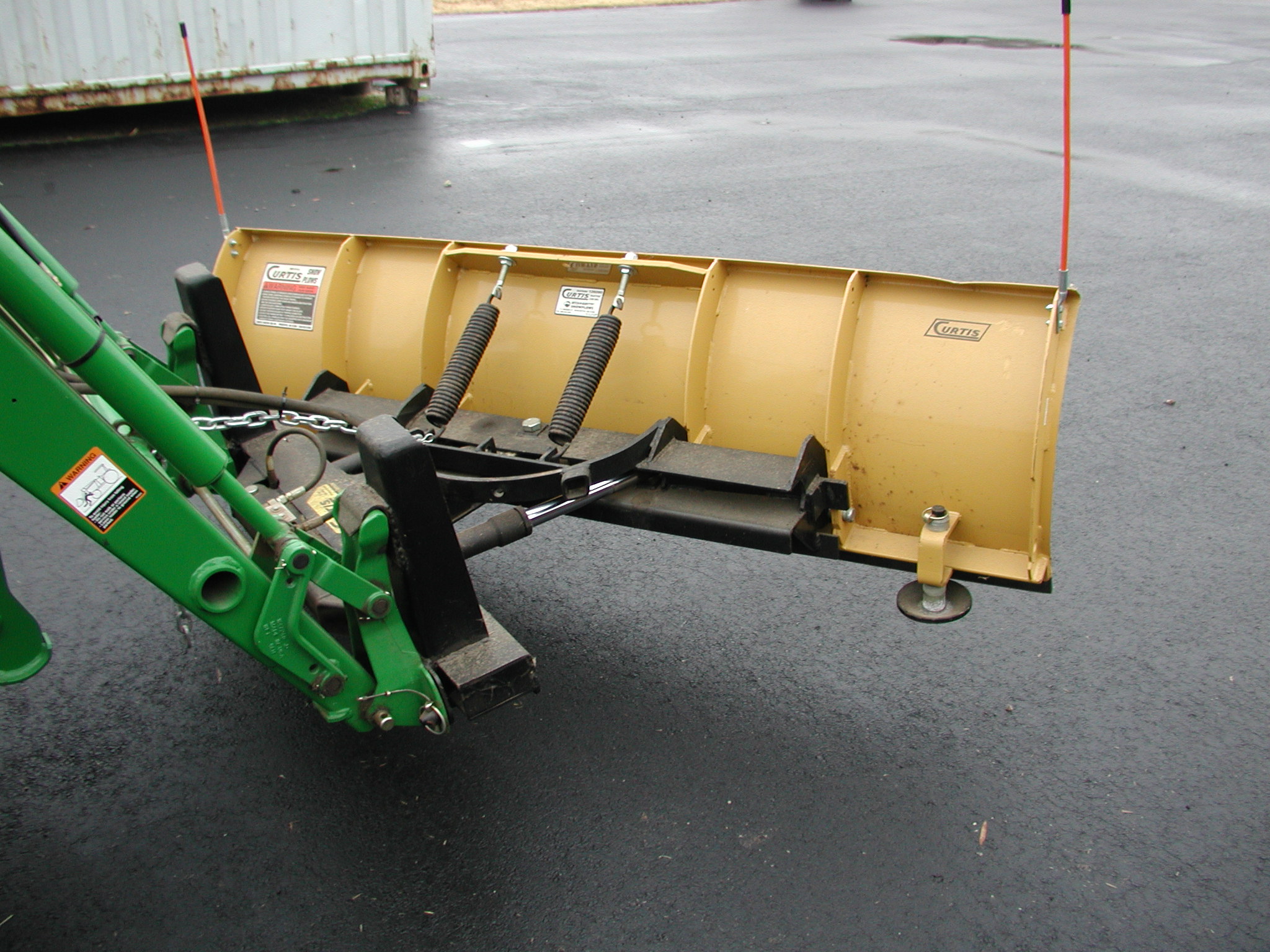

I have a Curtis snow blade that works very well and is quick and easy to attach.

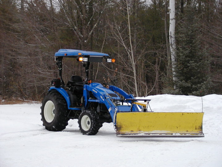

This is the way I did it. Don't use anything bigger than a 6 foot plow. This one is working out great. You will need a decent counter wt. for Ballast.
