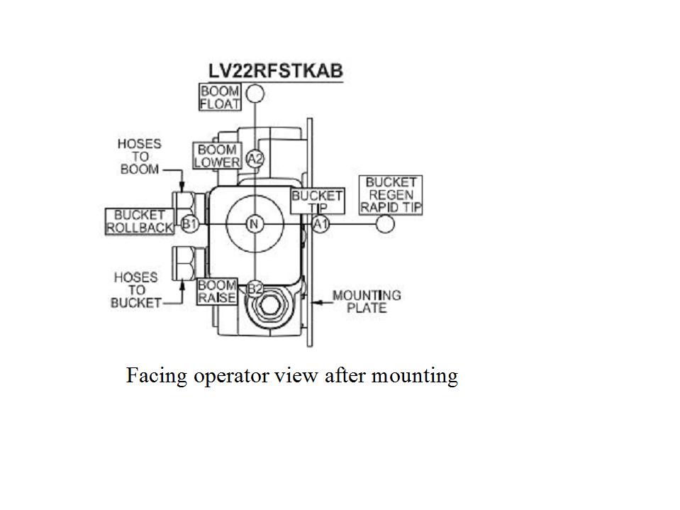

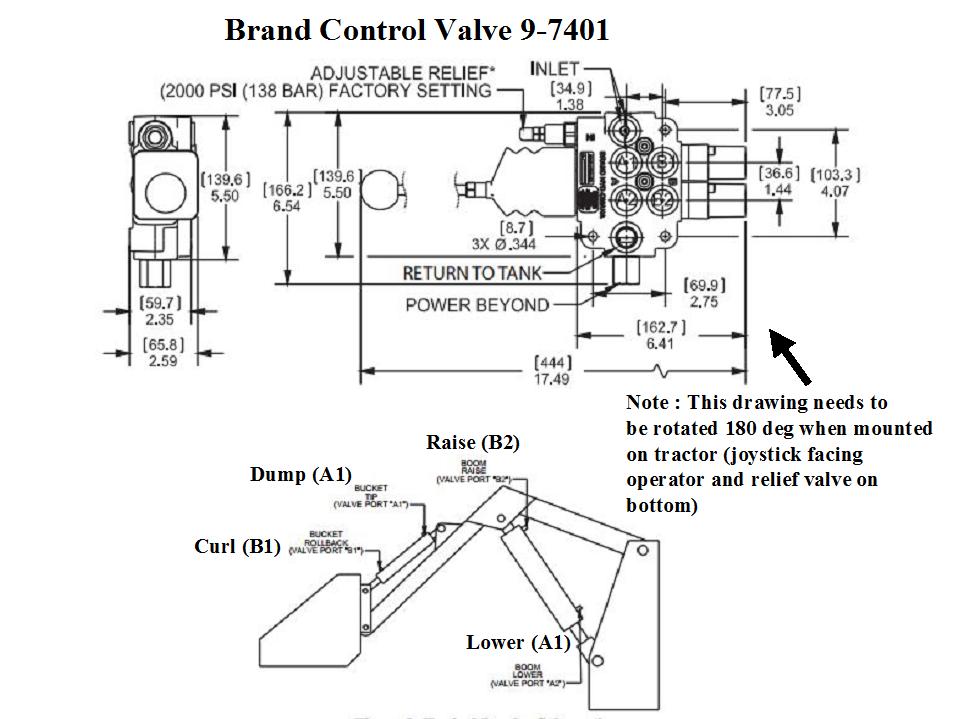

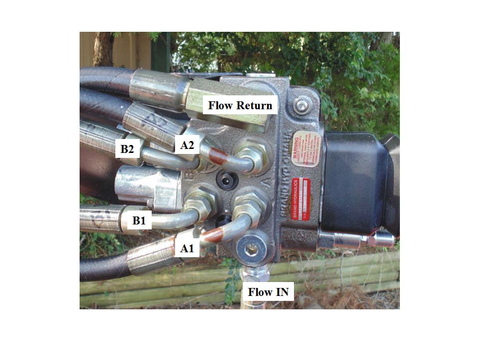

Here's what I have - hope it's large enough to read.
   / FEL pressure measurement locations #27
I assume the old loader valve didn't have power beyond? How is the 3ph fed on that tractor? Was there only the 6 hoses on the old valve also?
Is a1 and b1 hooked to lift or curl?
What is the full model number of the valve? (Might be on the red tag if you can take a close up clear shot of that)
#28
No power beyond on old valve and hose connections were the same as the new valve.
The model # on the tag is LV22RFSTKAB, but I see references to the valve as
LV22RFSTKAB 9-7401. B1 and A1 are bucket controls, B1 : curl and A1: dump. (shown
in bottom of 1st pic).
