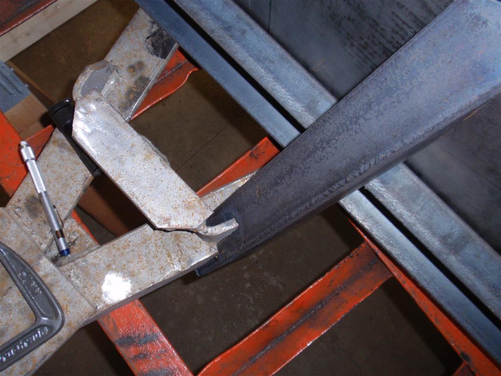

I worked on repairing the damaged parts over the weekend and tonight spent the evening sorting through the SSQA mount. I lined it up and tacked it in place first on the back edge. Putting the plate and the A frame together makes this thing rather heavy.... I attached a few pics. I am going to use that piece of C-channel laying in there to help support the bottom of the mount better. I will cut a shorter piece for that. Because the bottom lip of the plate is bent all the way across for the SSQA pin holes, I need something to weld the plate more solidly as the only contact right now is where those back side tacks are... thus the channel.
I got one of the angle braces done. It was quite a bugger as the top is a compound angle and the bottom gets notched around that bracket. The torch works great for this cutting, but I ran it dry of O2 at the end so I did'nt get even a half decent cut along the bottom edge. I'm still on my first 20 lb propane tank too, and that was my 2nd O2 tank! Oxy-propane uses a lot more O2 than OA cutting, apparently. I can probably do 3 full O2 tanks or more total before needing more propane. I may run for a new tank first thing in the AM so I have it on hand to finish up. The weld shop is very close.
Fit up is not perfectly precise on the angle brace as it was so difficult to sort out. So even though the only way I could do the fitting was by trial and error (after using a woodworking dovetail angle gage to transfer a rough angle), I was able to grind and cut it close enough to work just fine. In pic #4 you can see the tubes I put in for the rear skid shoes behind the SSQA plate. I shortened the A-frame too, before putting those in.

   / FEL Snow PLow size? #48
Looking good, but I question the placement of the angle brace.
That angled peice you got that funny notch out in, the peice that it goes over is the plow abgle stop. The way it looks now, you wont get full angle out of it because it will hit your angle brace. Maybe you knew that?? Maybe you planned for that??? or maybe I'm just seeing things wrong this morning??.
Also, Did you test fit one of the cylinders? Because I know there isnt much room between the cylinder and the side of the a-frame where that angle brace goes.

Good catch. I didn't think about the cylinder clearances there. I'll need to try that. Worst case I can pull the bracket in a bit so it sits totally on top of the frame, though I was hoping to use the extra weld area on the side of the frame for stiffening. It may very well affect the max angle also, though I'm not sure it will be much or really matter. I can play with it a bit more tonight. The cylinder will be the bigger issue, I think.
This brace is one of those things you can't really try out much until it is complete and in place as there is no way to get it in there until it is fully fitted. But I'll check it out before proceeding with the second one. I have room to adjust things still. It will just take more time. I was trying to get the support as far forward as possible, and am running into these issues as there just isn't a lot of room to work with there.

You can weld the angle braces to the TOP lip of that peice with the pin hole in it. Thats about the only place I see. Because any farther forward and you are in the way of the sector, and where it is now is in the way ot the angle cylinder.
You could always try to move the QA plate farther back (closer to where the origional pin hook-ups are) and that would give you a little more angle for the brace.
