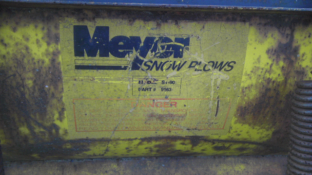

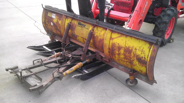

So i finally found one. $175, which I thought was fair. Appears to be a meyers st-90 though the label is worn. One break in a brace on the back. I need to weld anyways for the conversion...
