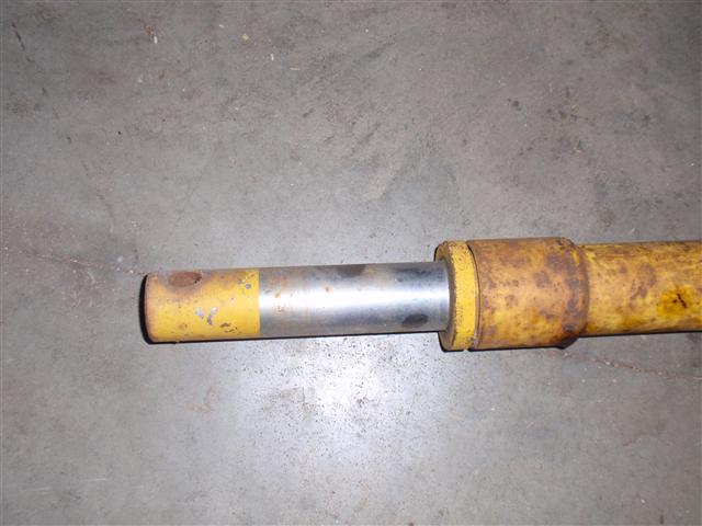

I'm not sure if the cylinders can be re-used or not. The exposed chrome has a few pits in it, and it may tear up the seals. Dunno - that's an area I don't have much experience in. I haven't tried to move them yet. Ran out of time to mess with them.

The pitted chrome on the cylinder pistons will tear up the seals. Seals are cheap, it just takes time to replace them.
Yea, it will wear out the seals and leak a little. If you are using your tractor hydraulics, I wouldnt worry about it. Because you could probabally run the plow for the tull 200 hrs til next service and it wouldnt leak enough to be a drop in the bucket. They arent under constant pressure.
But if it does get too bad, it is a PITA and about $20 each to do. Those gland nuts are on tight. If I ever do mine again, I will just buy new cylinder. baileynet.com has aftermarket replacement cylinders for like $50. For me, spending half a day and cursing like a sailor isnt worth trying to save $30 per cylinder. And since the rods are pitted, a new rod + seal kit would be even more than the whole cylinder.

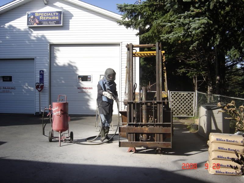

Dave it looks as if you found a really nice candidate for a tractor plow. I've done plenty of sand blasting and even made my own pressure blaster. It's one thing to rent a blaster but pease protect your lungs. I use a 3-M blower that supplies fresh air to my 3-M helmet. Yes it's expensive but how much are lungs going for these days?
If I only had one use for sand blasting I'd pay the money and get it done. It's very dangerous stuff and it's hard work my friend.
Ah the old Whitecap... Yes I know it. I'll let my secret out... I work for 3M developing respirators, and have for quite a number of years. So I have access to basically any safety equipment I would ever need. I appreciate the concern, but I am well aware of sandblasting hazards (and many other hazards you have probably never heard of...), so don't worry about that. I expect it is hard, but it is also something I have never done, which makes it worth trying out. A sand blaster here rents for $25/day (plus media), so that ain't bad at all, and it's not like I'm doing an entire forklift or anything crazy like that:laughing: Oh - and thanks for your business!

Glad to read your up on the hazards of this type of work. There are many who are not. I remember about ten years ago a friend of mine asked me to Sand blast a boat trailer for him. I told him I would and told him I'd do it just for the cost of the sand. Well he got mad with me and said he'd go a rent the equipment and do it himself which he did.
The thing that he didn't rent and couldn't rent was a good breathing apprentice but went on to do his trailer.
Before he managed to get it completed he ended up in hospital where he stayed for three weeks and he ended up loosing 40% of his lung capacity.
Now you see why I show concern about this sort of thing. I've done plenty of sand blasting and I hate it. The helmet and hoses are heavy and on days it's very hot not to mention back breaking but it's a nessassary evil to get the job done right.
I did all my collection for my musume with that 3-M gear. I purchased it new at an auction. I got the helmet, hoses and ambient pump for $250. and it was brand new at the time. I actually had to cut the boxes open to use it. I bought the full lot of them (6 lots in all) and sold the rest on fleebay and did pretty good out of it.
The black media is good stuff but clogs the blaster easily. It's more expensive (but safer) but you get less of it. It do cut good though.
The silica sand is easy to get around here but as you will know comes with many hazards but still does a great job.
