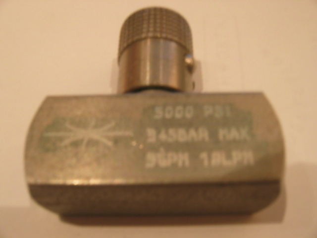

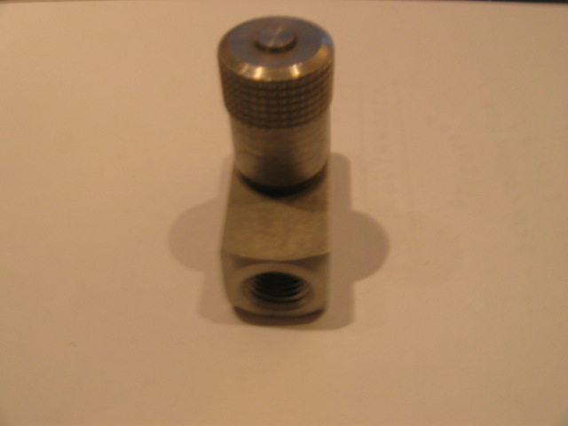

To slow down the speed of the angle you need to add one of these. Grainger has them. You only need to add one on either cylinder because it restricts the flow in both directions.

As DanD says, a flow control needle valve is the $30 answer. Some models only control flow 1 direction, so be careful what your getting.
Forget wasting your time making one you can't dial into the speed you want. You will have it out and drill it 10 times b4 you get it right.

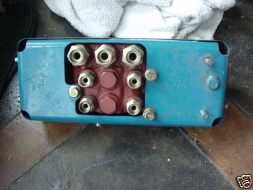

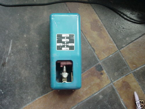

Any idea what valve I would need? getting to be apain hopping on and off the tractor to switch the angle.

How many hoses are connected to your FEL valve? If it's seven-is there a port marked "PB" for power beyond? Some pictures of you valve will also help.
And you may want to start a new thread so your info does not get lost in this one.

Thanks Kenny for replying so fast could not get any good pics with the weather but valve looks exactly like this one I found on ebay made by hanix usa.

Looks like it has seven ports...You need to verify that on your machine and identify the PB port.
