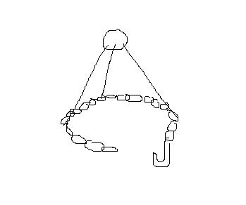

How about this for a rock sling (excuse the lousy drawing). The advantage of this is you don't have to pick the rock up or roll it. The bottom has a hook that will allow you to adjust it to fit. For added security you could also add another wrap half way up the verticals with another hook.
The vertical links should be chain, shown as straight lines...

Older thread, I know, but can you tell me how you remove the sling once the rock is placed on your wall?
Good Afternoon 5030,
That rock sling was a great idea ! I have often used a set of old chains to move boulders but that sling looks like the ticket. Im thinking he releases the sling and then lifts his FEL up, the only problem with that is the boulder is going to move to another spot. Maybe ACHINBAC will jump in here and enlighten us ! :)
MWB's idea looks good for placing the boulders in one spot without having the rock move !
