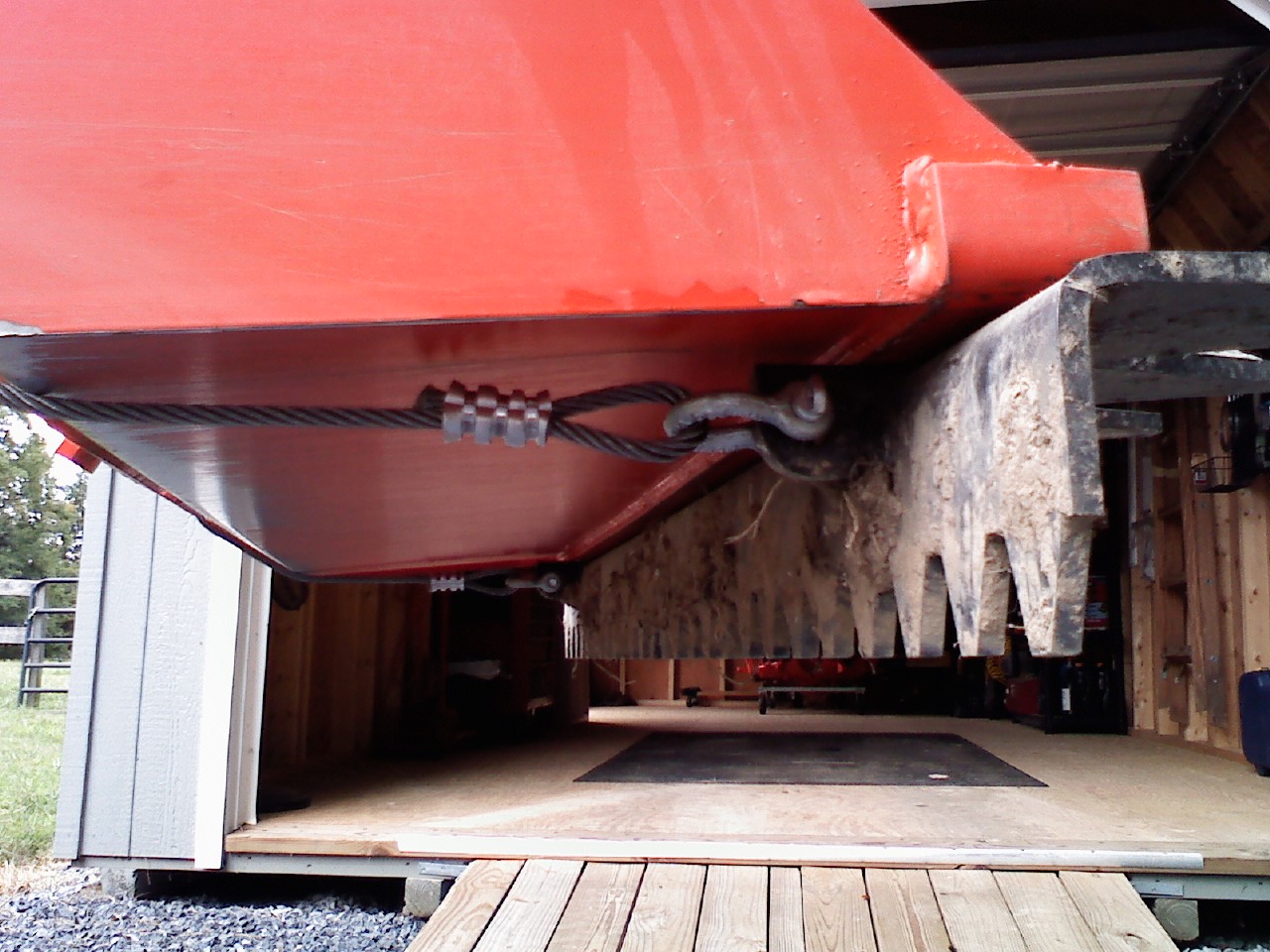

Any owners of the Ratchet-Rake ever have a problem with the nylon straps that wrap around the bucket? Those look like they wouldn't stand up to much abuse. Other than that, it looks like a fine tool.

Great question Country1. In the early days of Ratchet Rake starting their business, some of us had issues with the nylon strap being chewed up during use. The company then came out with a protective sleeve to help with the wear on the strap. They then improved their connection even further by using a cable and shackle system to be used with ratchet strap. Now, the only thing touching the ground is the wire cable. Check out their brochure that shows what you should receive when making a purchase http://www.ratchetrake.com/images/ratchet_rake_brochure.pdf.
Check out the below picture and it will show the cable in use.

I see, nice design change. That was my main concern, where the strap was attached under the bucket. Thanks for the post.

Great question Country1. In the early days of Ratchet Rake starting their business, some of us had issues with the nylon strap being chewed up during use. The company then came out with a protective sleeve to help with the wear on the strap. They then improved their connection even further by using a cable and shackle system to be used with ratchet strap. Now, the only thing touching the ground is the wire cable. ...
I'll start by saying every person has a right to his own opinion and should purchase the implement that seems right for him or her.
That being said, however, those same issues with abrasion are why I would only use a bolt on tooth bar or landscape rake. If you use the thing enough, there will eventually be wear. The bolt on goes on and off quickly and is much more simple in design with far less hardware than all that wrap around stuff and without the need for ratchets. Just my own preference, YMMV.
I may buy one, and if that cable ever begins to wear I would improved that design by cutting off that attaching eye and welding on a 1/2" bar from the rake to the back of the bucket bottom and then re-installing the eye. All the abrasion would be on the bar and not the cable from that point on.
