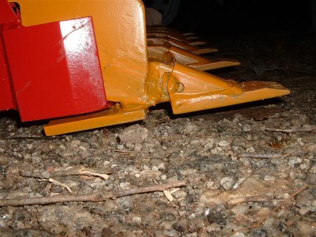

Here's the EZ Attachments toothbar I just got on my new Mahindra 2015 HST. I have some envious neighbors now. One has a JD CUT with no teeth and I think he is going straight to the nearest dealer to pick one of these babies up - there are several dealers around here. He is a very technically oriented person who has his own welding equipment, works on airplanes for fun and manages technical work on Delta airliners for a living. He thinks the design is superior for tractors like mine and his.
