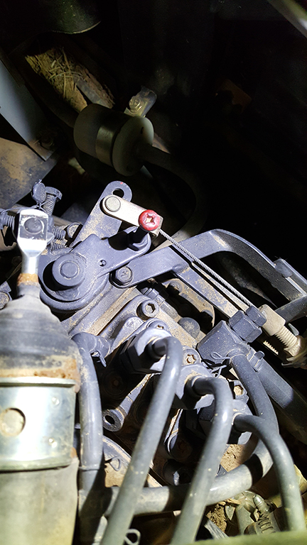

#37
What moves is the red screw - it clicks when I turn the ignition on or off.

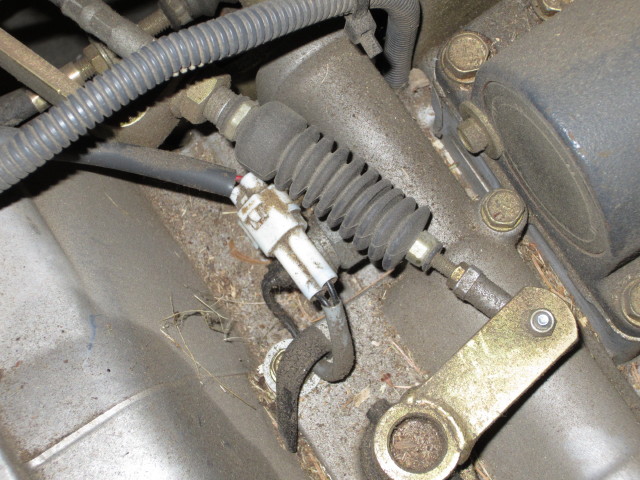

For the relay to work you need power on the small red/blue wire. That is the wire that comes from the safety switches. Those would be the neutral switch and the hydraulic lever switch(turf only).
   / Fellow Kubota RTV900 owners / mechanics - H E L P P L E A S E #39
The neutral switch should be on top of the transmission with 2 wires. If you unplug the wires, one should be hot when trying to start. If you jumper (bypass the switch), you now should have power at your relay on the red/blue wire and it should start. Good luck.
