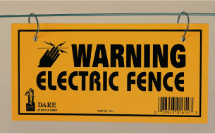

While we are on the subject might be wise to check your local laws incase powered fences require being posted as so ?
