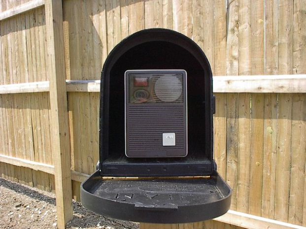

Here's my set-up......
At the gate....

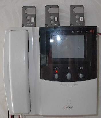

In the house....
