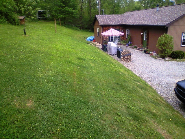

This will be the main entrance to the rear of the house. The fence will start behind the big bush on the right of the pix. I need a double gate , 8 foot wide in the flat area for deliveries and for the BX to haul in firewood to the french doors behind the pop up tent. The fence will continue up the slope toward the woodline. The black spot in the foreground left is a apple tree with a 4" tree guard. This will be outside the fence. It will continue along the hill to enclose the dog run.( third pix shows the dog run alot better) I want to stop short of the actual woodline to allow mowing the outside fence area. Somewhere between the doghouse on the far left and dog run.

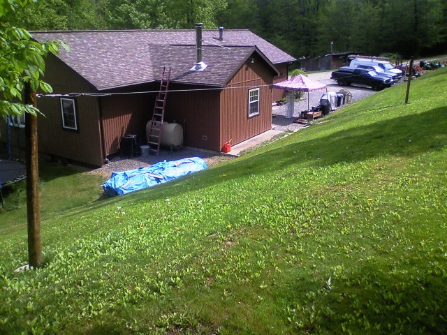

This is back rear of fenced in area. I will tie in the center of the house to the left of the window. I will come straight out 30 feet or so and then turn up the hill. Basically around where the trampoline is sitting. I plan on removing the tramp, wood pile and enclosing the oil tank. On this side I need a gate wide enough for a riding mower w bagger. ( 4 feet minimum) (Note the drainage ditch I installed back when the tractor was new 6 or 7 years ago, holding up well and keeps house and yard dry.)
This is a view from the top back corner, far end of cable run. You can see the grade and get a better Idea of the slope and project in general. The dog run is cemented in on both post, the Husky can't budge the poles. (Glad I took these pix to see where my son left the gas can yesterday evening. I also really need to start spraying this back area for weeds!)

Copperhead, I just kinda scanned the thread, so excuse me if I offer something that's already been covered or isn't needed.
We do a lot of fencing for our horses and dog and I use a 6" auger. It seems to dig holes slightly larger than the actual auger size, so it's worked fine for the round posts we use. We usually get 4"-5" posts (7 1/2'). Our dog (a very nice German Shepherd) doesn't climb or jump fences, so we're okay with a 4' high fence. The posts are 5' high and if they're around the horses (or if the dog climbed), we can put a hot wire across the top.
My B7500 barely lifts the tip of my Leinbach PHD clear of the ground. That means I'm limited to the amount of slope I can drill in. The auger simply won't clear the ground backing up a slope that's very steep. It might make it on yours... But that's something you might want to check out in your PHD/auger purchase.
We've set some posts in concrete, but most we just fill with crushed rock and pound it in with a big bar we have to set it up. The concrete-set posts don't seem to last any longer and they're harder to replace when they eventually rot out (10-12 years I'd guess).
I use the tractor to tension the wire before I attach it - so I need strong end-posts. Often we'll brace the end post with a diagonal piece to the adjacent post(s). To tension the wire fencing, we'll pin the end of it between two 2X4s that are lashed together with heavy twine, then hook a line up to the top and bottom of the 2X4s.
The most difficult part of the process for us has always been getting the posts perfectly in a line. If they aren't, it can be tough connecting the wire fencing once it's been tensioned. I'd swear I have the starting drill-points perfectly lined up, but we have plenty of rocks and the auger gets moved around a bit - so the fact that our holes are a little larger than we need is helpful for getting the posts in alignment.
