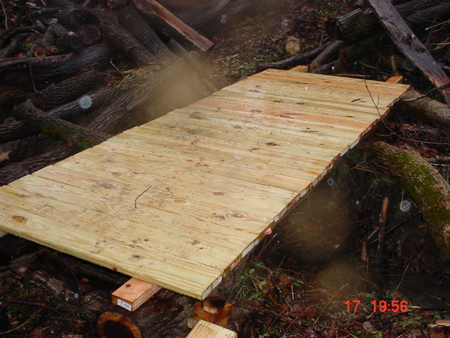

I am missing where the boardwalk in the last picture is going. At first I thought it was a pallet and I thought it was an extension of the pallet thread. But it appears to be a boardwalk and it heads to the tree with the hog wire on it. So I guess I answered my question.

That "boardwalk" is a footbridge across a creek right next to a small waterfall. I want to keep the tree since it provides shade in this wonderfully picturesque spot. And I have to get the dang fence out of there so folks aren't tripping over it or stepping on it and getting tetanus.
Nice. And it looks like you have some firewood too? Given the creek and the lay of your land and the wood, getting that fence wire out may be a little more than you bargained for, but it can be done.

Tom Seller --- Loggers left all the tops of many large walnut trees, so I've got tons and tons of firewood. I've cut a lot of it in place, just need to get it up and out of there. Have a winch on my wish list.

I thought that looked like walnut laying on the ground. Glad you got the fence out. I've done a lot of fencing with that type of fence plyers, not the easiest to cut with, but for what you had, it got the job done.

The spanner lumber looks to be a 2x4 or 2x6 neither of which provide much strength in the position that they are laying. Laying on edge would be better, but I think I would have used a a treated 4x4 fence post for the spanning lumber.

Look closely, I think he has them on top of logs

Yep, two 12" logs set on abutments the same size and notched,skinned and leveled somewhat with a draw knife.
2x4 treated lumber lagged into those, decking nailed into the 2x4's.
