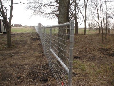

This is the client driving the skid steer with my roll of wire handler. It makes handling the two hundred and eighty pound plus rolls of wire nothing but a thing. We just drive down the line.

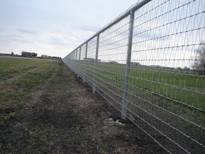

This is what it looks like from the west end looking east.
One of the problems dealing with five foot (58") V Mesh is it doesn't really like changing grade, especially in a short distance.

But it will do what you want if you hold your mouth right. /forums/images/graemlins/grin.gif

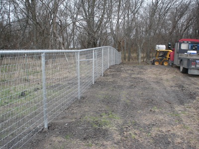

I hope you can see the grade variation and how I handle it.
What I try to do is to eliminate the highs and lows and go for even rolls up and down and little of those as possible. Over time the grade will grow to the fence as the livestock runs along the fence.
In a couple of years the variation between the fence and the grade won't be noticeable.
