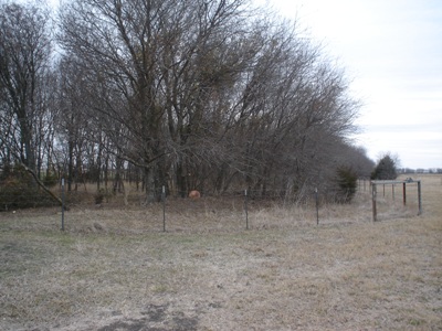

This week has been about setting posts. Monday we cleared trees and undergrowth from the fence line. Tuesday we dug the post holes along the back line and set some posts.
The client is wanting to preserve this section by enclosing it. He'll get it inside his fence but have another fence to keep it from the exposure to the livestock.
Here's a before.

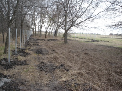

Here's after yesterday.

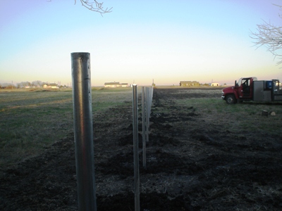

Yesterday after mixing three yards of concrete and setting the rest of the back line posts we had lunch. After lunch we dug these eighty six holes and placed the posts in them.
This morning we'll mix almost ten yards of concrete and set this line. It's a little over half of the north side fence line.
These posts are eight feet long even though only about four foot is sticking out of the ground. This insures I have concrete under by post as well as around them.
They'll be as tall out of the ground as the post in the foreground. It's the corner post for the back line and north side fence.

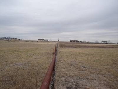

This is what the north side fence looked like before we started.

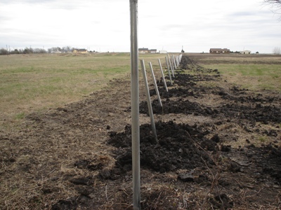

And this is what it looks like after yesterday. We got the posts set down to the cross fence (67 posts, not 85 or so) Then we dug and put the posts in the holes for the next sixty seven up to the house. We'll set them today.

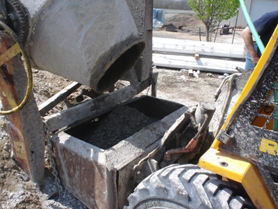

For those who aren't familiar with my system I use a pile of mixed sand and gravel and a concrete mixer. I usually use two day laborers to feed the mixer.
The mixer is a nine cubic foot model. I have a custom bucket I made for my tractor that holds a half yard of concrete. We put the mixer load into the bucket.
