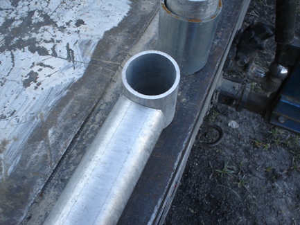

As I was cleaning up tonight I thought I'd share with my TBN friends some of the details of my work.
I talk about two and three eighths and two and seven eighths pipe. Two inch pipe, not tubing, pipe, has an O.D. of two and three eighths inch. Pipe is measured I.D. Tubing is measured O.D. So two inch tubing is two inch O.D.
Two and a half inch pipe has an O.D. of two and seven eighths.
Here's a piece of two inch pipe inside a piece of two and a half inch pipe (2 3/8's inside 2 7/8's). Both pieces are schedule forty.

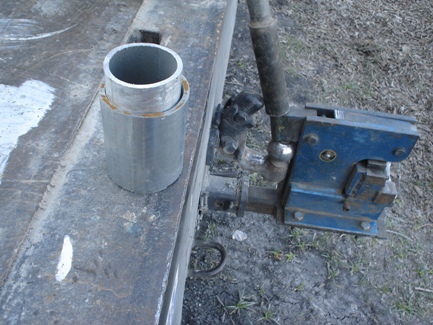

#70
In the background of that picture was the Vogel pipe notcher. It has a die set for two inch (2 3/8") pipe. It cuts the pipe so that even Ray Charles could have sewed up the joint if he'd been so inclined.
