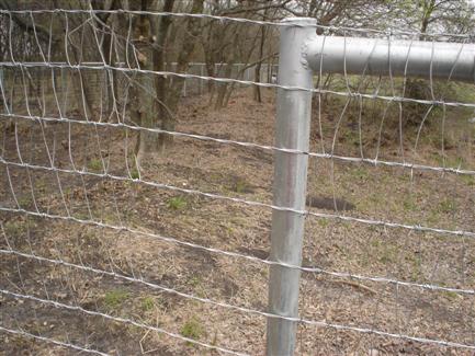

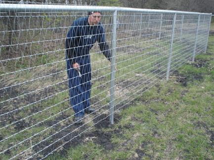

Yesterday was a good day. My son and a friend of his worked with me stretching and tying the V-Mesh. We got twelve hundred feet stretched and tied in about nine steady getting after it hours.
Each roll weighs about two hundred and eighty eight pounds. That's for about a hundred and sixty five feet. So we got to have intimate moments with six rolls of wire.
Here's my son so excited about following in his father's footsteps.

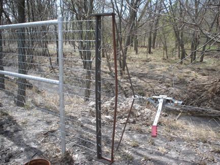

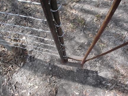

On five (58") foot V Mesh there's fifteen pairs of twisted horizontal wires. They have to be stripped of the connecting V wires where you're terminating the fabric.
This can not only be a pain in the butt. It's hard on the hands too.

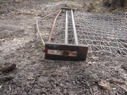

V Mesh is especially difficult to stretch and even on long lines I try to stretch each roll. Stretching that often is really hard on the two boards and a bunch of bolts and nuts system. So I came up with a friction stretcher.
The principles are simple. First you make it heavy. I made mine very heavy. It's heavy enough that it produces a grin from me every time someone else picks it up for the first time.
First you slide the fabric between the guide rods.

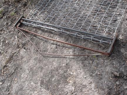

Then you fold the fabric around the floating rod.

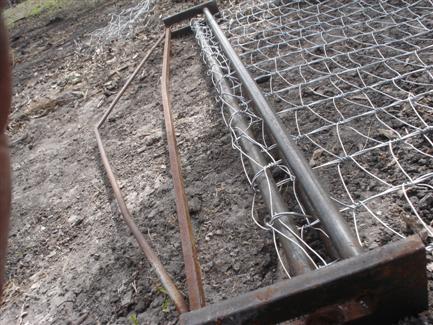

It is critical that the fabric be folded around the floating rod. That means where it's touching itself, enveloping the rod.

I've never had the stretcher break a wire. I've also never had it slip when I've had the wires folded around the floating rod.
