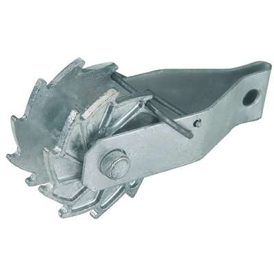

My fence has these little guys for fine tension adjustment after the fence has been strung

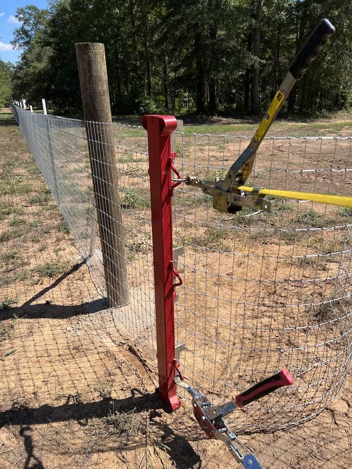

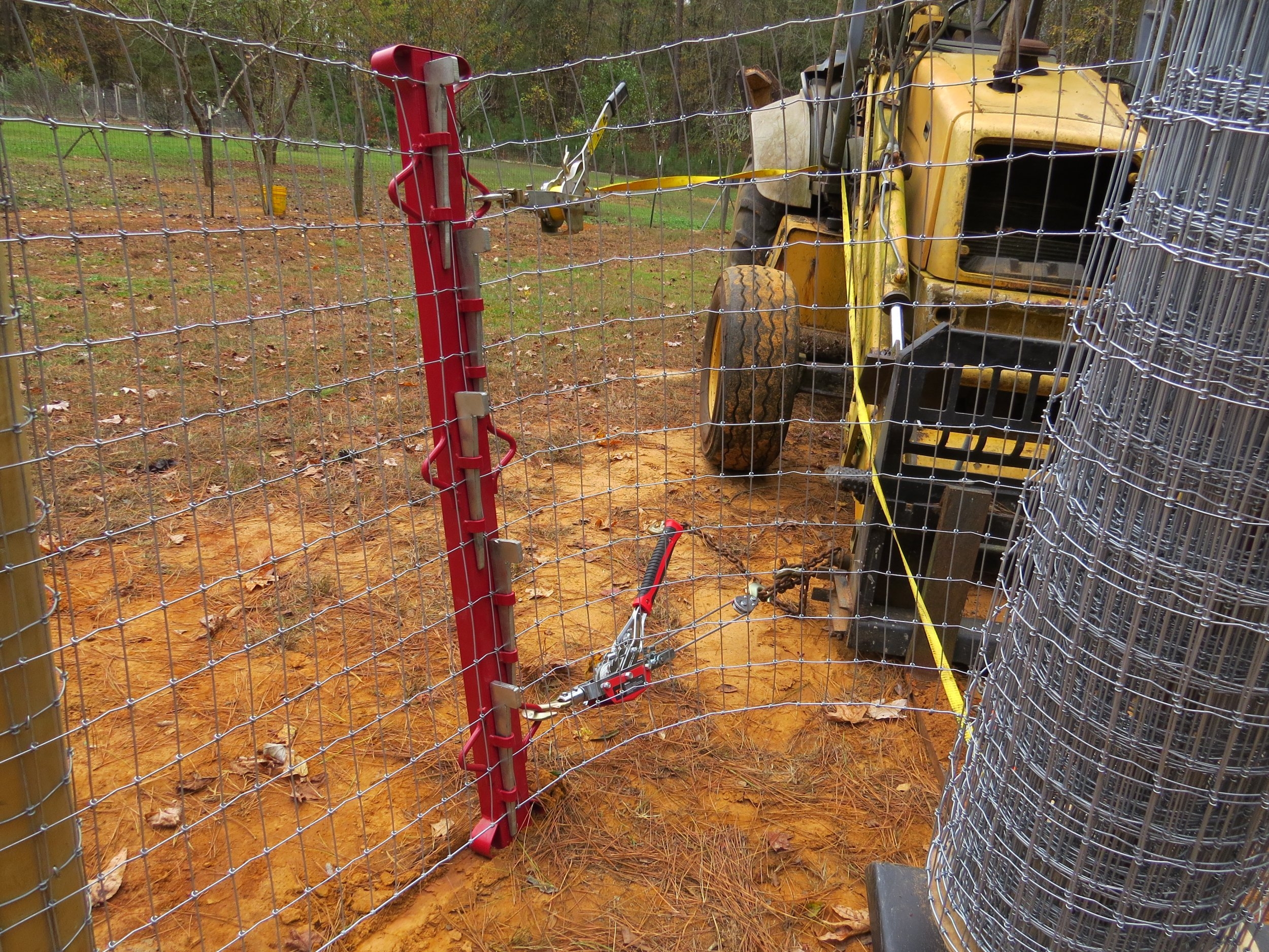

I've never done 8 foot fencing, but I would guess it's similar to 4 foot, just heavier. I use a metal stretcher bar from Kencove that cost me a little over a hundred bucks a few years ago. Before that, I was bolting two 2x6's together, but that didn't work as good as the metal stretcher bar. For just 4 rolls, you're probably fine with 2x6's.
To pull my fence, I park my backhoe where it lines up with the fence, then run chains from the backhoe to a Come Along at the bottom and another at the top of the fence. Then I just tighten it as tight as I can get it. From what I've read, you never want to straighten out the tension bends in the wire. I'm not strong enough to get it that tight, but I guess I could if I used the hydraulics on the backhoe. But there isn't any reason to get it tighter then I can with the Come Alongs. It's pretty tight!!!!!

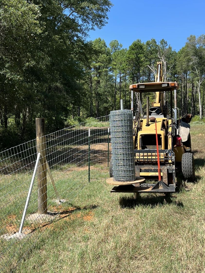

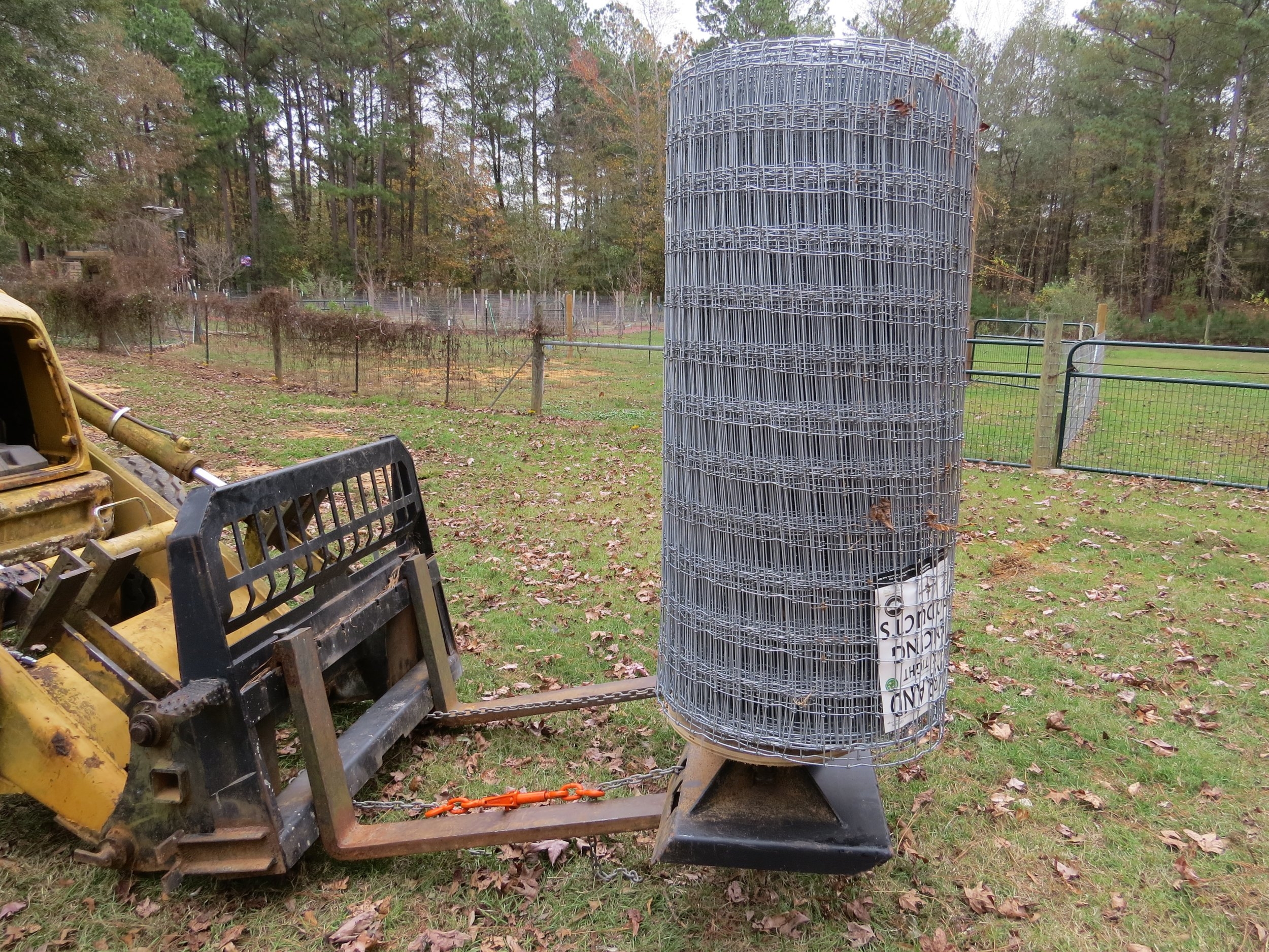

For me, the biggest challenge was figuring out how to unroll the wire. It's only 200 feet, but it's still super heavy and awkward. I didn't want to spend the money on something from the store, so I used what I had. I put my hay spear at the tips of my pallet forks, then slid a pipe over the hay spear and cut a round disk from plywood for the wire to sit on. My first disk was too small, but now I have it big enough to keep the wire on there while I'm backing up.

You are not going to be able to overtighten a 8' woven fence, pull it as tight as you can. Also for pulling if you use boards for a stretcher cut vertical wire at the end so you can wrap the horizontal wires around the puller and twist around itself. With a fence that tall I would do what super55 is recommending above.

It went pretty well. That fence is heavy and cumbersome and is a real pain to put up but I think my project went as well as it could have. The one thing I would do differently if I did it over is just buy all 6x6 posts. I used some 4x4 to save money and though they are working fine they just aren't stout enough for 8' fence. I rigged up a swivel contraption that I suspended from my forks to unroll the wire upright. That worked really well. I used 2x4s drilled every foot and bolted together with the wire sandwiched in between as a puller. That worked really well. Come alongs anchored to the tractor grill guard was my puller. I got it all up and went back and put t-posts about every 25 feet. I'll post up some picks when I get a chance. I've been busy in my deer free garden lately.
