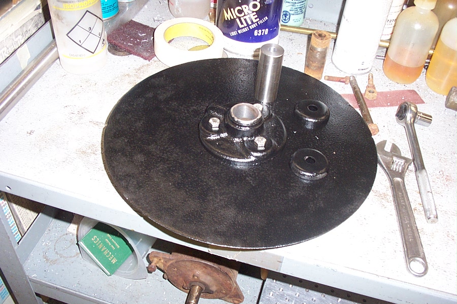

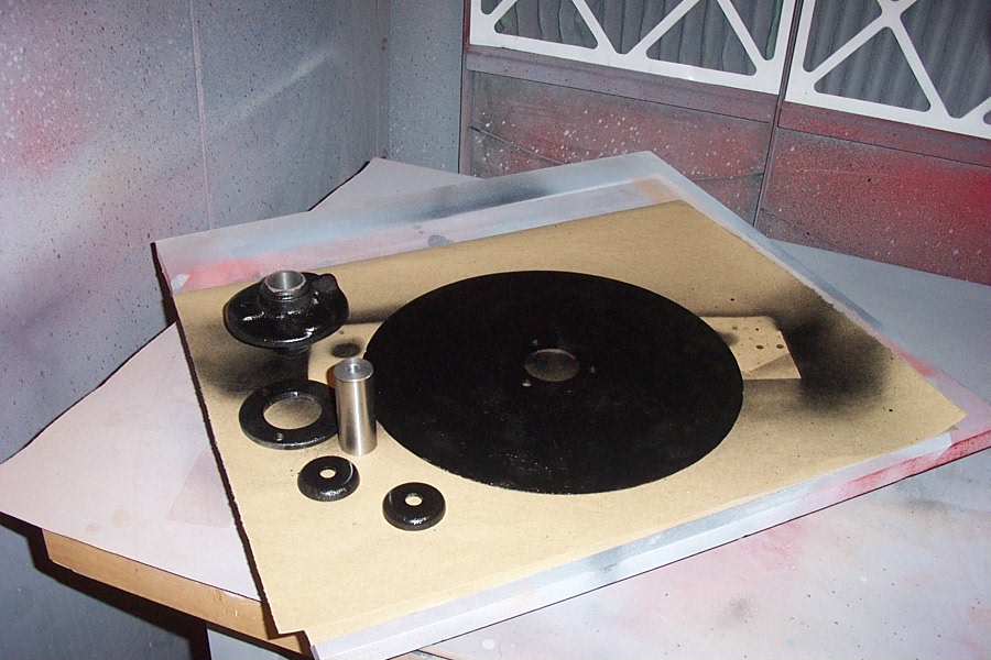

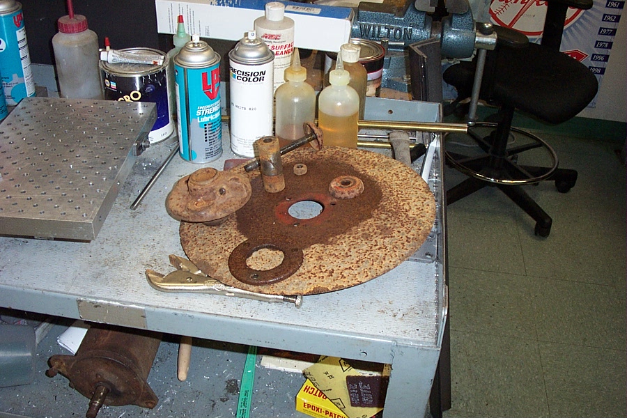

I took both coulter assemblies off the plow. Disassembled the rusted mess and figured out what I was going to do to them. The original bushings that ride inside the cast coulter hub were 1.125. Either from lack of grease or a lot of use the cast hubs were badly worn ! I decided to make new bushings, so I bored the existing hubs out to 1.188 and got lucky and found a nice length of 1 3/16" drill rod to to make the replacement bushings:) I sand blasted all the parts, bored the hubs, and painted the coulter wheel and hub parts black. The coulter frame gets painted red. From the pics that I have found, thats the paint scheme. Although Im going to be using Farmall Red instead of Ford Red, but thats what Ive got and it will have to be good enough ! ;)
First pic, rusted parts
Second pic, boring cast hub out
Third pic, coulter parts sand blasted and painted
Fourth pic, coulter frame
Fifth pic, assembled coulter and hub
BTW, if FWJ is reading this, I hope I didnt use the wrong vernacular on any of the parts ! ;) Or Im in trouble ! :)

NICE spray booth....
set up for spray and powercoat?

Now Scotty, have you ever known me to correct someone when I thought they were wrong? And besides that, I do believe you got 'em all by the right name. And to top it all off, you're doing an incredable job on those coulter hubs! If the Big Brown Truck pulls up in front of your house and shoves a heavy box out on your porch, it's just 3,791 coulter hubs I need re-done. You wouldn't mind doing that small favor would you? ;)
Afternoon Steve,
Thats my spray booth at work, they are nice enough to let me use it on my old iron hobby ! ;)

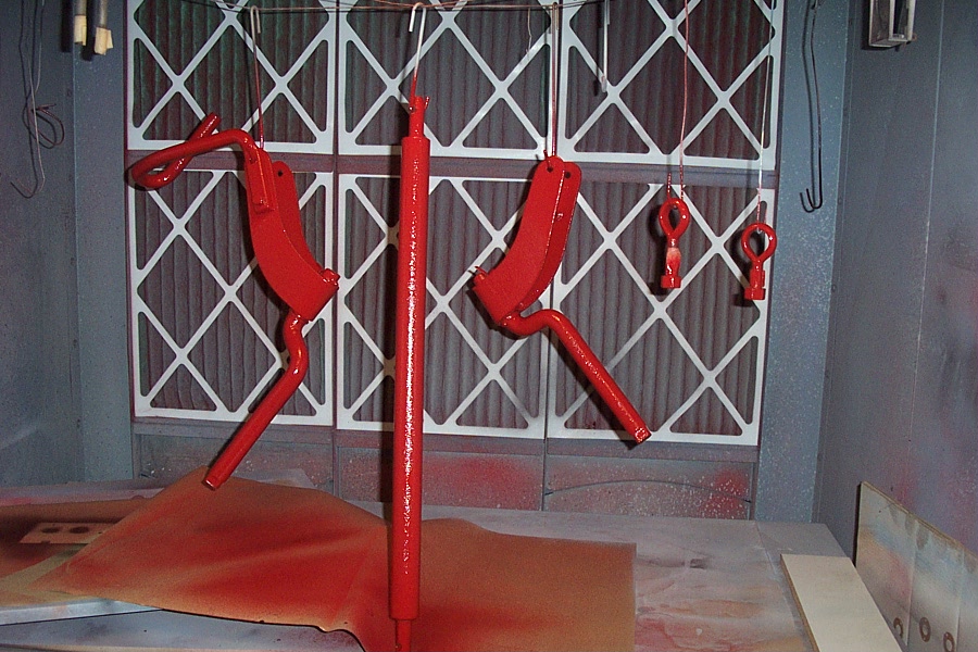

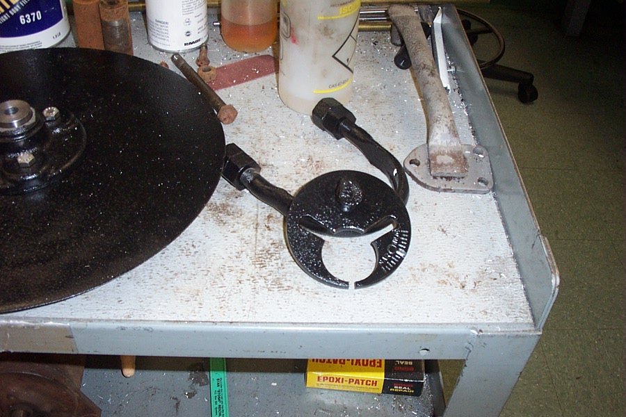

Did a little more work on the plow and painted the coulter frames and drawbar. Also the special U-bolt that attaches the drawbar to the plow with the width of cut adjustment.
First pic is the coulter frames painted
Second pic is the adjust mechanism for width of cut
BTW do they still make those special eye bolts that attach the coulter frame to the plow, the threads are not great on mine ?

   / Ferguson Plow... Opinions #39
Howdy Scotty!
I'm gonna take a wild guess and say that those eyebolts are gonna be hard to find new. Most of the wear parts are getting to be rather hard to find. It's downright next to impossible to get even the coulter disc itself nowdays.
I'd try posting on the "N" board over at YT.
Just to get a plow "perfect" I've had to buy a couple "junkers" to cannabilize for parts.
A machinist with your skills could probably make new ones with less trouble. It's well worth the effort to fix up a plow "just right". They're getting scarce. In due time, they'll be worth a nice price. A well restored plow should last the average user a couple lifetimes.
Bill

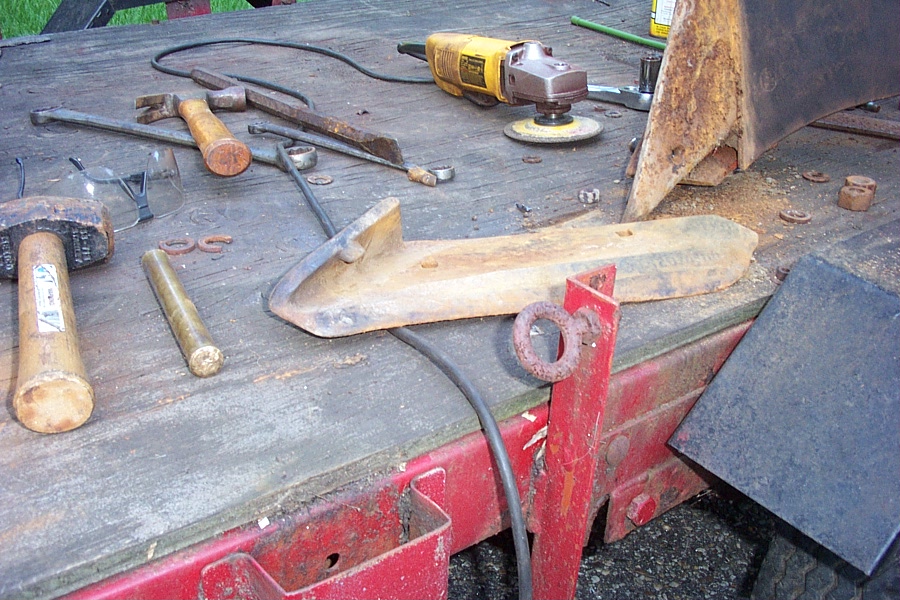

Well I started tearing into the plow last night, for the heck of it I got my Dewalt grinder out and put a wire wheel on it. I cant believe that the moldbaord wasnt more pitted with rust tan it is ! In the first pic you can see what I was able to do in just a few minutes with the wire wheel.
Thank God for Liquid Wrench and cutoff wheels ;) or I would never get this thing apart ! :) Took the front share off, it has some numbers on the underside, one of them being a 12, Im sure representative of a 12" plow. I posted over on the Implement board on YT and one fella called them "blacksmith sharpen type of shares". I also sent away for a manual, so we will see what happens there. The second pic is the removed share, any comments welcome !
Hey Bill, the tail wheel is shot, know anywhere to get a replacement ? The thing unbolts from the hub, it would be a bear to reproduce because of the radius.
