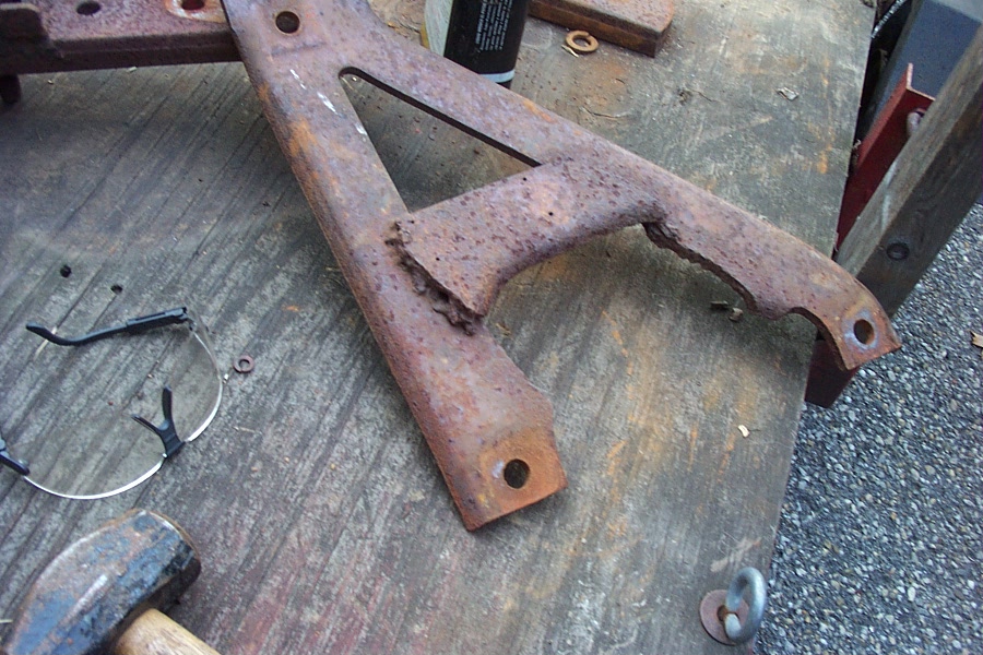

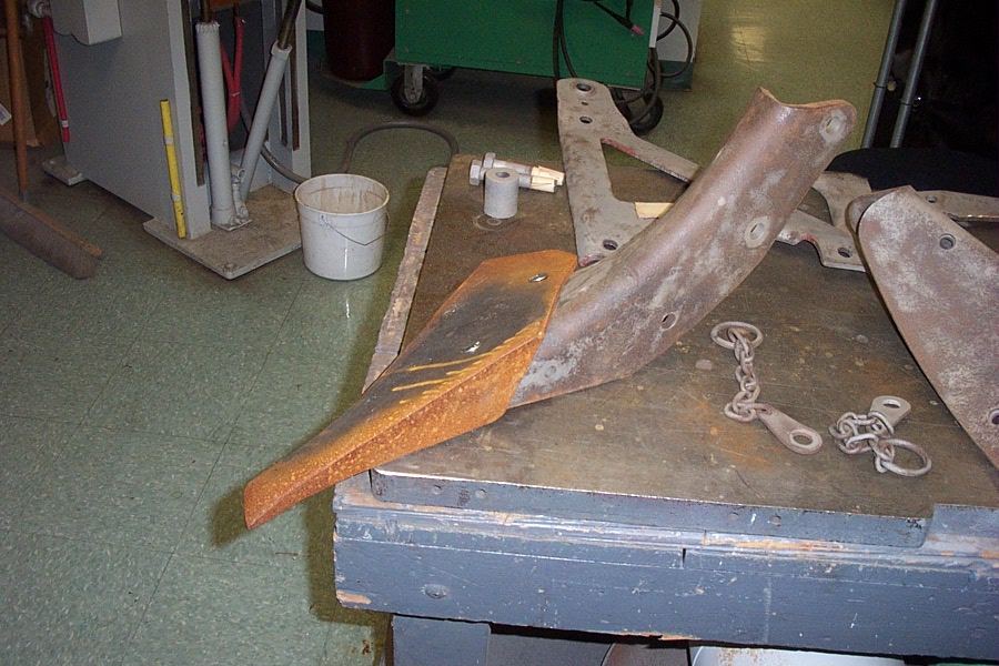

Afternoon Guys,
My new plow shares came in yesterday, now I know how they are supposed to look ! ;) Im not entirely happy with the fit between the shares and the shin ! Im going to have to do a little grinding on the back side of the shares to allow them to mate up a bit better with the contour of the shins. I didnt get a warm cozy feelin when I pull the directions out of the box and they tell you to make some washers out of roofing paper to sandwich inbetween the share and the shin ! :( So the first two pictures are different angles of the share. The third pic is the adjustable arm frame that Im in the process of repairing. Apparently the lower crossmember was torch cut and rewelded higher on the frame to accomodate some barn yard mechanics attempt of relocating the coulter frame ! :confused:
Im not sure about this cast share, this may turn into a lawn ornament yet ! :)

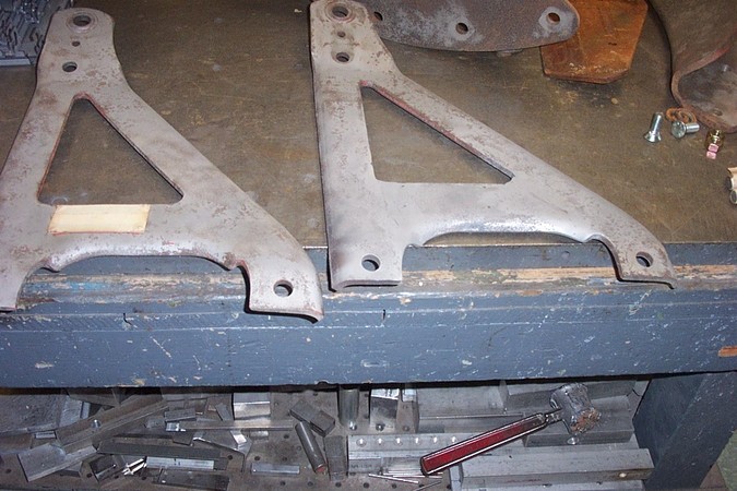

   / Ferguson Plow... Opinions #69
scott_vt said:
Afternoon Guys,
Howdy Scotty!
Movin' right along there! Good lookin' job so far. You talk about not getting a warm fuzzy feeling....? You aughtta read the parts manuals to an old Ferguson plow. Those shims were originally ASBESTOS. The parts manual for my #66 MF plow gives part#'s for several shims, all listed as asbestos. Needless to say, they're obsolete and no longer available through AGCO.
Bill
   / Ferguson Plow... Opinions #70
Hi Scotty
The arm looks real good. At least they didn't cut the cross brace shorter to try to make it fit between the uprights. I'll have to come down and see it when you move it up to VT.
Al
