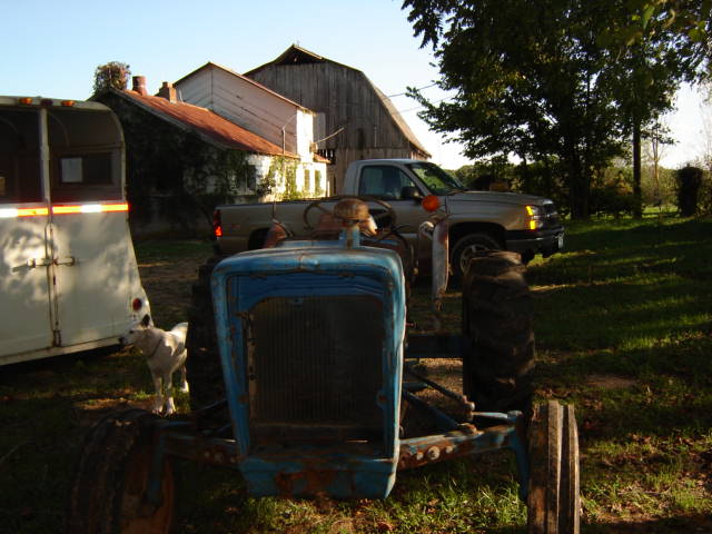

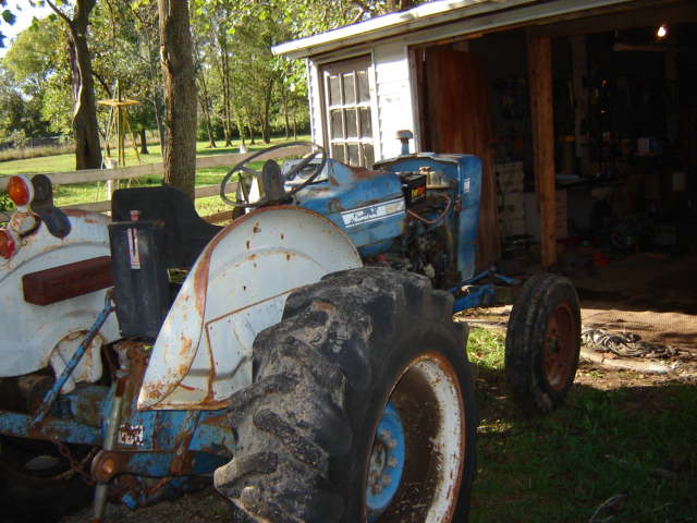

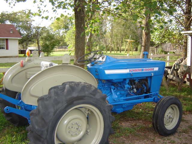

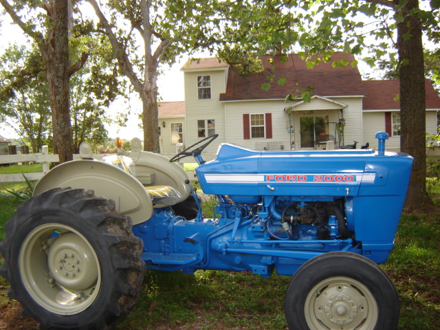

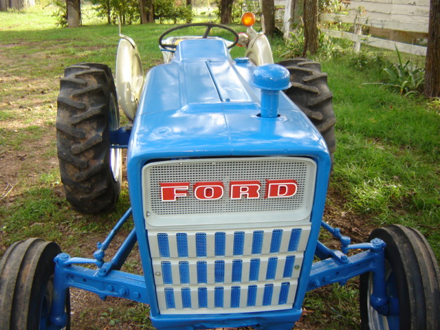

I completed a Ford 2000 here are some pictures. DSC02033.JPGDSC02034.JPGDSC02035.JPGDSC02037.JPG017.JPG016.JPG010.JPG

What a beautiful Ford! Love that blue and grey combination... Our little fergie has taken the back seat for a while, as we have had some big problems with vehicles we need to keep running, but slowly we are making progress. We have quite a bit of rust in the lower part of the front grill inserts. steel gone completely in patches. Mike and I are deciding right now about the solution, to just buy reproduction parts that are not very expesive, or bend up some sheet steel and do the old cut and trim and weld. We now have a wire feed welder, the kind that used shielding gas, not flux-core wire type. One of us will need to do some practicing and figure out how to use it for this sort of welding if we go that route. Part of me wants to repair the original pieces, for both the originality aspects, and the idea of learning a new skill..in the old days my Dad used oxyaceteline gas to patch-weld sheet steel and showed me a bunch of tricks on how to do it well...starting with a perfect fitting patch that has essentially no gaps. I have seen Stacy David on TVs "Gearz" weld a sheet steel patch with a wire feed welder, and how to do that with a less than perfect gaps....hence my interest in learning how. Next sprng we pull the wheels wet-sandblast them before new paint. We bought a sand siphon tip for our water pressure washer...works like a charm if the sand/media is dry and can easily flow up the suction tube. It mixes the sand with the high pressure water to cut fast, leaving no dust. Works to remove grafitti from concrete too. It will make stripping the big castings next year a real breeze. We found a shop that can take the engine that is seized, and do the magic to loosen it up and hone the cylinders in a real machine, not a hand-drill hone like we have in the tool-box. We are hoping that we don't need to bore, as that will mean new pistons...but it shall remain a mystery until spring-summer 2013 when we remove the engine to start that part of the process....Our goal is to start re-assembly to run in summer of 2014....taking our time, doing the project with spare-change, so to speak, but we are both having fun and enjoying the process, even if it taking much longer than we had initially hoped.
Congratulations on the Ford 2000.....I just love small tractors like these! Makes me want to do a 2 tone paint on our Fergie.....it was all grey, so plain....the later ones were 2-tone, and it sure is tempting to put a later period paint job on it..they really come to life with 2 colors like your Ford.

Thank you very much for your kind words, I had a lot of enjoyment bringing the 2000 back, sort of a love hate thing when your working on a project, however, the end result is well worth your effort

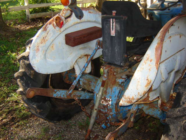

More pix
Here you can see the 'shadow' of there the headlight mounting hardware was, note the high and low tail one side VS the other side
I noticed the shadows left by the headlight light wings. They have a backing plate that helps bolt on the headlights. Here's a picture of mine before I installed them. They are common to early ford and ferguson tractors. One was mounted upside down. There is a right and left wing.
I've seen these for sale on ebay with the backing plates. If you buy some make sure you get the small bolt that screws into the back rear of the wing for each side. -robert

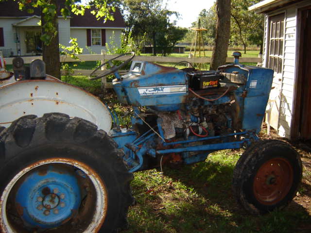

Ferguson TO-20 Restoration
This project will take a long time to get done, as it will be a "here and there" effort as time and funds are available. I thought I would start by sharing a few photos I took of the Ferg today. We have already removed some parts to start cleaning and painting, but the bulk of it is still all together.
This is a 1950, according the serial number sequence list that I have.
I have some more details that I'll post later, and also some questions , so if we have some Ferguson experts out there, please stay tuned to this thread!
Jennifer [ and Mike ]
