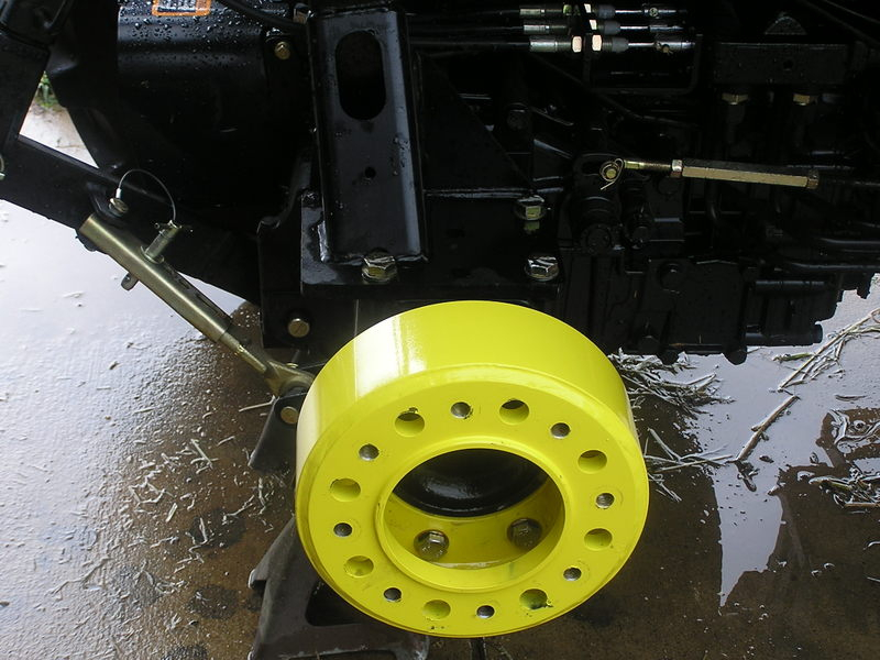

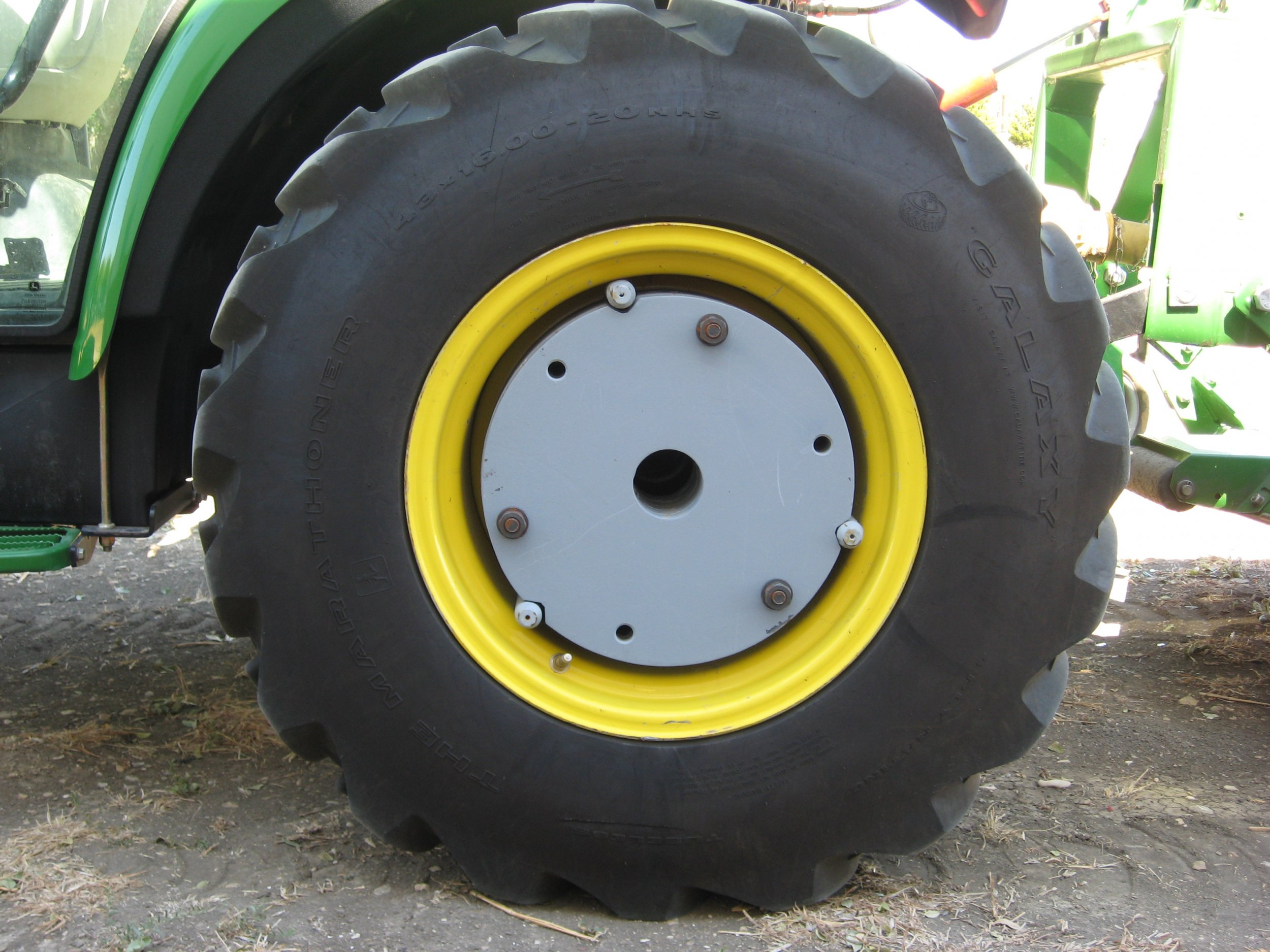

I did not want to fill the Tires with any type of liquid. So to make up for the ballast weight that I lost by not adding Liquid Ballast in the Tires I designed and made my own removable wheel weight out of Steel Plate. By doing this I
was able to achieve the same added weight as the Factory Weights and the Liquid Ballast and have them easily removable.
I also added 6" Wheel Spacers to help with Stability when I am working on slopes.

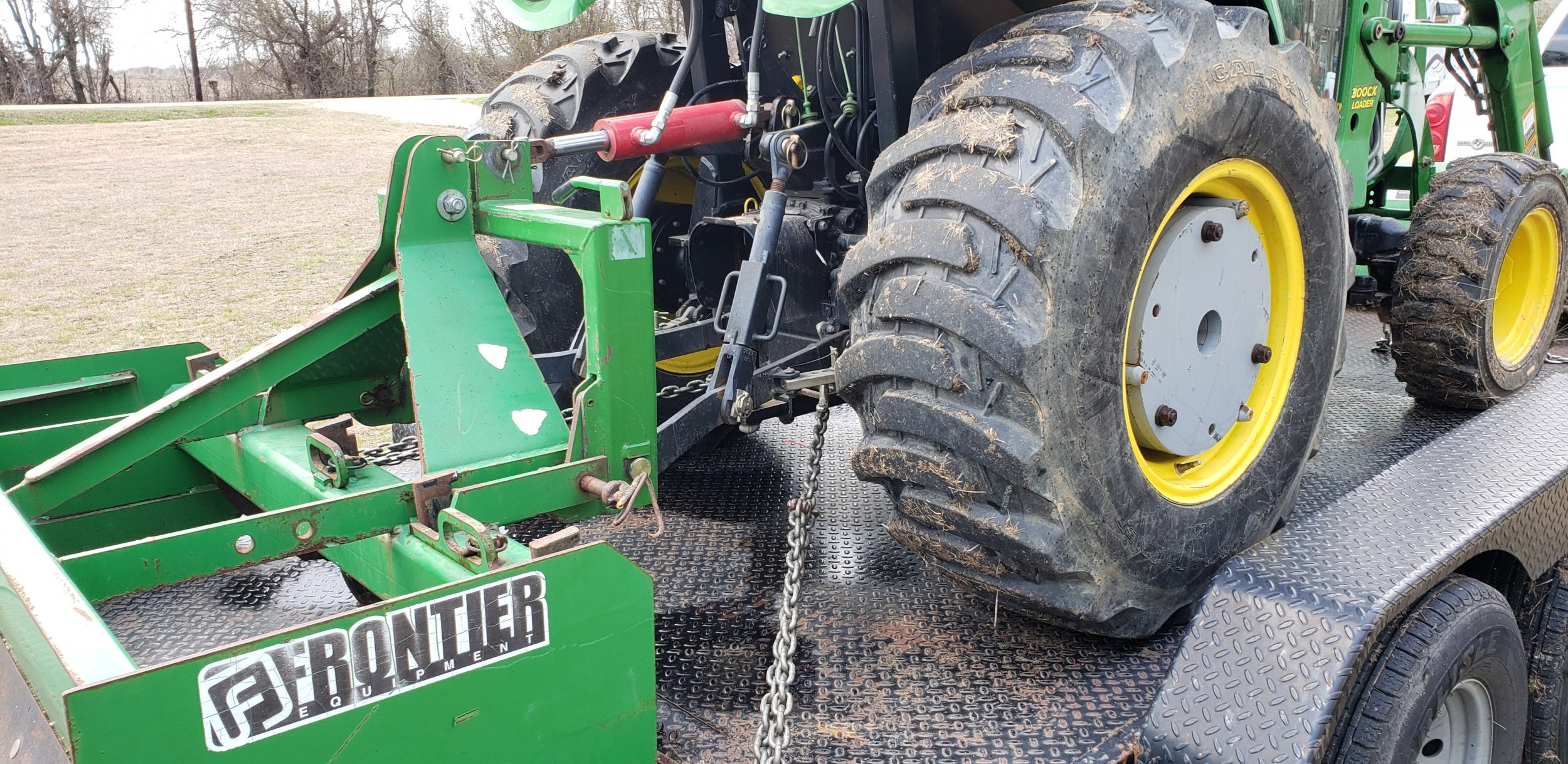

Additional Pictures & Drawings of Wheel Weights
Also JD has a Ballast Calculator which I have attached a example of.
Also Wheel Spacer Brochure & Liquid Tire Ballast Tables
