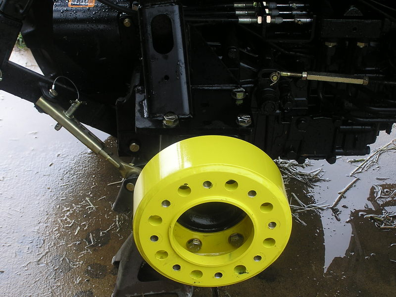

I have a John Deere 3320 Cab Tractor with a 300CX Loader, because I mow with my Finish Mower I was concerned with making ruts in the Lawn.
The tractor came with R4 Tires and the Finish Mower mounts to the rear on the 3 point hitch. I also have many other implements that I use with it, Rotary Cutter 5' & 6', Tiller, Box Blade, Land Plane, etc.
Since my tractor has a cab it tends to be a little top heavy.
I did not want to fill the Tires with any type of liquid. So to make up for the ballast weight that I lost by not adding Liquid Ballast in the Tires I designed and made my own removable wheel weight out of Steel Plate. By doing this I
was able to achieve the same added weight as the Factory Weights and the Liquid Ballast and have them easily removable.
I also added 6" Wheel Spacers to help with Stability when I am working on slopes.
I also suggest that you get the Ballast Box to use when you are not using other rear mounted Implements and fill it with heavy Scrap Steel Items then fill the rest of the space with concrete.
Also make sure You get the Quick Hitch this makes changing out Implements so much easer. I would suggest that you get the Factory I match hitch since you are looking at a JD Tractor, some of the other Quick Hitches do not work as well. I tried a Harbor Freight hitch when I got my Tractor and had to do modifications to the mounting points to hook up some of my Implements. Also the Drive Shaft would hit the underside of the Hitch destroying the drive shaft shield.

Additional Pictures & Drawings of Wheel Weights
Also JD has a Ballast Calculator which I have attached a example of.
Also Wheel Spacer Brochure & Liquid Tire Ballast Tables
