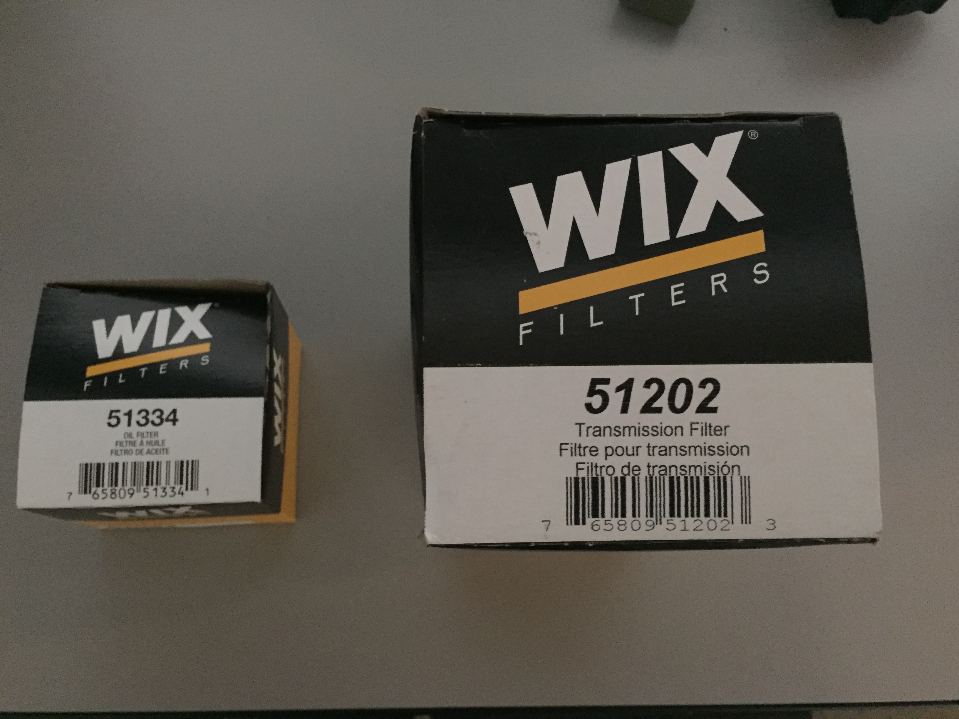

Hi Everyone,
Didn't get a pic posted till later, but here it is. New Tractor.
I am at my 50 hour service. I bought the 3520h and am trying to find filters to buy for the service. I saw someone posted that a Wix 51334 will work. I bought it. Looking at it, it looks like it is way smaller in diameter and shorter. I am concerned that this doesn't filter enough. Any suggestions? I don't even see anything on Bransons site about getting an oem filter anywhere. Any ideas?
I purchased a Wix 51202 for the Hydraulic filter. This looks like it may be smaller as well? I hate to pull the old one off and this one not be right.
I would rather purchase local unless I know for sure that an online purchase will work. Any suggestions?
Sorry if there are posts concerning this, but I searched and didn't think what came up IMG_1131.jpgIMG_0045.JPG
My tractor came with an STP 2903 oil filter,
and I've just been buying anything that crosses to that number.
These small diesels do not have a very high flow oil pump.
The oil filter will not be "too small".
From this thread: http://www.tractorbynet.com/forums/century-branson/370407-oil-filter-4720ch-2.html
Wix 51344, 51083 or 57046 .... (just chop off the "5" and now its a Napa 1344, 1083, or 7046). Same filter.
Wix 51347 & Napa 1347 Oil Filter
WIX 51626.
Champ PH2903
VALVOLINE VO52
AC-Delco PF57
STP S2903
Fram PH9897
Luber-Finer PH2903
PUROLATOR L17662
Wix now lists a replacement for the EA00001160B Kukje filter: WL7237
UPC Number: 765809287280
These filters are ALL pretty big, and have M20 x 1.5 threads:
Baldwin B202
Fram PH3985
Baldwin B141
Mobil 1 M1-207
