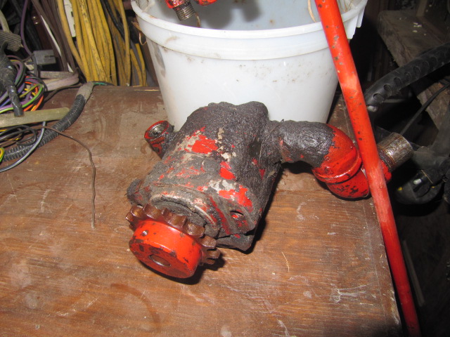

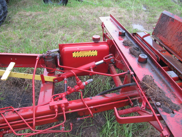

OK! I picked up a card reader on sale at London Drugs and tried it out on the photos I had taken. Of coarse they were too large a file size to allow more than one on the post:(. Took a closer look at the settings in the camera and found it was at the highest grade for quality shots. No wonder! I've set it for taking photos to be sent by e-mail and let's see what happens now!

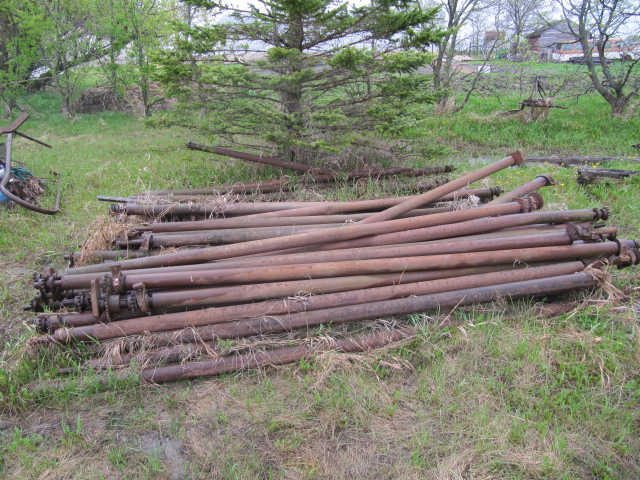

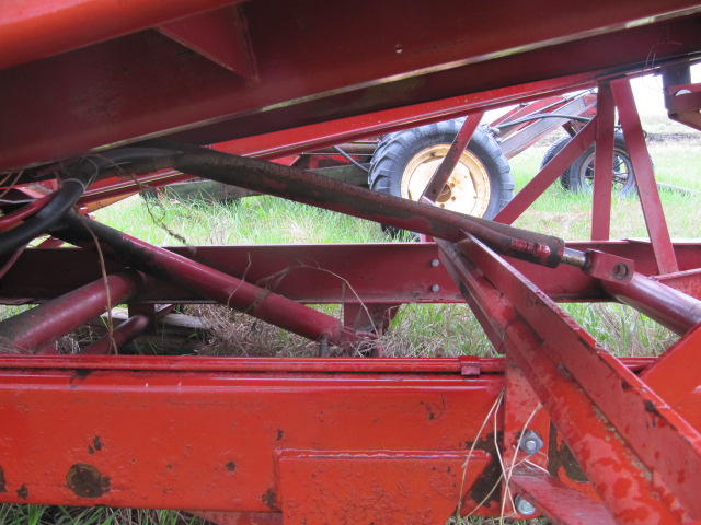

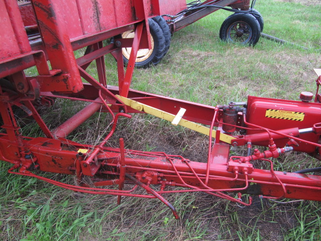

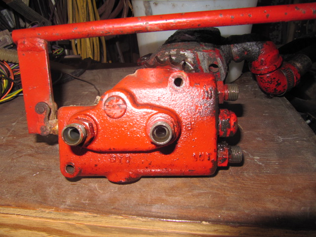

SCORE!!:thumbsup: The first one shows the tank and filter I can use for the hoe. Also, that short cylinder looks to be about right for swinging the boom. 2): The only other cylinder I expect to use for this build. Rather long, but I'll try to use it for curling the bucket. Any advice on how to prevent damage when the machine structure has reached its limit but the cylinder has travel left? I'm thinking some kind of bypass but that might limit digging capability. Thoughts? 3): Shows a lot of the hard line I plan to salvage. The joints are all mechanical fittings. Does that limit the range of usable line pressure? 4): Iplayfarmer: this shows about the only pieces suitable for beams of any kind and regrettably they are 3/16". I don't think that is rigid enough. The only way I can use them for structure is to close the open side with some flat steel welded in. Better I use something already closed like square or rectangular tubing. 5): Does anyone see a boom and dipper in this pile of steel rollers? These were left behind by the previous owner and some have 1.5" steel shaft going right through the full length. The outer shell is 1/8" x 3". 6): The pump. Iplayfarmer: I think you had some other kind of pump in mind when I said this was PTO driven. The sprocket you see has 15 teeth. The sprocket on the PTO shaft from which it was driven has 30 teeth. The operating RPM would be 1080 RPM max. I'm not sure what the output of this pump is yet. I'll probably have to measure it because it looks like the ID plate was a stick-on and has not survived years of soaking from hydraulic fluid seepage. 7): One of the valves. I'll have to find out if it is single or double acting. The loader had one single acting cylinder and the others double.

   / Finally Building my Backhoe #143
Norm,
There are several ways to limit stroke of the cylinder. My solution would be to attach the cylinder such a way that when extended it will bottom without putting necessary stress on the bucket mechanism. Then you could put stops on the stem to limit its stroke when retracted.

   / Finally Building my Backhoe #145
Norm,
I thought of that first but I threw the bypass idea up as a trial balloon in case someone could advise one way or other. So, do hydraulics suppliers sell something to clamp to the stem? I would also guess that the portion of the stem that never gets to go to the sheltering environment of the inside of the cylinder would need to be coated with grease, or some such.
