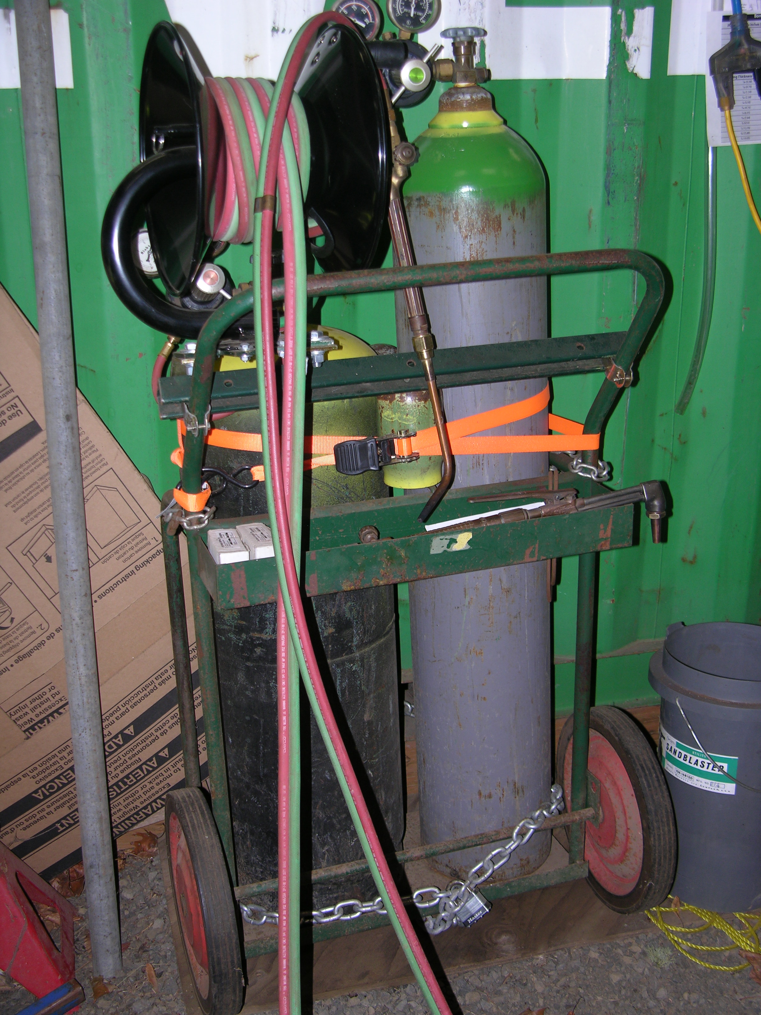

I see you are using nylon straps to hold your cylinders in place, should the Acetylene cylinder heat up, it will melt those, and you'd have 2 cylinders possibly falling out of the cart, and having the valves knocked off.. not safe.. you should back that up with a metal chain so that can't happen.. "things" happen..

"I see you are using nylon straps to hold your cylinders in place"
Take a closer look - the chain is there (in ADDITION to the steel bottle clamp that cart came with), the straps are just 'cause I HATE things that rattle -
Also, the MAIN thing that keeps Acetylene from exploding at over 15psi is the Acetone - the "glorified porous concrete" fill in the tank is there to help slow acetone from escaping the tank - as I understand it, tanks are completely drained (including acetone) then a calculated amount of acetone added, THEN they're filled to pressure. You never know whether somebody followed the rules (or even knew about them) so that's the ONLY way of ensuring that a tank has enough acetone to keep it safe...
I agree about the backfires; it's kinda hard to see, but if you zoom in on that pic (click the + sign) that torch (and all my others) have check valves on 'em. Plus, that location is under the modular roof I built, and NEVER sees the sun...
Without the acetone, that same tank would get filled ONCE before the resulting explosion would make the news... Steve

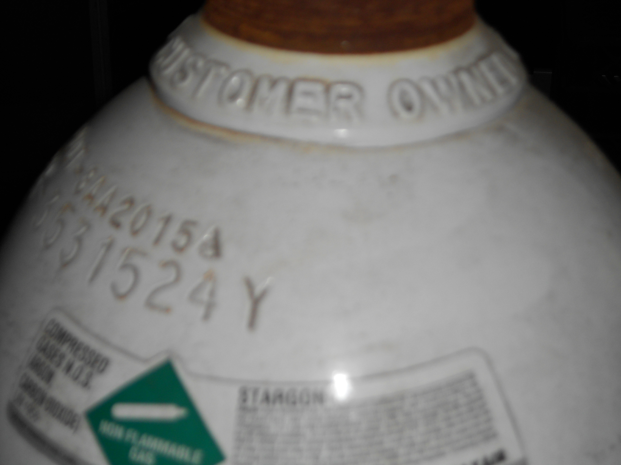

I took MY medium tank of 75/25 in to get refilled and the counter guy could not find a full medium tank so he ask me how about if I give you a large one?
I ask will I still own it?
He showed me the "customer owned" ring on top!
I think he even gave me the gas at the medium price.
I have always owned my own tanks.
Another tip- if I come across an empty rental tank that was "borrowed/lost" I will return it and tell them where I found it.
If it is my supplier I have had them give me my fill for free.
Not my supplier I ask if there is any reward for returning and have been given $25. or store credit for supplies.
