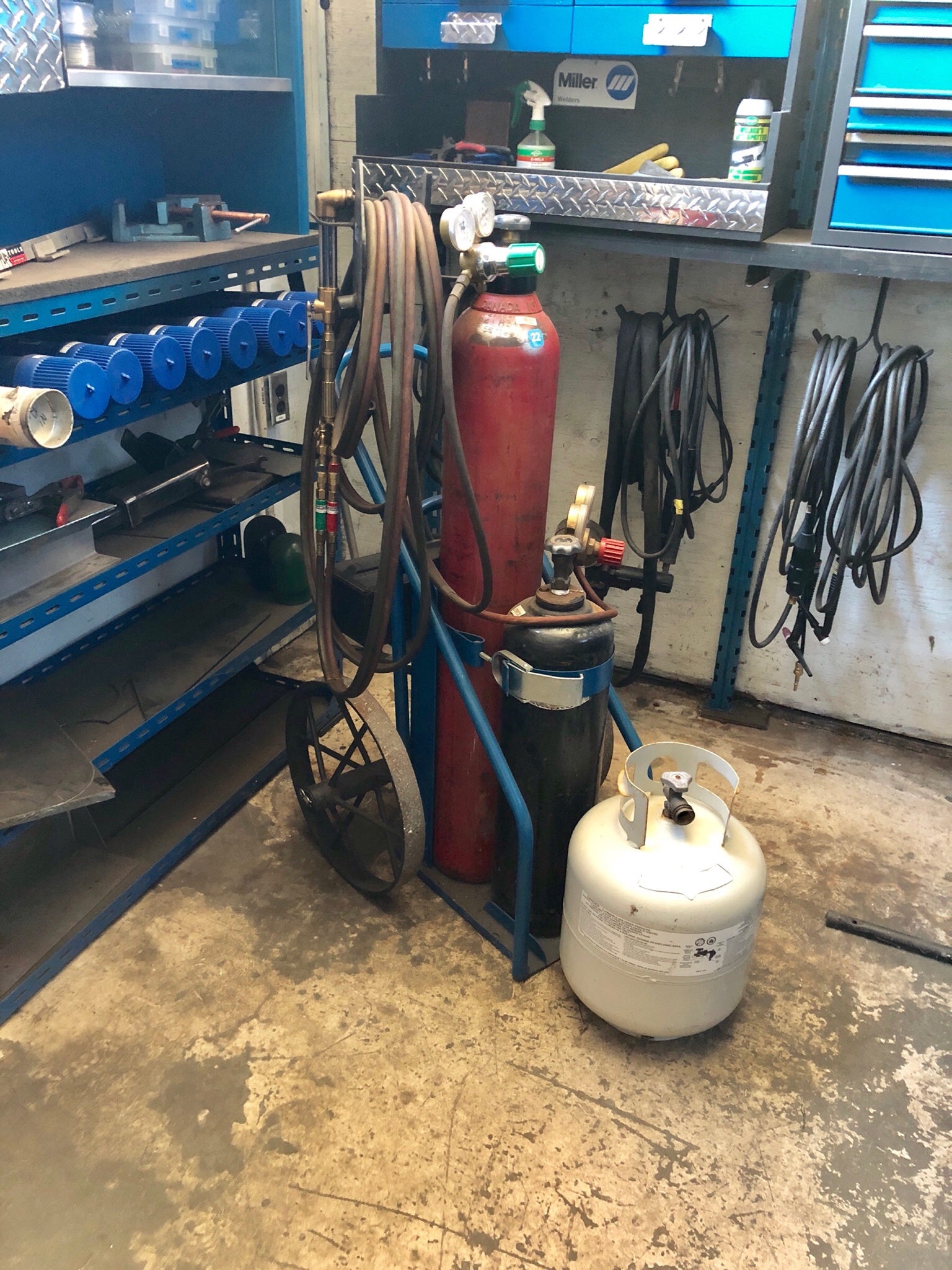

Got any photos? I am looking to make a tank cart for my 125cf O2 and grill propane tank, but it isn't working in my head very well what it would look like...
   / Finally Ditching the Oxy-Acetylene Tank Rental
#30
I have a few tanks of acetylene on hand and don’t really use that much but the day is rapidly approaching where I will also have to remod my cart to accommodate a propane tank.
We’ll have to wait and see which entity runs out first -acetylene or me. Possibly BOTH at the same time
