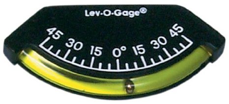

Sjmarbu: Any idea where purchased/price like it has fore/aft as well as side/side. Thanx PR

slmarbu: Found it duh amazon $17 + s/h Thanx Should have tried there first
   / Finally got a inclinometer
#15
Sun Company 201-F Lev-o-gage Inclinometer and Tilt Gauge: Snap Gauges: Amazon.com: Industrial & Scientific
this is the one i got except mine just goes to 30 degrees, ive seen these on boats and other tractors plus mine has been rained on a couple times so im thinking its waterproof.
