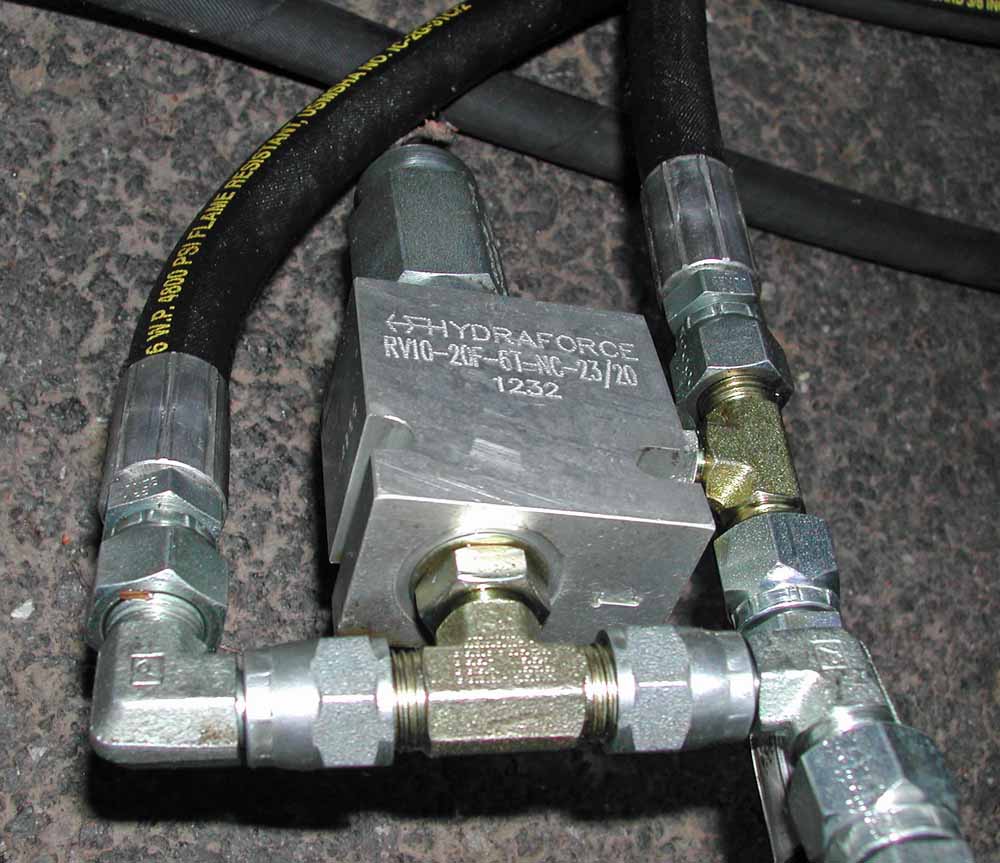

There are several solutions available. A small relief valve connected to the rod side and vented to the bore side would work. The problem is that a small valve needs to be put into a connection block, which greatly increases the size. Not a large as an earlier posed pix, but like 1.5" square by 3" long is approx. Also a PO check valve could be used. This would be blocked until piloted open by pressure tapped off the bore side. Again the connection block gets large again. perhaps there is a smaller relief/connection block available. One would need to search.
Paul
   / Finally, Hydraulic Backhoe Stabilizer Locks, Lift and Lock, #67
While I just use a piece of heavy chain between them when up
(hydraulics can't break it, and impossible to forget....it's in my way... and what's another chain laying there. handy for chaining the bucket to something too)
Your idea sure looks good and with techmans warning, you know to not forget.
If you have a lot of parts, just adding another shutoff to the other line too would solve it.
Locks the cylinder and if you forget, just deadheads the pump into relief in either direction.
Another idea is some old tractors have 'diverter valves' after the main control valve.
2 lines from the pump/valve in, 2 out in position A, 2 out in position B.
Putting plugs in position B and your cylinder lines in position A, and you are good.
Park it, turn it to position B and the stabilizers are locked up, and both lines are deadheaded into the plugs in position B if you forget.
   / Finally, Hydraulic Backhoe Stabilizer Locks, Lift and Lock, #68
If an RV is used in conjuntion with a ball valve in the rod end, then they can be fairly small, and does not have
to be installed near the cylinder itself. Here is a Hydraforce RV that I ordered with a fixed 2000psi relief setting,
and the shipping was more than the valve itself cost. Since the outriggers are intermittantly used, you can
size these units fairly small.
I used this crossover RV with two of my hydraulic chainsaws.
