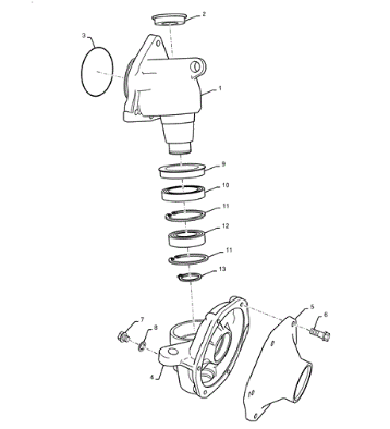

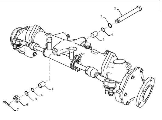

It may not be as easy as popping off the tire and replacing the seal. Looks like you have to dismantle the steering knuckle to replace the oil seal.
Front axle
Steering knuckle. #9 is the oil seal.
