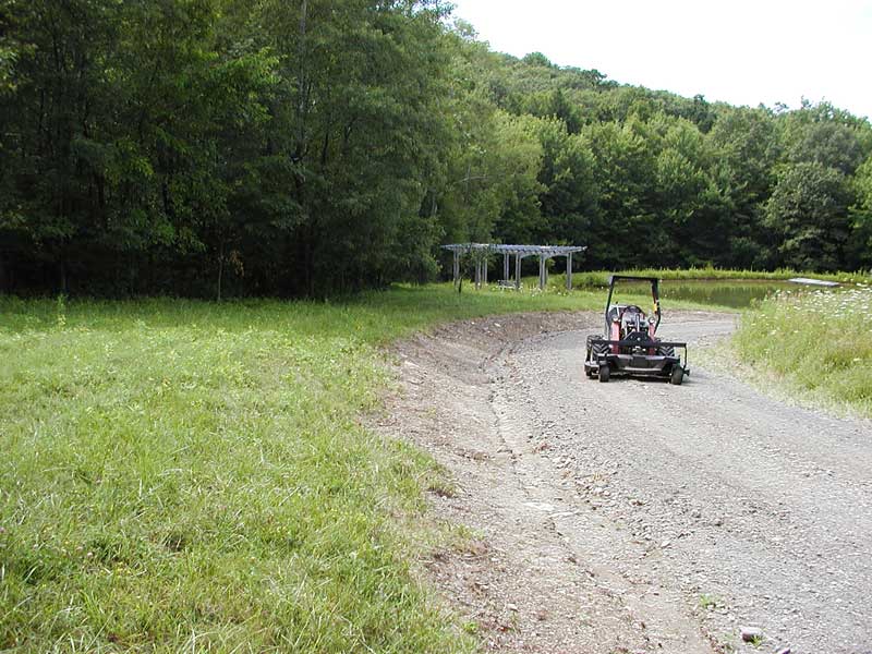

It sounds as if the offset on my blades isn't needed with the deflector off. How high did you have the deck set for the cut in the picture?

<font color=red>How high did you have the deck set for the cut in the picture?</font color=red>
One hole down for rear wheels, 4 spacers down for fronts.

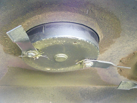

<font color=red>When you get a chance, post a picture of the blade(s).</font color=red>
Attached. With the twist these blades are cutting probably 1/2 inch or so lower than the stock roughcuts. Note the "swept tracks" on the bottom of the deck. I must have a close look at them to see what they might tell us about what is happening under there.
<font color=red>Since they are reversible, I assume you center drilled them. How thick are they?</font color=red>
1/8 inch thick. They are cheapies from Home Depot. Box has a Scotts label & says "22 inch Reversible Double Edged Blade".

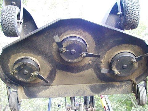

<font color=red>Note the "swept tracks" on the bottom of the deck. I must have a close look at them to see what they might tell us about what is happening under there.</font color=red>
Here's a picture of the bottom of the deck after mowing grass and 12 inch weeds for an hour or so. later I went out and finished mowing my test plot which swept the bottom of the deck clean except for just a bit of stuff left around the stump jumpers. Not much to be learned here I guess, the 'swept tracks" are pretty uniform.

The first post in this thread has a picture attached comparing the PT rough-cut blade with one I made by cutting a Gravely blade in half and getting a 1" hole drilled in it. I did some comparison testing, which was reported earlier. and Sedgewood (John Coxon) made up some blades from thinner lawnmower blades and did comparison tests with mine. He then sent me a set of his, and I did some mowing with both.
The result, John's blades are the best so far. They beat the factory blades and mine in each type of mowing I did. With the deck at its lowest setting, they do a finish cut that is acceptable on my lawn - but not Bubenberg's customer lawns or golf courses. Set a little higher, the blades do a good smooth pasture cut, with almost no missed area. The factory blades, and to a smaller extent my blades, leave a stripe and some tufts.
The attached photo shows one of my blades and one of John's, with his on the right. His is reversible, and has the whole blade area twisted, so the whole blade outside the stump jumper lifts. Mine has a level leading edge, and bends up at the trailing edge, also creating lift, but not as much.
