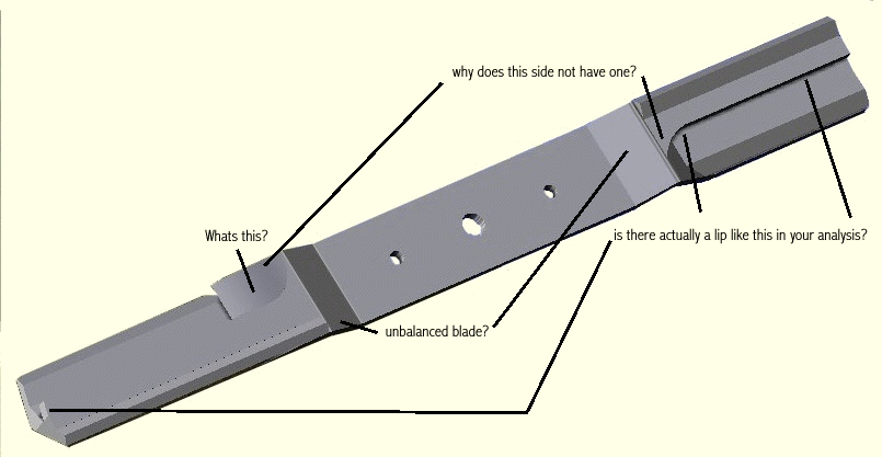

Hi All. Nomad emailed me asking to contribute to this thread. So here I go.
Gilmore Engineers is a consulting Engineering company. One of our repeat clients has been a local Lawn Mower Manufacturer in Australia.
About seven years ago, before I was working for Gilmore Engineers, Gilmore Engineers were asked to help with a performance problem that they were experiencing in Europe. The grass in some European countries was quite different to our grass, and they were not satisfied with the cutting performance.
We did quite a lot of work researching and testing (your are right, there is very little if anything published on this).
At that time we did some CFD (Computational Fluid Dynamics) analysis. This was limited by the software and computational power of PC's at the time.
We also did a lot of real testing of different blade shapes to see cut quality and also used clear mower decks to see what was happening.
The blade shape we came up with ended up cutting much better and also was much better at picking up and propelling the cut grass into the catcher. They named it the superior blade and now use it on almost all their models (not just the ones for Europe).
In the last few years we have worked on a noise reduction program. The EU has introduced noise restrictions for most outdoor machinery and these will be tightened further in 2006.
The main source of noise is the blades (we did tests to comfirm this). Software and computing power had improved leaps and bounds in the last few years and we were able to use CFD (Computational Fluid Dynamics) analysis much better.
Each blade model ran for almost a week (we needed a very fine mesh on the surface of the blades). We were able to compare the CFD results with actual noise measurement for the superior blade and a flat blade (which was much quiter, but no good for cutting and catching performance).
From the study we learnt alot about the flow around the blades and how this effects cutting and catching as well as noise. We were able to recommend some modifications to the superior blade which would reduce the noise enough to meet the 2006 requirements, and have little effect on cutting and catching performance.
New blades with these modifications have been tested and the noise reduction agreed very well with those predicted by our analysis.
Obviously all the results of the work are highly confidential and this is about as much as I can tell you.
We have not done any work on or for the Finish blades you are talking about.

Hi All.
Interesting discussion your having. After reading some of the comments after my last post, I thought I would add a few things.
The latest study we did on noise generation was done with the aid of the CFD package called Fluent (http://www.fluent.com/).
The mesh size around the blade was very fine because we were lookin at noise generation off the blade surface.
Just looking at the final blade shape we recommended does not give the full picture of the research. We learnt a lot from looking at the flow around all the shapes we tested.
All that said, the customer probably only cares about the performance. Not how it was achieved.
