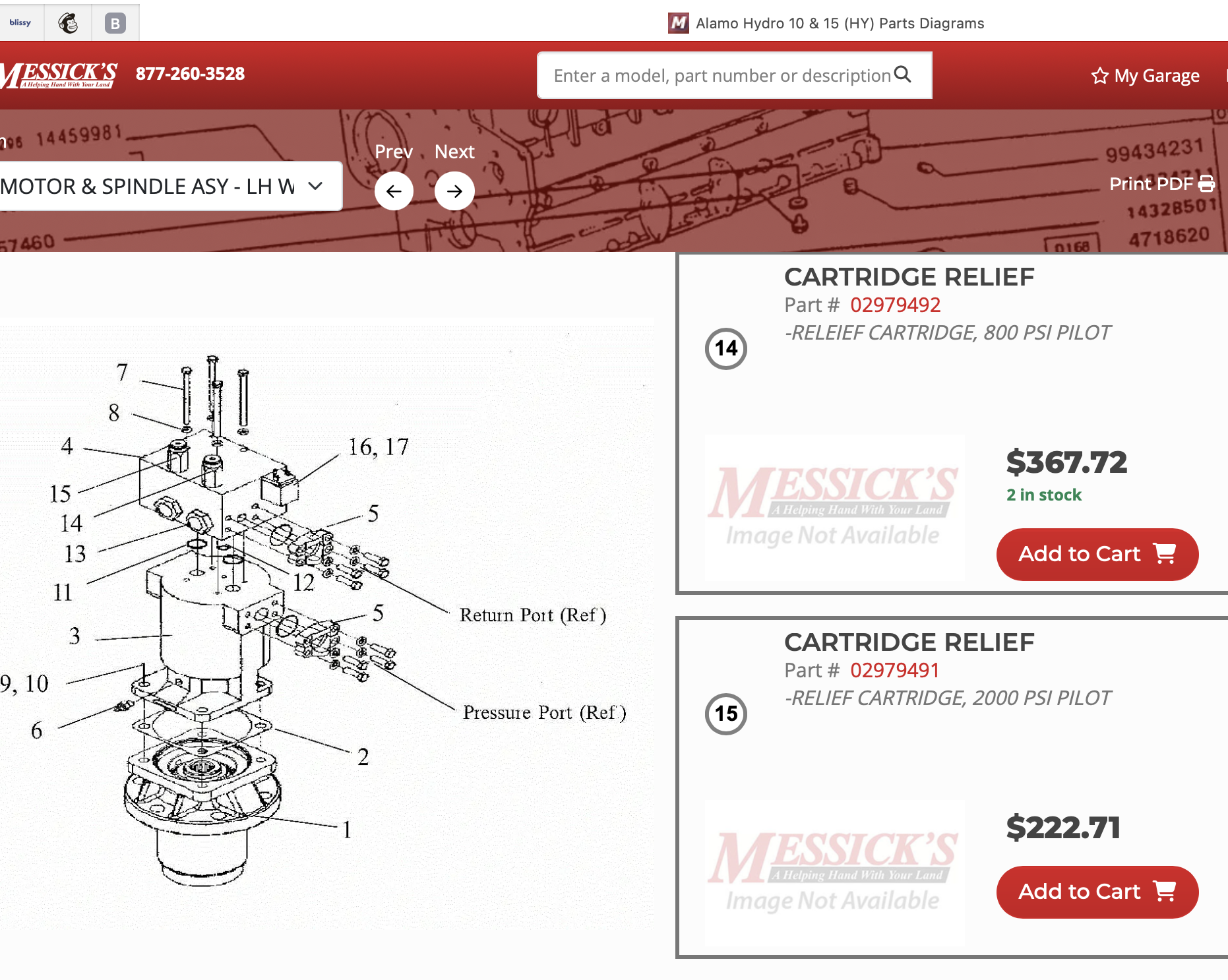

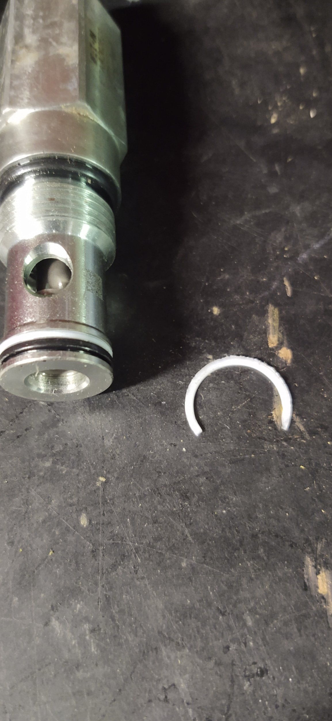

Just took them out. As it happens the two identical were on the wings and the different number was on center so that part was right.
I don't know how much this might matter. The very first O-ring has the little plastic "split washers" (don't really know what they're called) on BOTH sides of the O-ring. I don't know if this is to strengthen the hold of the O-ring or if maybe they actually hold some pressure. I have to believe since they are there, they have a purpose. The first washer, the innermost, the "first" one, was broken and maybe 10-15% of it was missing. It was not a full circle like the others. I was in the (dark) garage so wasn't sure if I saw a dent in the O-ring or not. I'll look later with a good light.
If these nicks DO matter....as it happens, they were on the right wing, the very one that's having issues.
So, fingers crossed that some dufas (er....me) might have buggered it up when installing AND fingers crossed that the hydraulic shop might be able to replace those.
Makes me wonder....when I installed them, I simply pulled old out, put new in. Should I have oiled them? (there was already fluid oozing from the threads when I pulled the old one out so I presumed that would lubricate them as they worked their way in. I'm now guessing that was a bad thought.

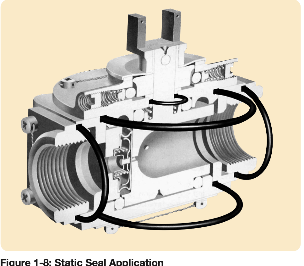

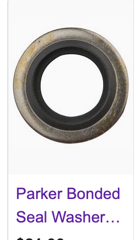

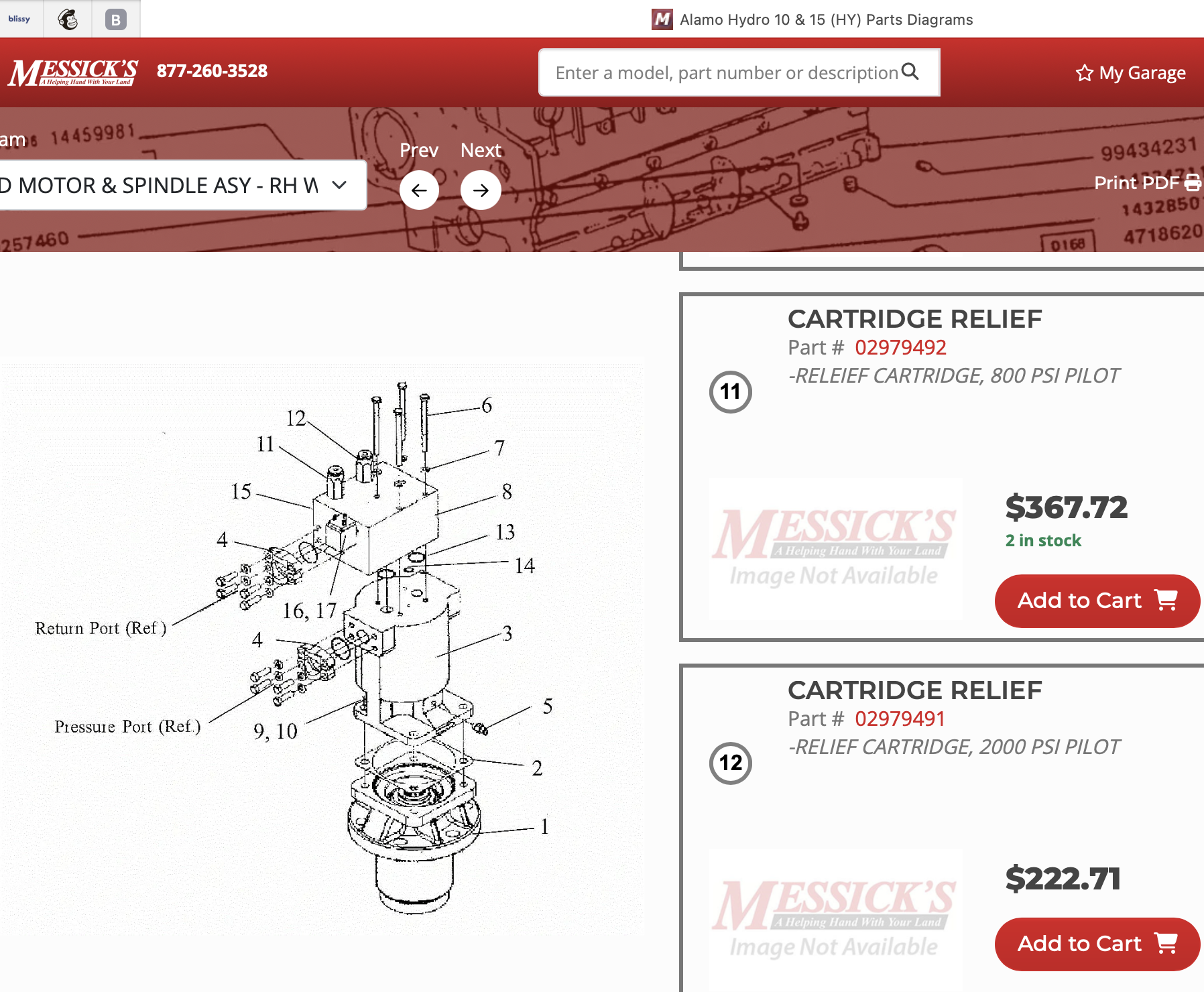

Hard to say. O rings are different from any other type of washer - including flat rubber & plastic washers - because O rings are always compressed into a groove. The more pressure, the better they seal.
But machining a precise O ring groove costs manufacturing money, so back before O rings were popular a lot of machinery from the 50s and 60s and even later used "reinforced washers" where most desgners use O rings today. ....
these reinforced sealing washers were basically flat rubber washers bonded to a surrounding ring of metal or plastic. Is that what you are seeing? Parker and a few companies still make those reinforced washers. I think that McMaster carries them, too. But better be sure what your machine uses.
If the fitting is supposed to have an O ring it will always have a groove for the O ring to expand into and which supports the O ring against blow out. You can see that in the third picture below
I think you are OK on the oiling. Just some assemby oil is all it needs.

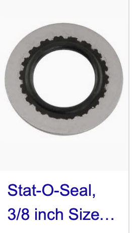

Sounds like he has split teflon back ups on those relief valves. These are typically installed on the low pressure side of O-ring to help prevent O-ring extrusion. 1,500 PSI is about pressure limit for O-ring without a back up.
The this split teflon rings can get pinched on installation especially if they are protruding slightly.

I'd agree. At least he has now found a possible culprit. "We have met the enemy and he is us"...or whatever that quote is.
Not many liked the bonded and crushable O rings - or any of the O ring wannabes with back up rings. Like I said, industry has mostly gone away from them. I've seen them more in instrumentation than in machinery.
If a person owns a machine that uses them, pay attention to the torque and consider that they are best if only used one time & replaced.

I'd say this appears to be my exact situation. Presuming the hydraulic shop (I'm now killing the idea of going to the Deere dealer) anyway, presuming they have these split teflons, I'm going to see if they'll check all of them.

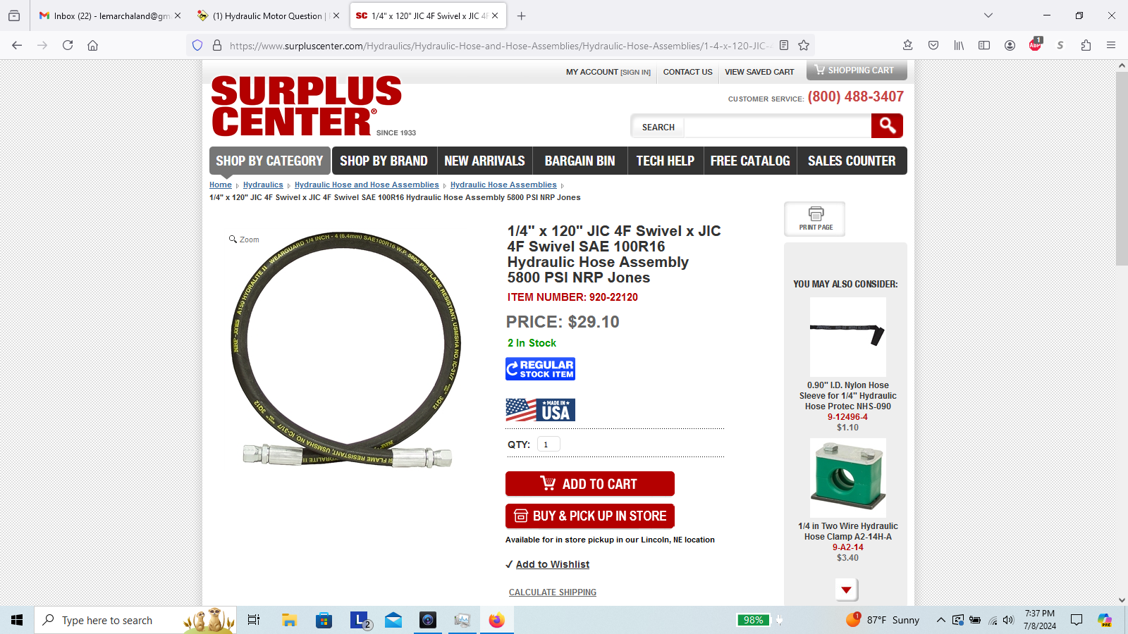

You could get the fittings and a long hose to mount the gauge in the tractor. Just do one at a time or all 3 at one time on a manifold.
1/4" hoses 10 feet long for under $30 each.
Or get real fancy and get pressure transducers (transmitters) and run wires up to a display.
And yes to get to the max pressure you would need to almost stall the motor out.
