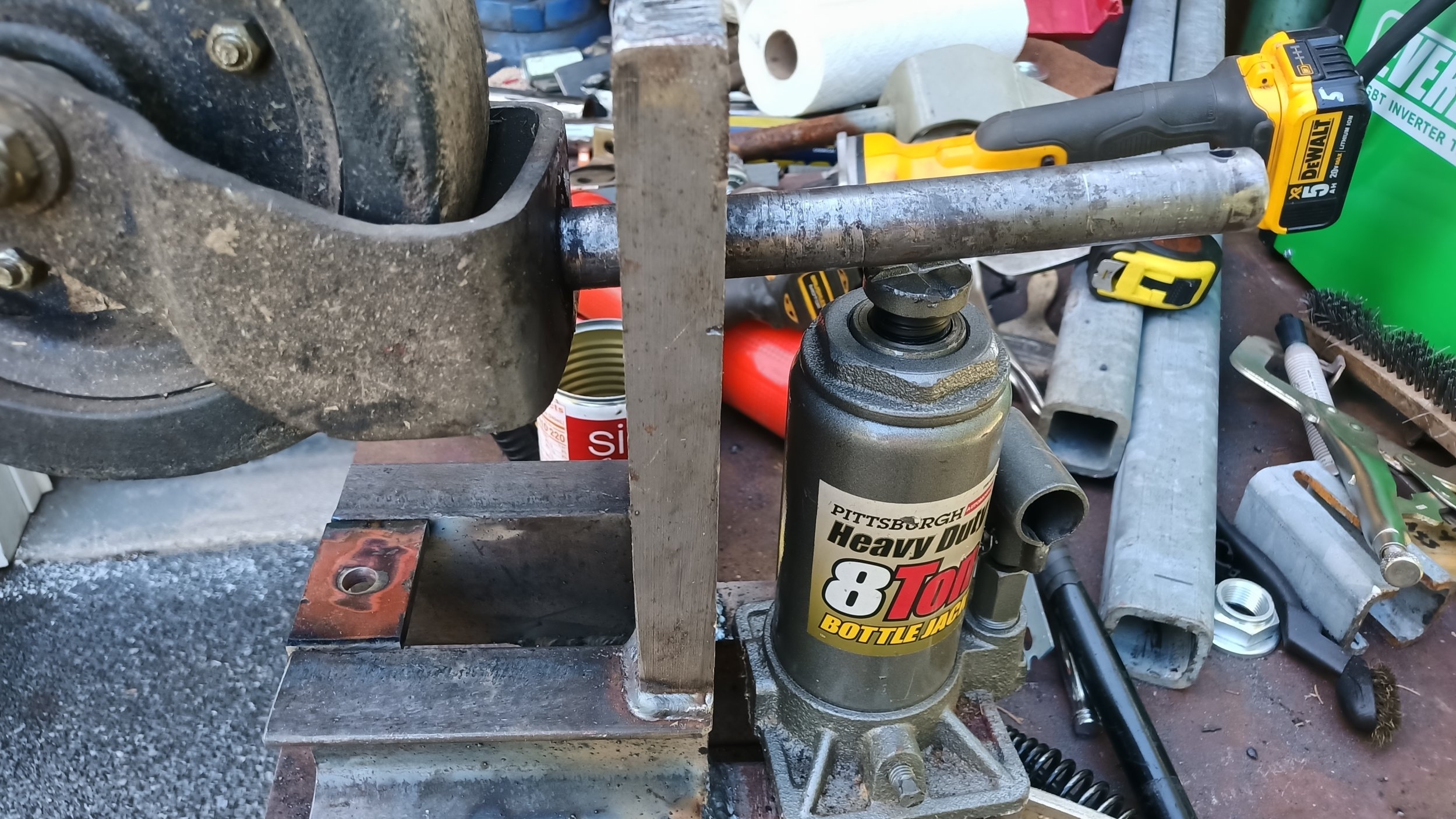

Bending the stem of the yokes was the one weak link on RFM's for me. Been using RFM's since 1991 - a couple LandPrides and a few Caronis. All had what appeared to be the same yokes and wheels. I did buy a couple wheels from Agrisupply over the years, but no yokes. I bought one new 5' Caroni back in '91 and two fixer-uppers (5' and 7-1/2'). I used two 5 footers to make one good 5' deck for the Ford. They have common parts so that gave me some extras pieces. There are wheels with either roller or needle bearings available through different sources.
I made a steel device to straighten the stems of the yokes using a hydraulic jack. Earlier this Fall, I replaced the factory wheel supports on my 7-1/2' Caroni with a homebrew one. The factory support had large upward offsets at the ends that required most of the spacer bushings to be installed between the wheel and the support. With that much leverage I managed to bend the yoke shafts occasionally when swinging the deck over the edge of the driveway or a big root.
The homebrew support is a lot closer to the ground and requires no spacers to achieve the desired cut height. So far it's been working very well.

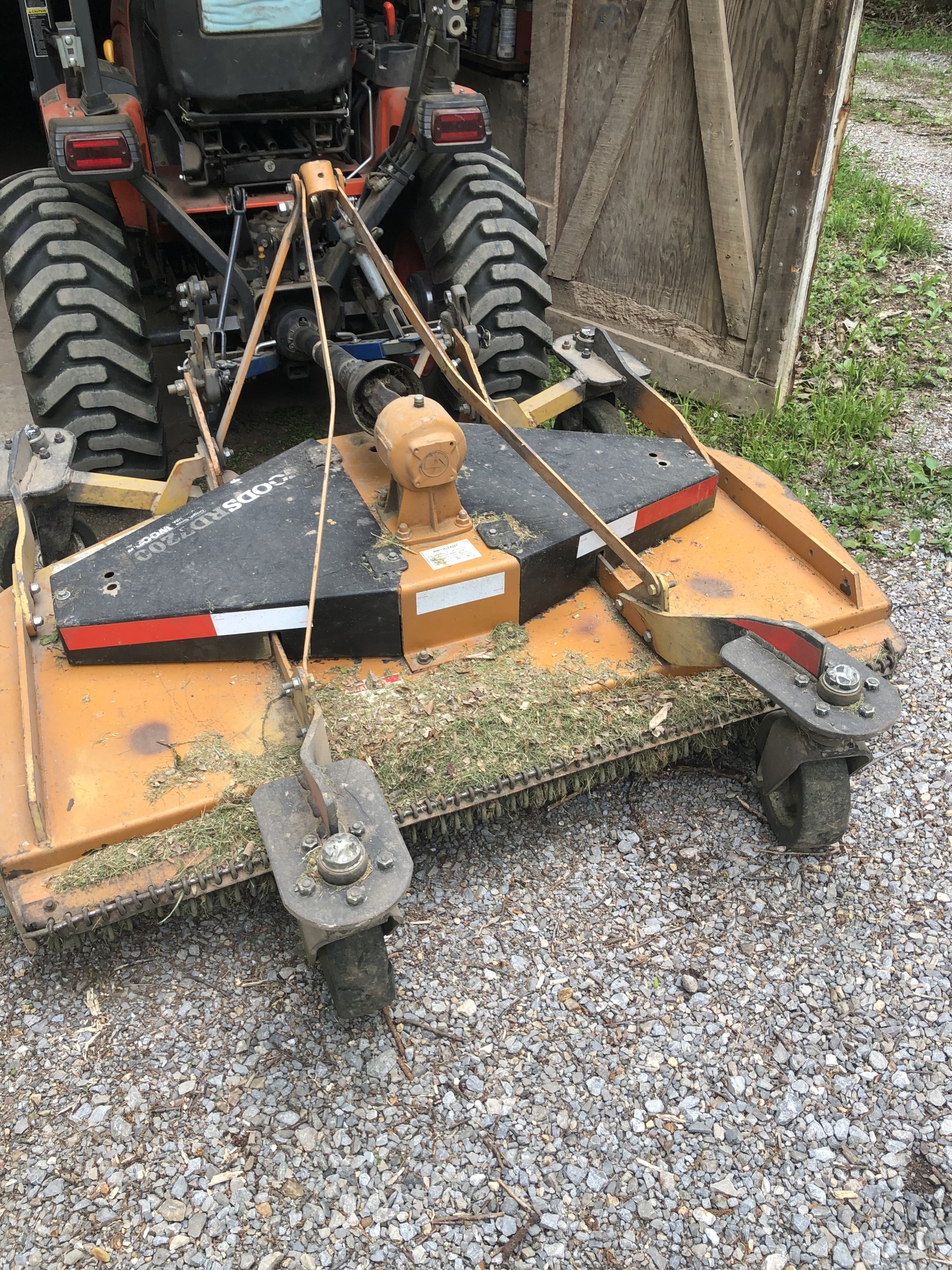

Caster wheels were the weak link on several rear finish mowers. Rough service on hillside farm with a lot of back and forth, roots, rocks, trees, etc.
Eventually replaced the 1” spindles with 3500# trailer axles and hubs. Been trouble free for over 10 years.

Our mowing requires a lot of forward and backing. Puts a lot of stress and wear on the spindles. Coupled with 4x4, sharp turning little tractor is best platform for maintaining our many yards. The Woods RD7200 is 24 years old. Sees about 80-100 hours of use per year. Trailer hubs and axles are much stronger and far cheaper than OEM replacement parts. Even with frequent greasing the OEM spindles and spindle bushings wear out quickly. Slop puts added stress when turning increases risk of bending. Saved almost enough to purchase a Hypertherm plasma cutter used on this one modification. Made fabrication super easy and somewhat fun.
