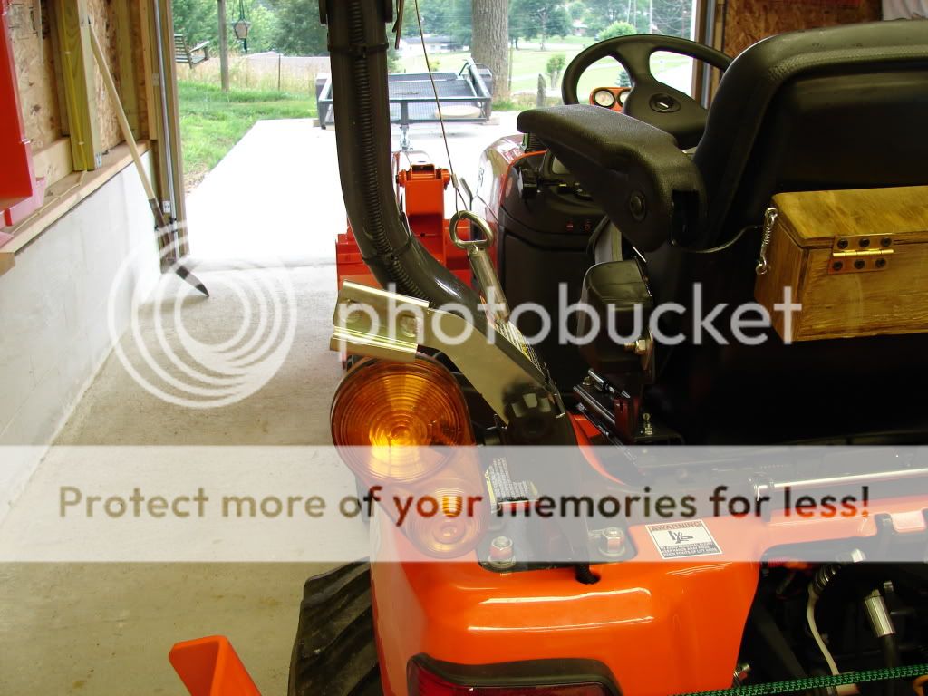

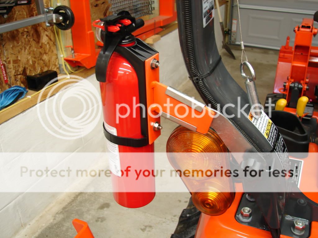

In the midst of another project I performed a "mini" project - Fire Extinguisher. Using the Road warning sign attachment point as the focus for the extinguisher bracket, I made up this quick attach/detach point. The bracket is a snug angled downward fit. Should not vibrate out when in service. The extinguisher is a Lowes $18 ABC type unit. Perfect for this use.
To put on the road sign is a 5 second changeout
Later

Oh, Bracket took 30 minutes to make and longer for the paint to dry :laughing:

The bracket is made from 3/16" steel x 1.5" wide I believe. Look at the sign holder, it is not straight going in but angled in. Grind your bracket back to the shape of a slight arrow enough that engaging it into the sign bracket it holds tight.

This is making me want to add an extinguisher to mine, but I can't see the molded plastic bracket supplied by the extinguisher mfg'er holding up to use in the field. Steel is real.
/ Fire Extinguisher - BX-25 #8
You might want to mount on inside of rops to keep from snagging branch pulling ex off and breaking gauge. Ask me how I know.

I agree- I mounted mine on the inside as well.
