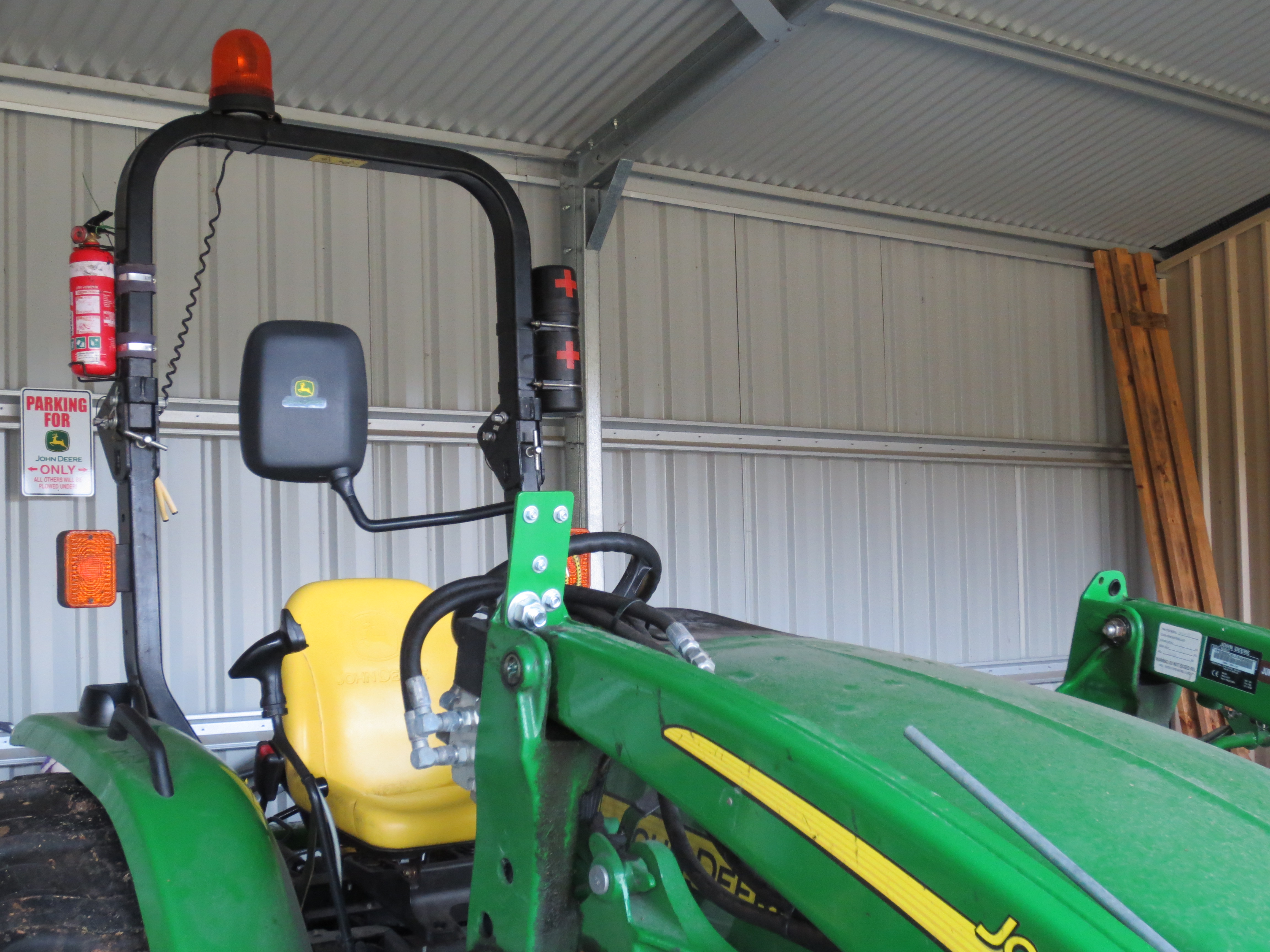

The very first 'modification' I did with my 4105 was mount a fire extinguisher on my ROPS.
I'm on my second, disposable, unit now... not because I've had to use one of them but because tree-limb damage or simple tractor vibration has damaged the gauge. The gauge is the least robust part of an extinguisher.
Due to my Naval career, I have fire extinguishers everywhere around my house and property. :) 2 in the house (kitchen & wood heater), one in the ute, 2 in the workshop and one on the tractor. The only one that I've had to replace was the one on the tractor... and I suspect that the replaced one is still good so it's my second one in the shop.
When I mounted he extinguisher on my ROPS, I used a cut-up neoprene koozie(?) - I think that's what you would call them - to act as a vibration buffer.

About locating your extinguisher. A Jeep caught on fire at a 4WD rally I attended. His extinguisher was neatly mounted on the vehicle roll bar. He rapidly exited the vehicle, turned around and realized that there was NO WAY he could possibly go back and retrieve the extinguisher.
The fire started in the engine compartment but very rapidly there was black smoke & flames in the passenger compartment.
Very few will have the where-with-all to grab the extinguisher as they exit a burning vehicle.
Think about this as you decide where to mount your extinguisher.
I GUARANTEE you will not go back inside a burning vehicle to retrieve an extinguisher and it does no good sitting there on your roll bar as the vehicle burns.
