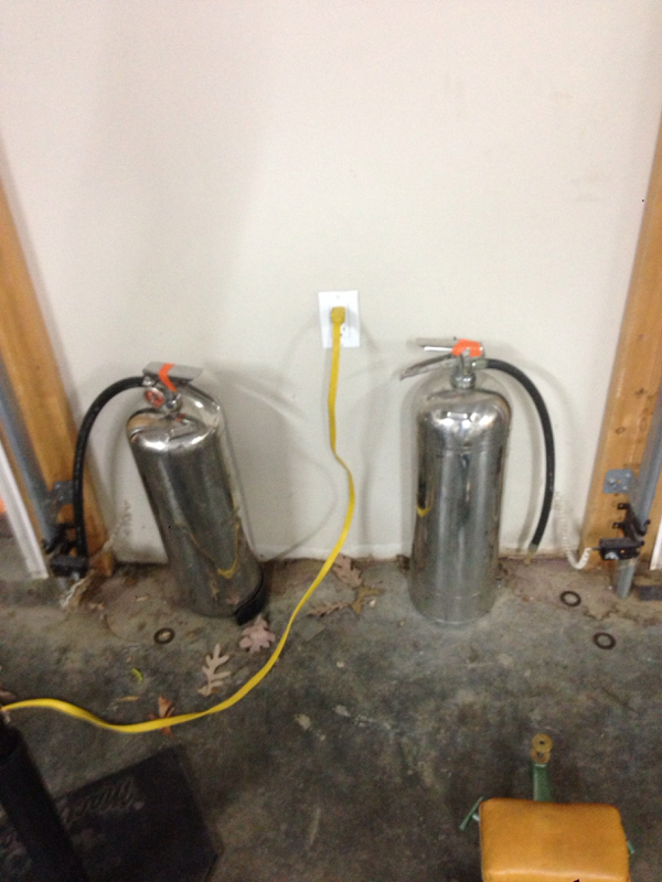

I carry a 5 pound dry chemical fire extinguisher in the truck. My favorite and most useful fire extinguisher are my 2.5 gallon user rechargeable fire extinguishers. I use them several times a year and they will put out a pretty big fire. I'm sure if you filled them with a real extinguishing agent they would work better, but water is free.
We use these all the time except we add a cup or so of AFFF after putting water in. The other homeowner way to at a bit more effectiveness would be to add some liquid soap.
The AFFF (foam) acts as a blanket over the fire and the soap lowers the surface tension of the water and allows it to flow a bit better and the suds stick adding a little of the foam blanket type effect.
Plus who doesn't like something that can be refilled at home?

I wonder, would that lower the freezing point to where they could be left filled over the winter?
