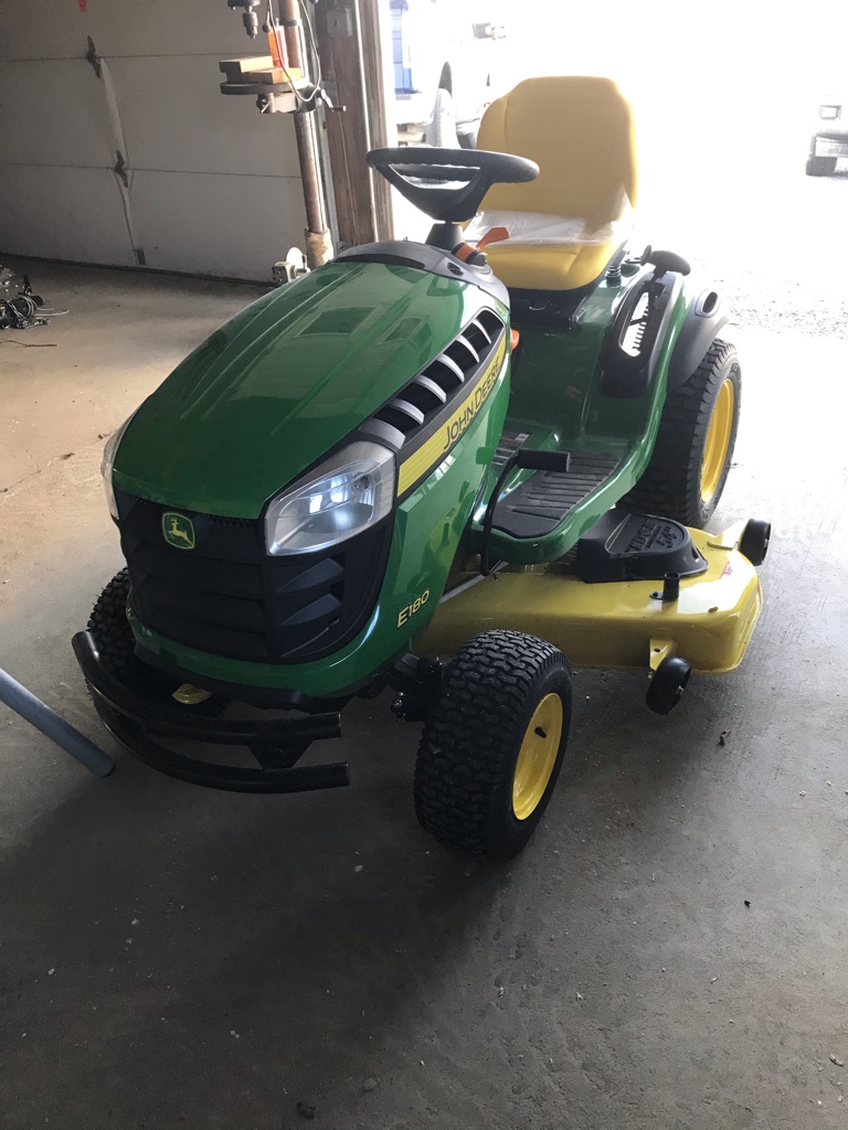

My Brother in law was mowing with our mower yesterday and came running to me screaming fire. I saw our purchased in April new John Deere mower engulfed in flames under a big maple tree.
I grabbed the shop fire extinguishers and tractor and pushed it away from the tree out in the clear. Both extinguishers empties, I buried the mower with dirt using the tractor.
Not sure what happened. He said he heard a pop from under the front and flames came up from underneath.
He wasn’t in high grass or leaves also and was moving so I don’t think it was a spark from exhaust on the ground that did it.
He’s safe. A little shook up. He has cystic fibrosis and that mower has been his way of getting outside in the sun a little.
I think it had 40 or so hours. I remember doing the 25 hour service in August.

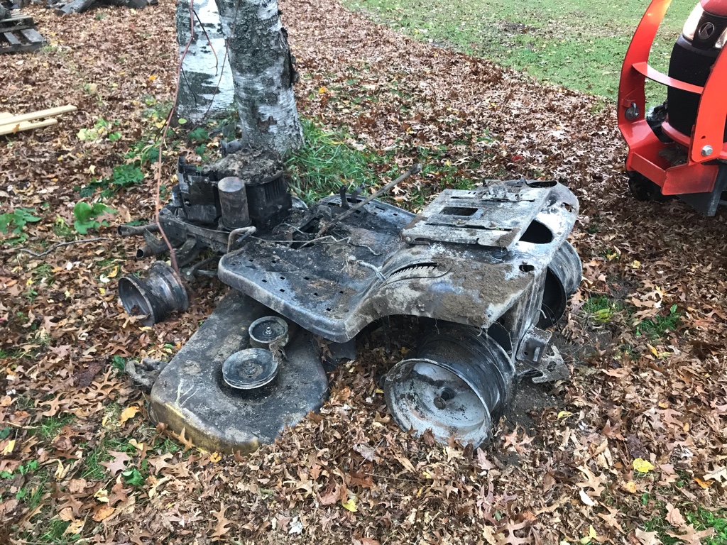

I dug it out and took a couple of pictures.
Home Depot told me to contact John Deere.
John Deere had a weekend call center answer it appears. Took my information and I got the “We’ll get back to you”.
Bought it 20Apr20 and had around 30-40 hrs. I had did the 25 hour service but hadn’t got to the 50 yet.
/ Fire on John Deere mower #5
Fuel line, fuel filter or connection or something dumped gasoline on that thing. That is about the only thing I can think of that would have caused such a catastrophic fire so quickly. Wow, talk about burned to the ground. Man there isn't a plastic or rubber piece left on that thing.

All it takes is a few of those leaves around the muffler, then they catch fire, fire melts fuel line, burning gas and a melting plastic hood to feed the flames, I’ve worked for Ford, Kubota, and Deere dealers through my working life, it happens more than you know! My neighbors kid was trying to mulch leaves with their Murray a couple of years ago, the same happened, burnt the mower and much of the woods at the edge of their yard.

There were some older JD models when the fuel pump failed (diaphragm) the "weep" hole sent gas right onto the muffler = fire.

If your E180 is similar to my D110 then there is an in-line fuel filter, which you would/may have replaced during the 25hr maintenance that you (OP) said that you performed. The connection (either side of the filter) may have come loose due to engine/operation vibration, spilling petrol onto a hot engine.
Typically you (meaning practically everyone :)) simply ensures that there's enough fuel in the tank, the tyres look inflated and, maybe, check the oil dipstick. Turn it on and then get on with the job. Rarely do you open the bonnet and check every 'hose' or connection unless it's a maintenance procedure.
Which is a timely reminder to us all to take a moment and perform an 'inspection'.
