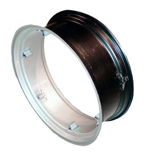

Agreed. I have something similar to this:
The one I have is 38" in diameter and has several spiral flutes on the inside (used for adjustable width, I believe). It's old, rusted beyond it's purpose in life, and absolutely perfect for a fire pit.
/ Fire Pit Metal Insert #10
I have seen people looking for 38" rims and spending a lot of time patching holes in ones like you describe. The power adjust rims in 38" bring a pretty penny for most of the tractors I know of. Sell it and find a truck rim would be my suggestion.

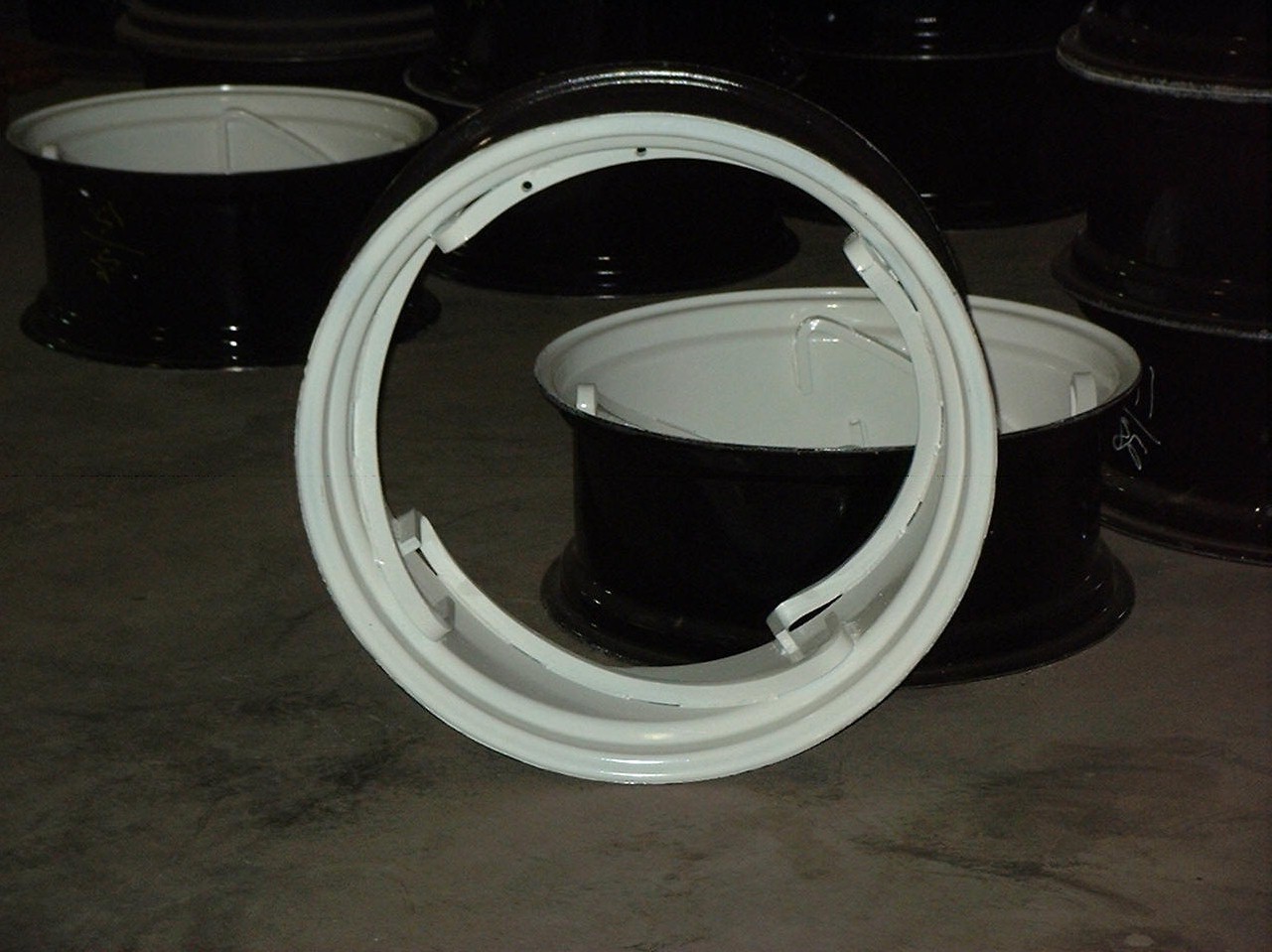

A few more minutes worth of searching yields the proper name for my pit ring... a "spinout" wheel, like this:
