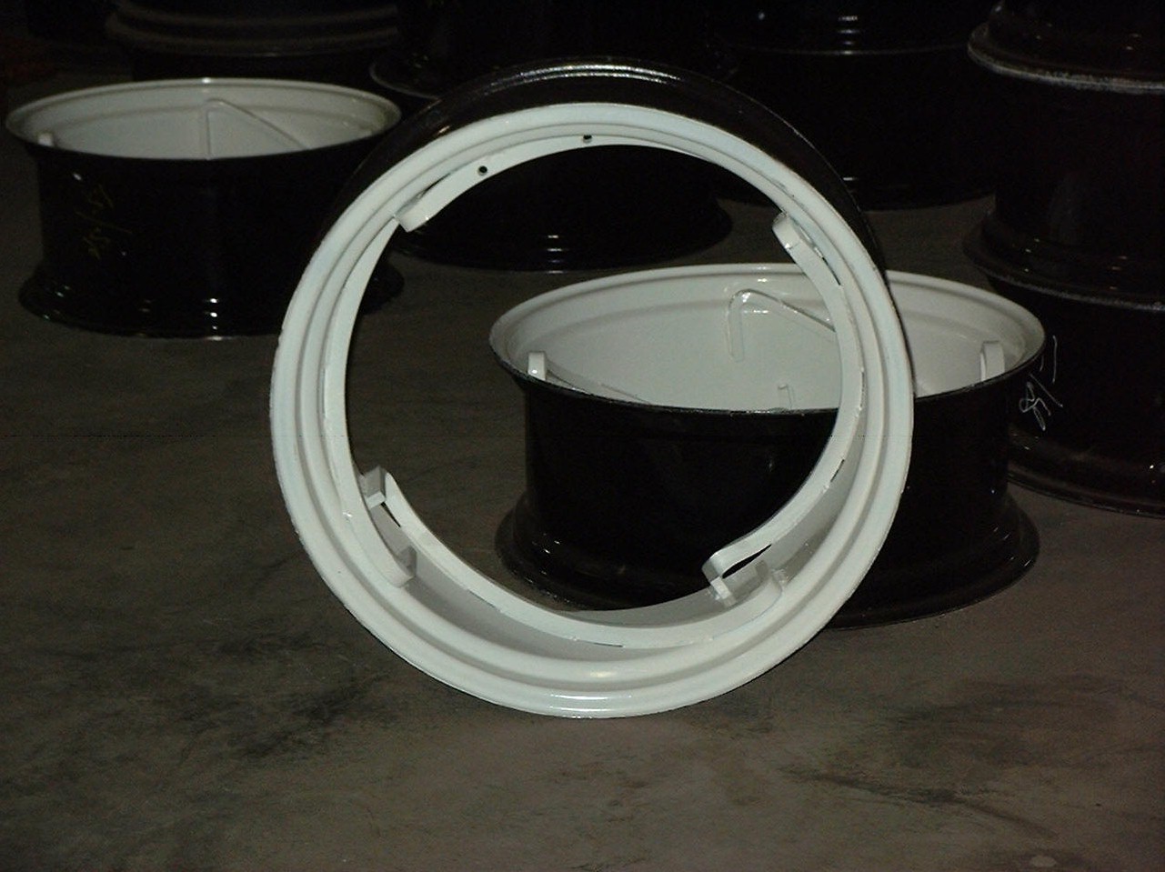

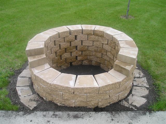

Tractor rim with the center cut out, used here too. Then added the retaining wall block around it with gravel/sand mix in between the rim and the block. The block barely even gets warm to the touch. Nice when little ones are around;)

Problem with a fire in a hole is you have to use so much more wood and make the fire huge because the ring blocks all the heat. Its like watching a fire on TV you can't feel the radiant heat from the coals. A fire ring blocks the heat until the ring gets red hot, and thats a long, HOT fire. You're inclined to build a much bigger fire cuz probably 75% of the heat is blocked.
You can tell I don't like fire rings, especially one that has rock blocking even the radiant heat. You did a fantastic job and it's good to have the little ones around the fire, those are good times! I do appreciate the increased fire-safety folks are willing to enforce by design, but the fire has to be so much bigger I'm not convinced its actually safer.
Sorry JL, don't want to rain on your nice job (I like the classical rock campfire). You did a fantastic job and it's good to have the little ones around the fire, those are good times.

That is a nice pit,
but I would have put the rim, deeper, maybe 4 or 5 inches above ground,
and put your stone about 2 to 3 feet away from the rim.
That way, you get the heat and you still have the stone wall protection,
of course, anytime you make a fire like this, it's alway's good to keep a pail of water near.
I do like the way you did your stone work.:thumbsup:
