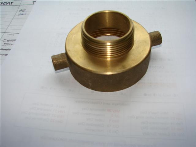

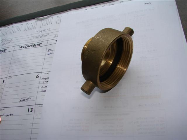

If you're looking for a fitting like this one I will give it to you if you pay the $9 priority mail shipping. I paid about $20 for it last year but we wound up changing the valve to a different size and never used it. I think it is a 2 1/2" NST(F) x 1 1/2" NST(M) Reducer but I don't remember for sure and I don't know how to tell what kind of thread it is.
